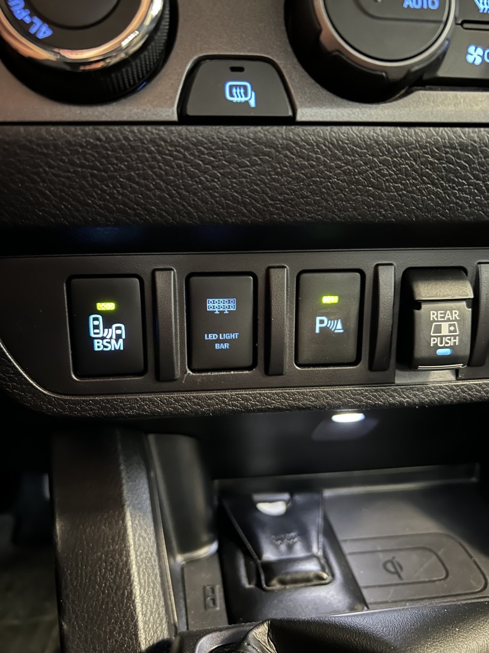

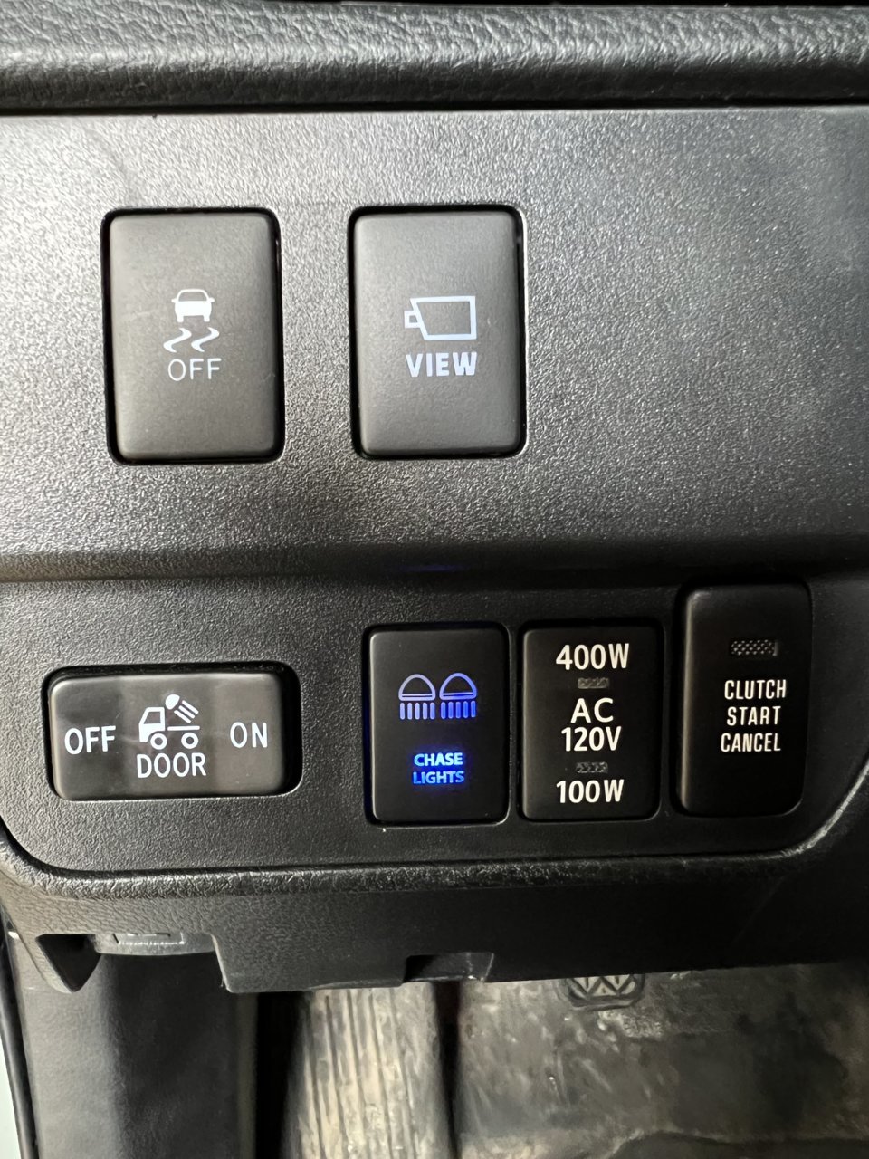

    Swapped out my CH4x4 push style switches for AOB switches. The LED backlighting is much closer to stock. Since I drive with the DRLs on almost always the mis-matched blue was really getting to my neurotic tendencies. Even though I prefer the etching/symbols on the CH4x4 switches better I think I will be more satisfied with the new switches.
    Before:
    After:
    If anyone is looking for switches I have a few spare ones to get rid of now :notsure:

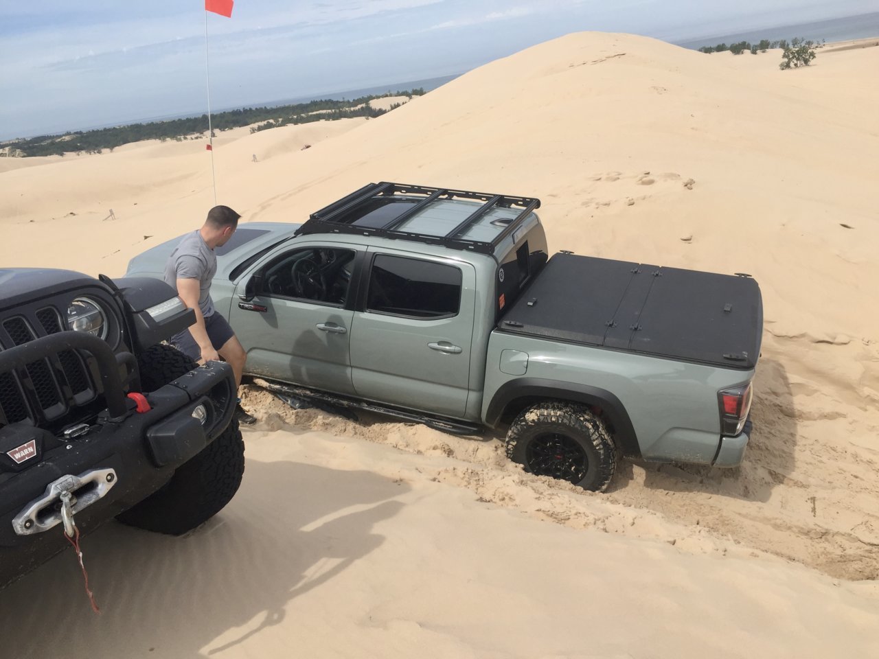

    6/13/22 - Silver Lake Dunes
    Probably my favorite trip to date. If you’re in the area I would highly suggest you make a visit. Spent the day with a coworker and his JL Rubicon. The truck performed well beyond getting stuck at the peak of a steep dune, either way only good things to report.

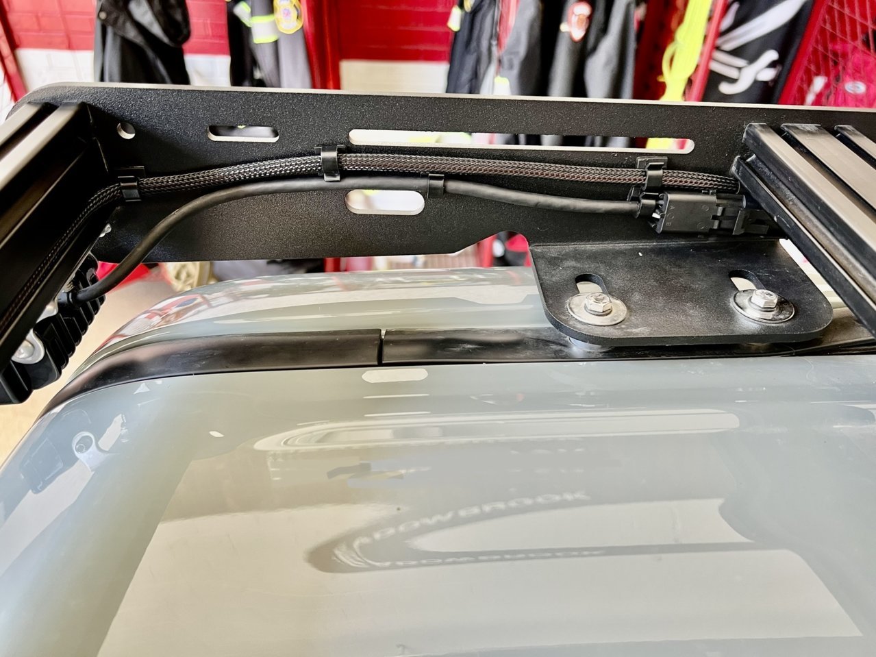

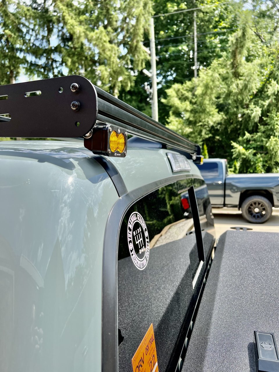

    I’ve been waiting since March, but my Baja Designs S2 sports finally came in, so I wired those puppies up as chase lights:
    I decided not to use the supplied wiring harness and made my own. I attempted to keep everything tucked away and hidden within the roof rack, leaving the crossbars functionally open. Not the cleanest job but it’ll do.

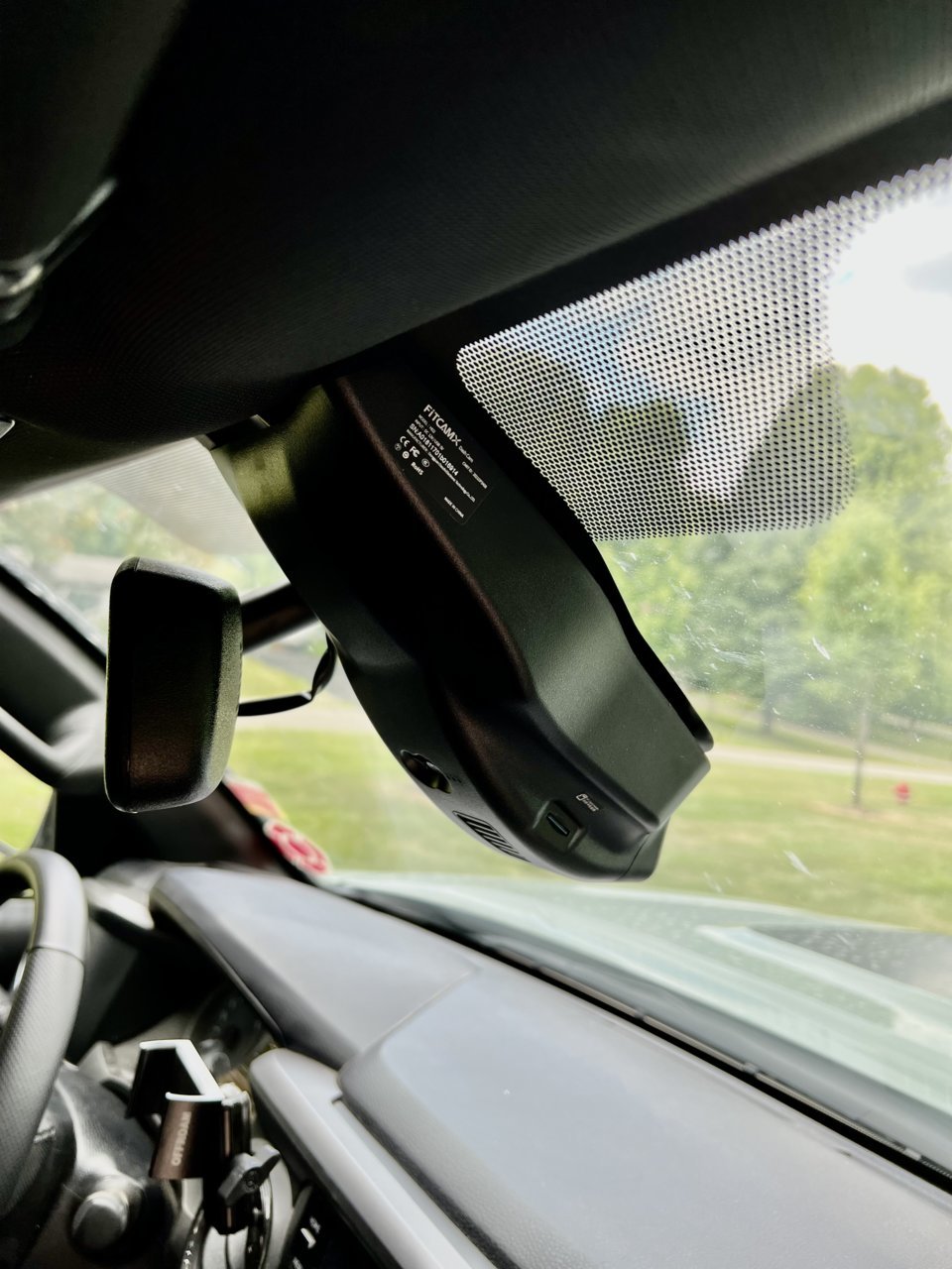

    Since my last posting I also had the truck tuned w/ the KDMAXX Pro+ tune, and installed a FITCAMX dash integrated dash cam:

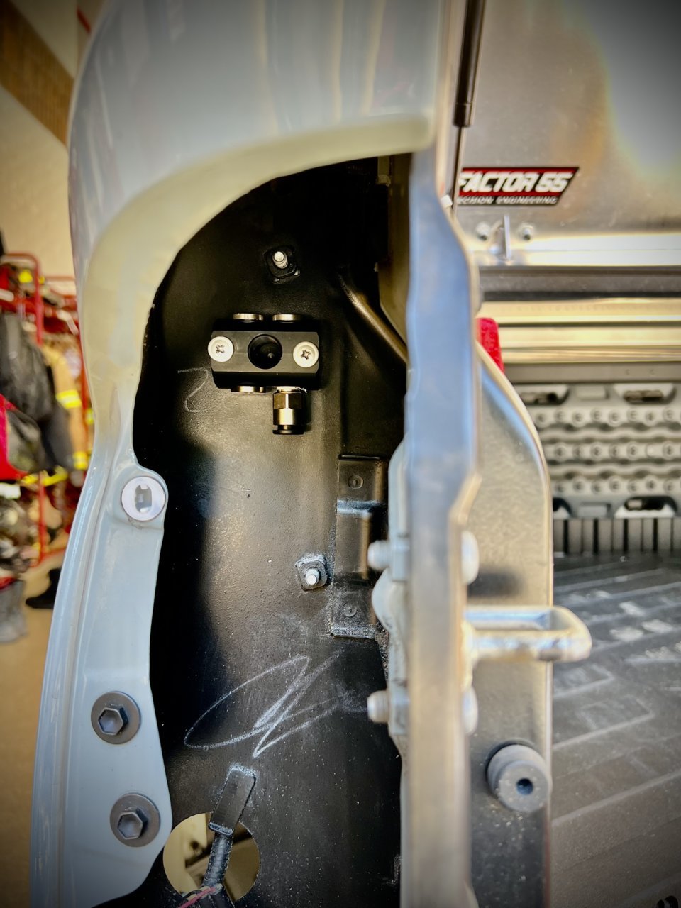

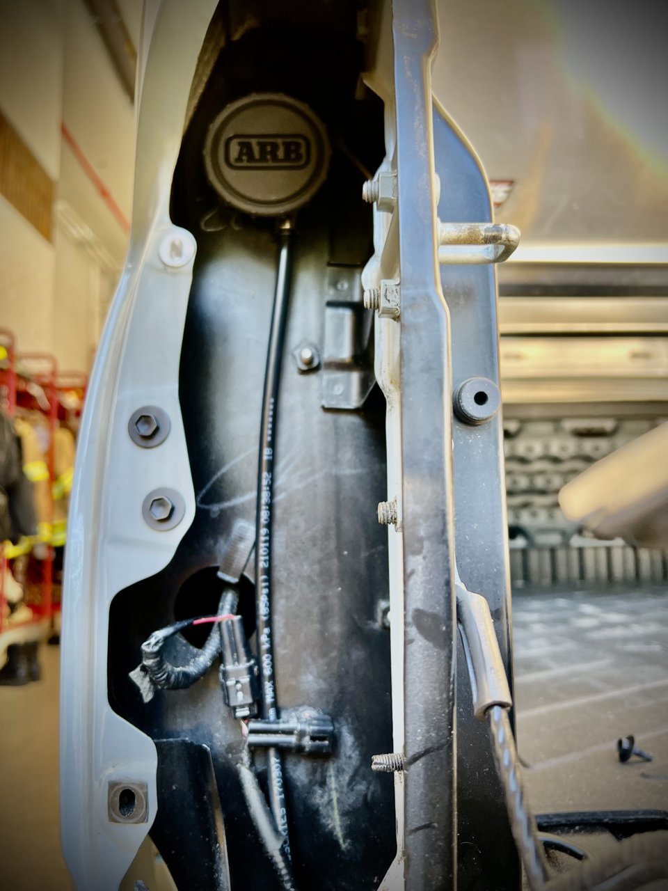

    Also installed the ARB rear diff breather kit in driver side taillight:

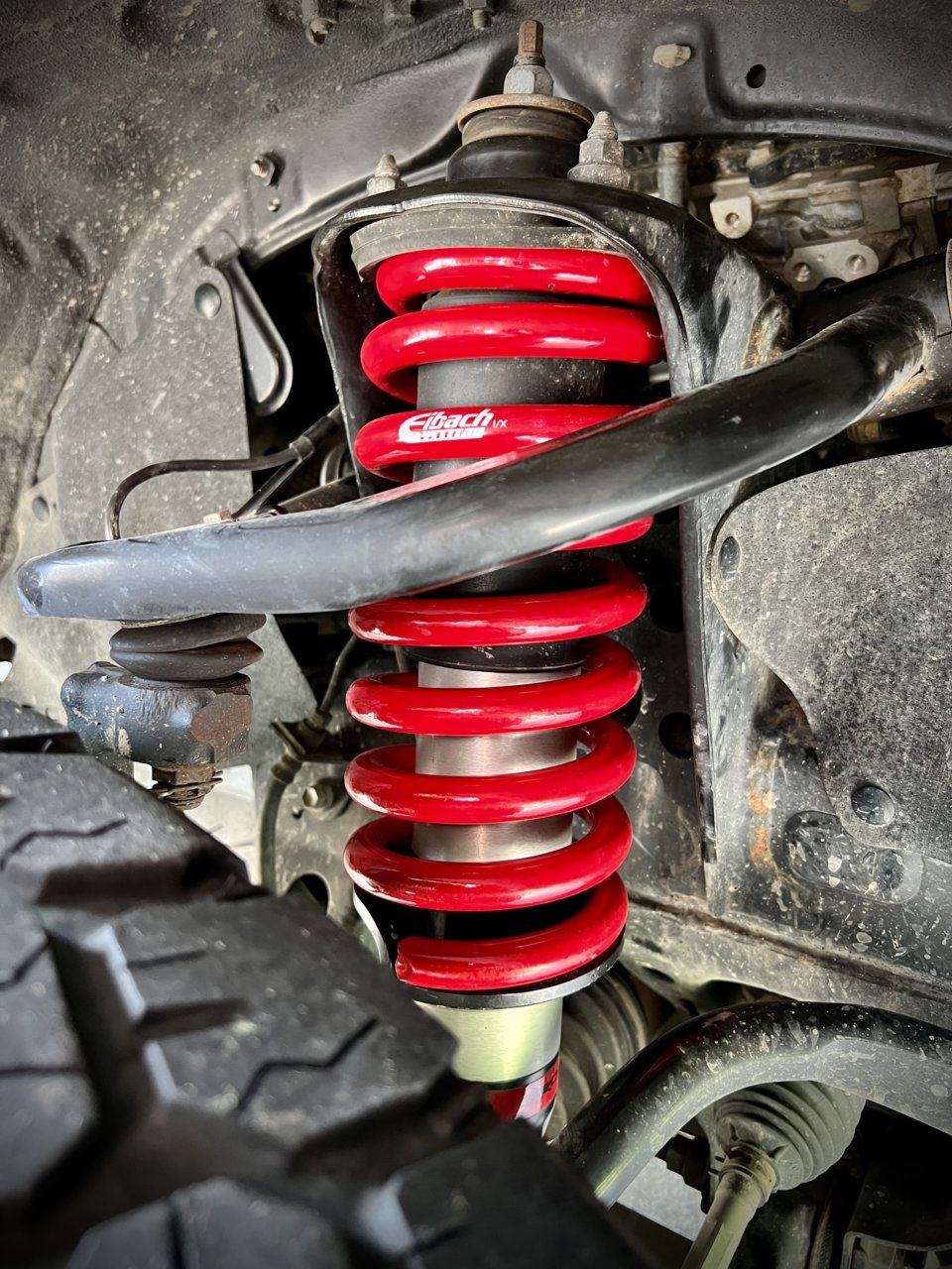

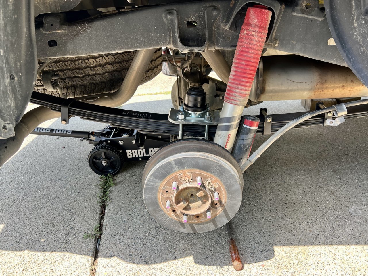

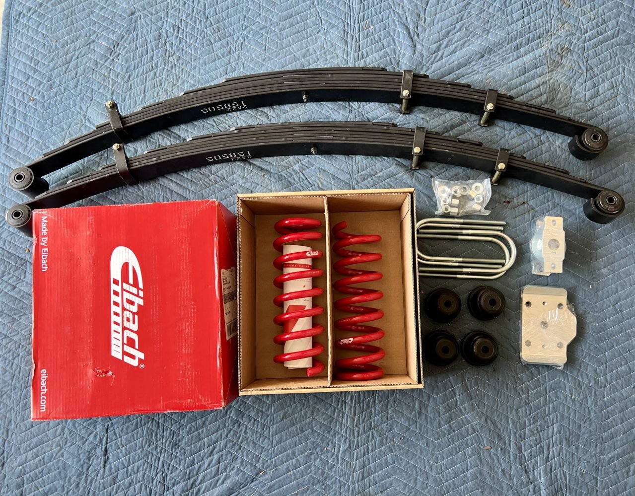

    I’ve gotten back on track with modding this summer… This build has continued and I have a few items to report.
    Firstly, after sitting in the garage for 4 months these goodies finally saw the light of day:

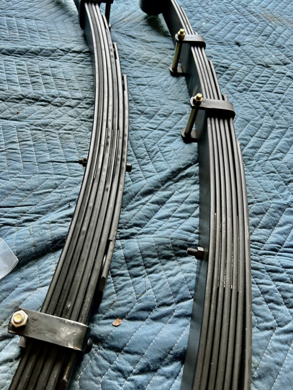

    Eibach TRD Pro upgraded springs, Icon RXT leaf packs, Wheeler’s super bumps/U-bolt flip kit.

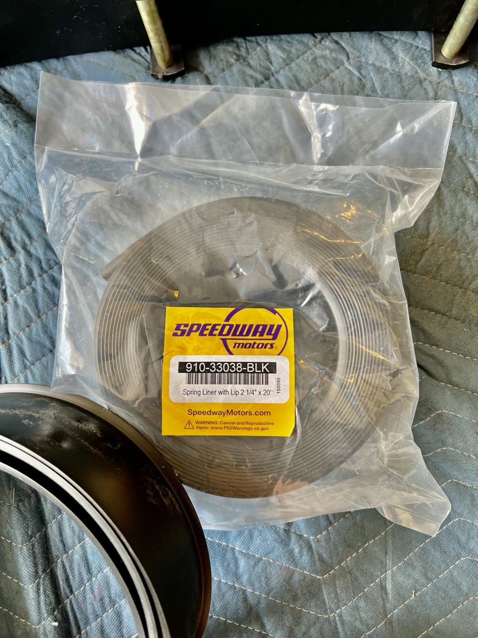

    Before installing the leaf pack, I found and gave these a shot:
    My hope is that this prevents the normal creeks that develop, or at least extends the length of time before they show up. Here is the leaf packs rebuilt with the liners installed:
    Install day went pretty smooth overall. Took about 4 hours total for a friend and I to install all the suspension components.
    I’m digging how the U-bolt flip cleans up the rear undercarriage.

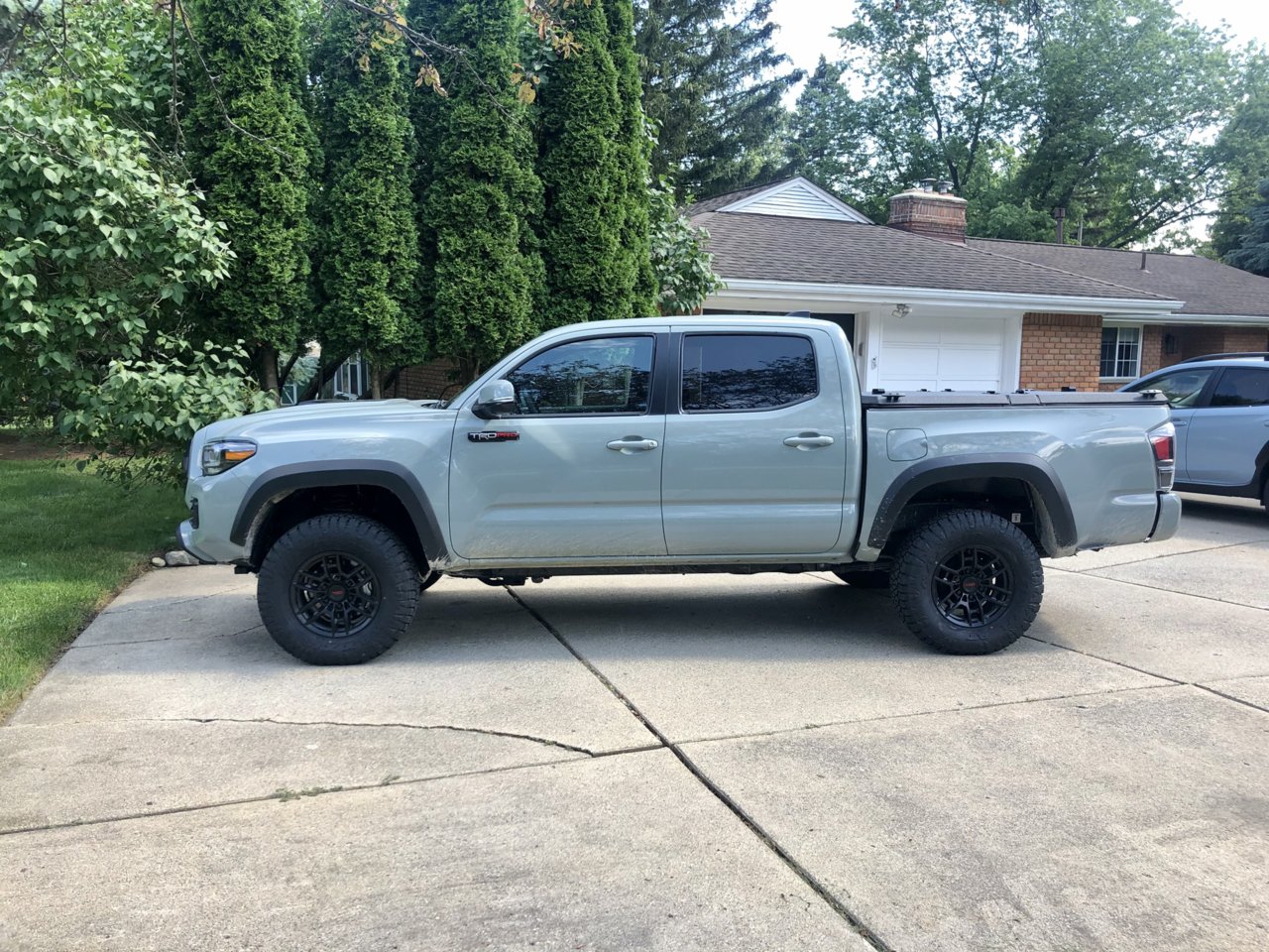

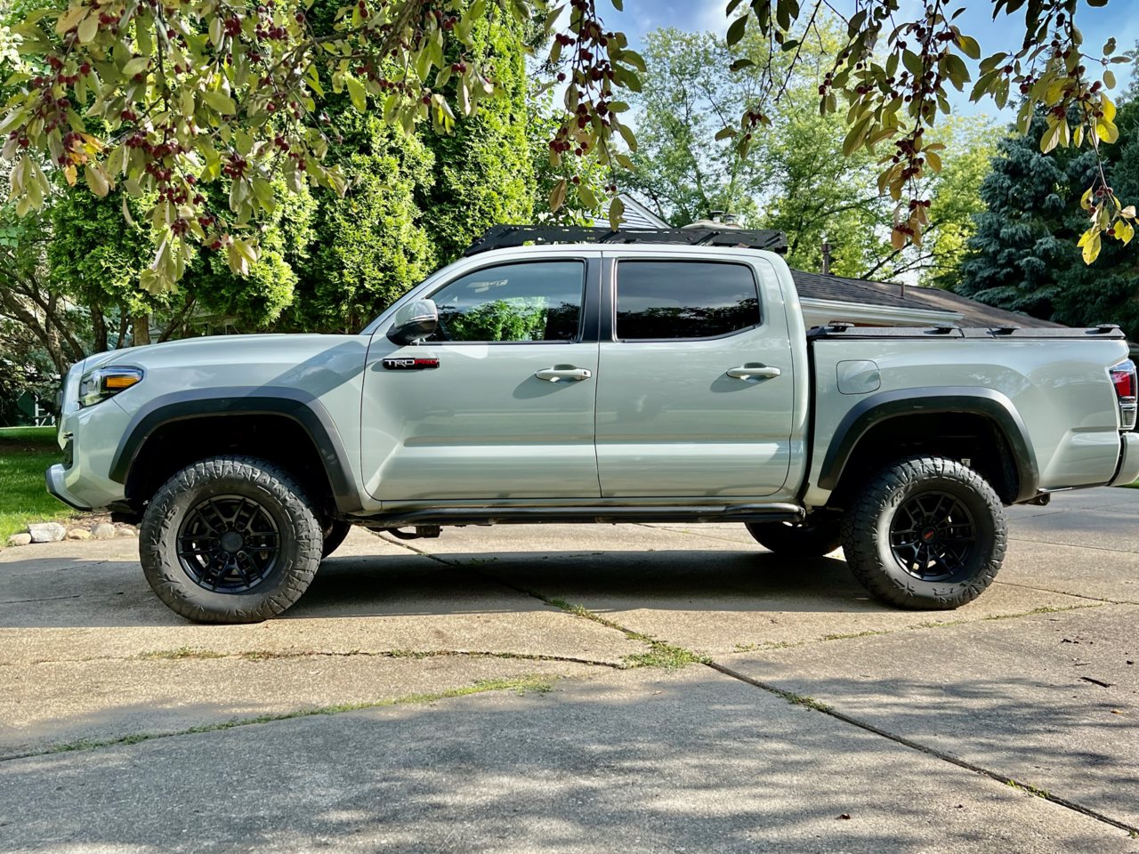

    I don’t have the great before/after pics but overall gained 1.5” in front and about 2” in the rear
    Before:
    After:
    The difference is subtle but noticeable. I feel like this is the stance that should have came from the factory. After several weeks I would report that I am overall happier with the lift. The ‘on road’ performance is excellent. The minor increase in stiffness has drastically reduced nose dive, and out of all things has actually made my shifts feel cleaner due to the reduced body roll, etc. I will say I that the stiffness has taken the edge out of the soft, floaty feel that I used to get on rough roads/speed bumps but it’s not harsh enough for me regret the change.

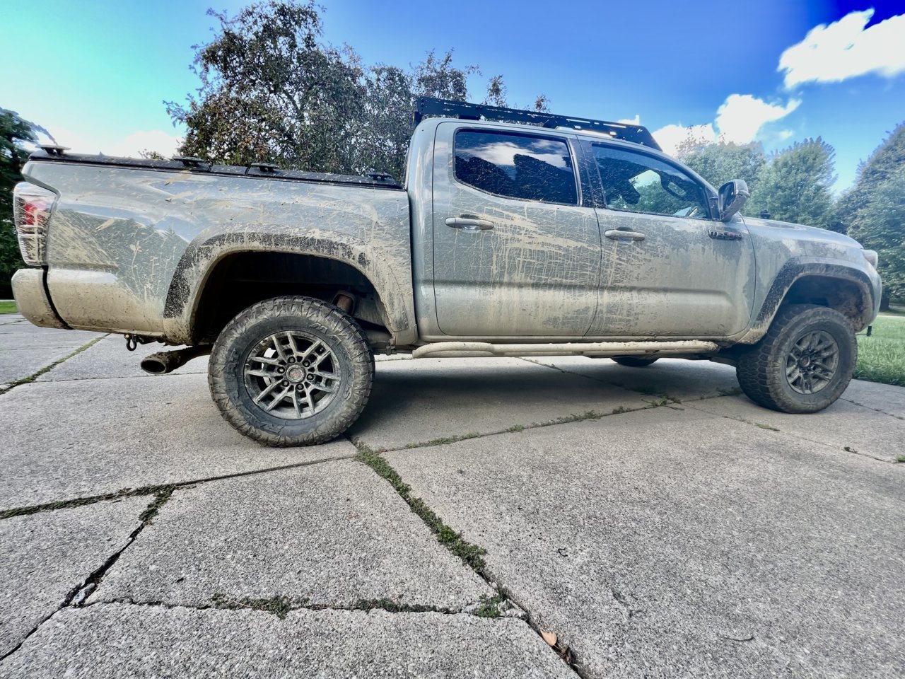

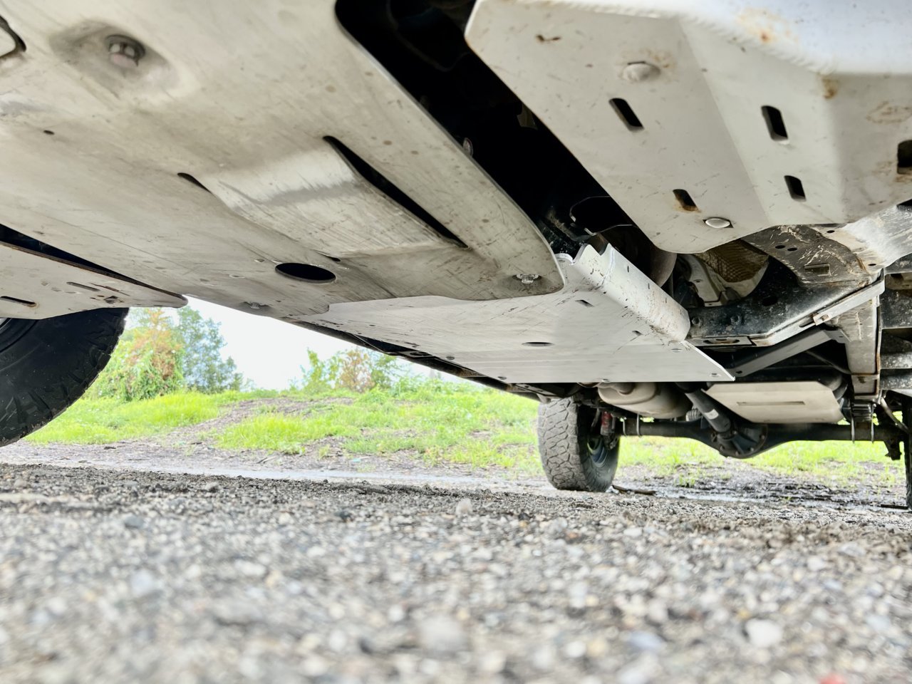

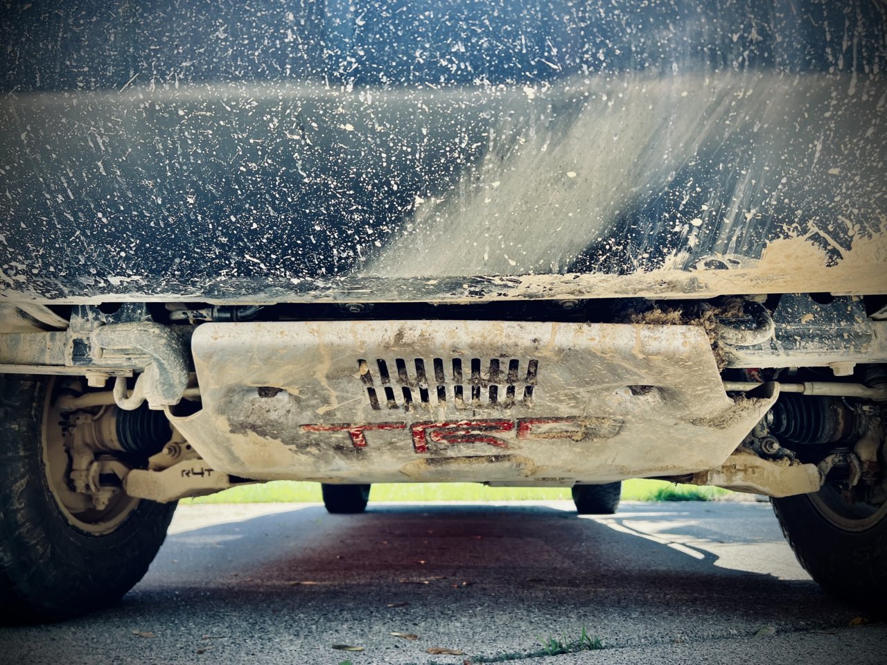

    Also dropped some moolah at RCI to complete my underbody protection; trans and t-case skids added in raw aluminum. Installed just in time for some shenanigans at Holly Oaks ORV with some Canadian brethren:

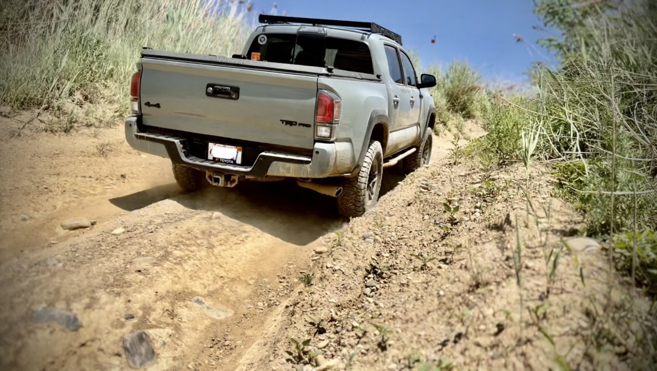

    That trip turned into a pseudo-shakedown run of the new suspension components in preparation for a bigger trip this fall.
    Conclusion of suspension updates off road: :thumbsup::thumbsup:
    The added stiffness was bearable (gotta remember this is a daily driver primarily) and the added ground clearance made easy work of some familiar trails. 33s will be coming when my current tires wear down enough.

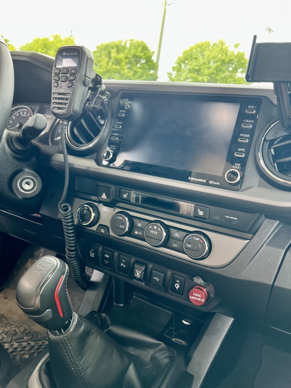

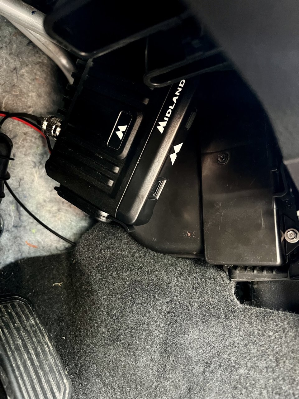

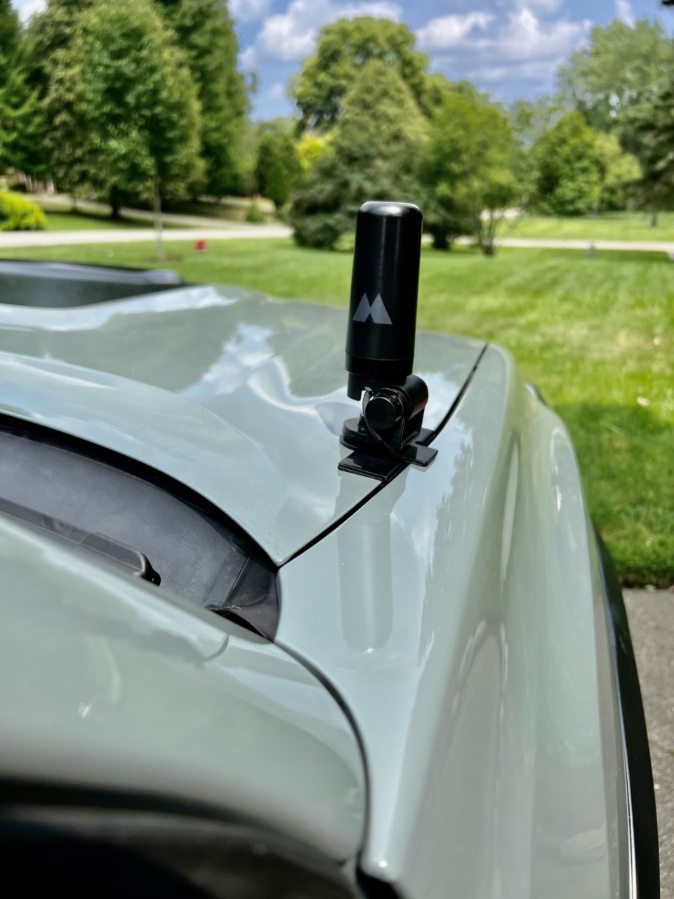

    GMRS installed. Midland MXT275 hardwired to the aux fuse panel. I tucked the unit as far up under the dash as I could, and the mic mount is a removable vent mount from Tackform so I can keep the interior somewhat stock looking overall when the radio is not in use.
    I used a Midland 3DB Ghost antenna mounted on the hood for now, I’ll see how annoying I find it and might move it up to the roof rack. Antenna wire ran through passenger side firewall grommet.

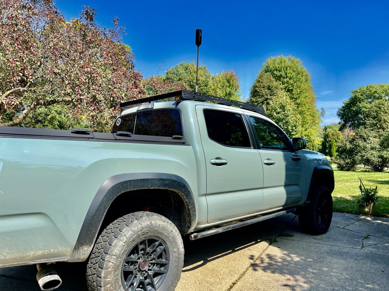

    I have a wheeling trip coming up in about a week and was able to sneak in a couple more upgrades before I head out.
    Firstly, I added some sound deadening to the core shifter and center counsel area. The extra noise from cruising in 5th/6th was something I’ve been planning on taking care for a while. This was a must before heading out on a long trip again.
    I just wrapped some Dynamat to the shifter itself and then blanketed it with some sound deadening foam. Seems to have make a little improvement so far.

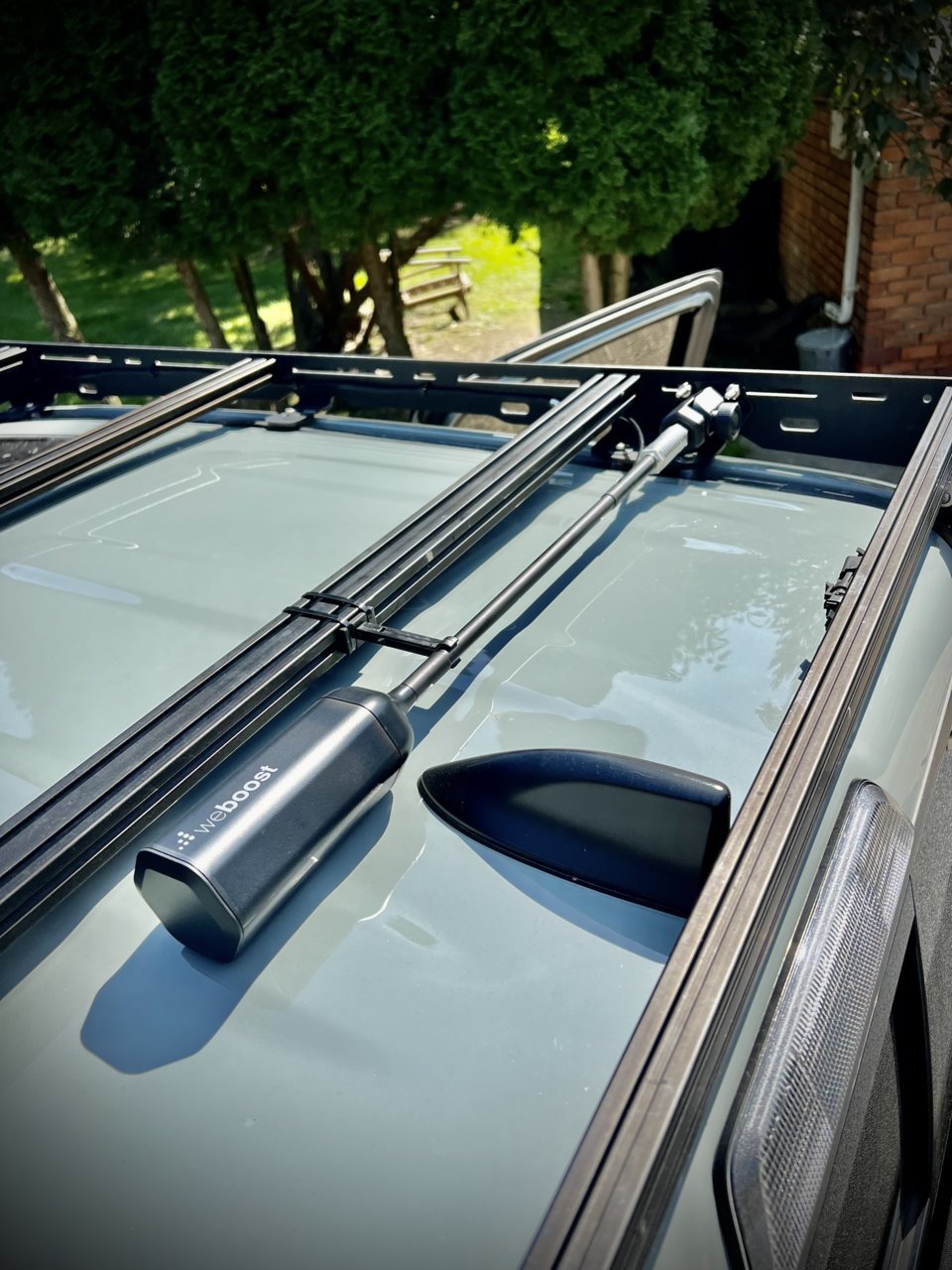

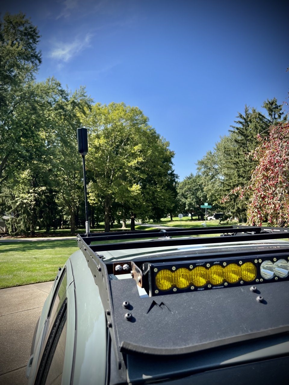

    Weboost kit set up for the trip as well:
    The antenna folds well enough to fit inside the roof rack when not in use, and the mounting points are low profile enough for my liking:
    I do have the hardwire kit, and will integrate that with a switch in the cab in the future. For now I’m temporarily using the 12v outlet plug to see if there are any other tweaks needed to the set up before I make things more permanent.
