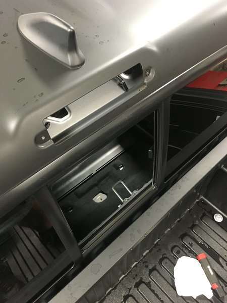

    A buddy picked up a dealer-modded TRD Sport that has the roof wrapped matte black.

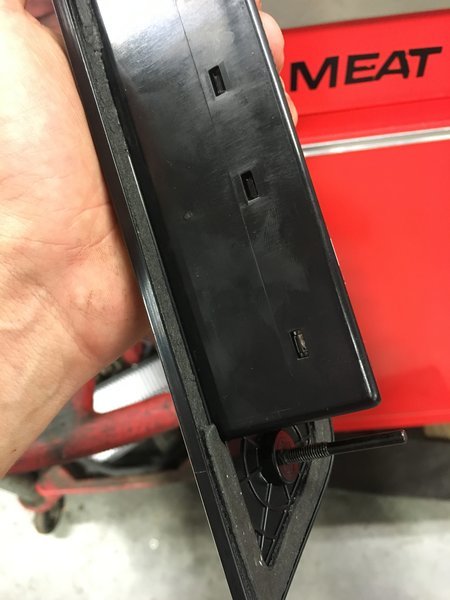

    Upon taking delivery in a thunderstorm, his wife felt water dripping on her in the back seat. They left the truck for me to sort out today. Turns out the center brake/cargo lamp seal does not like being re-used.
    $155 for a new light assembly, plus a few hours labor for swapping out the rear seats and cleaning up a bit of water. I have a feeling this is the last time that shop makes this mistake.
    For anyone planning on getting their roof done, make sure they do a good job re-sealing the brake lamp. They come with a foam tape pre-installed. I'm sure I could seal it with some silicone, but that's just not right.
    The hammer and sorgon82 like this.

    I have an SR5 with the standard brake lamp, which i believe has a rubber gasket instead of the foam. They also mount from the outside, not from within the headliner like the clear light does.
    They also don't appear to be interchangeable.

    For $155, I would have just bought some foam tape or rubber gasket material and replaced just that for about 10 bucks. Thanks for the heads up, though!

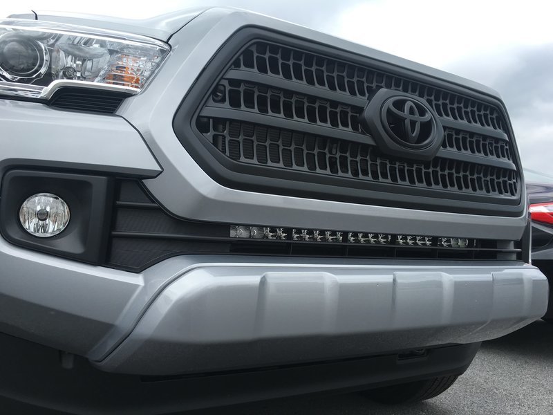

    It also has a lightbar in the lower grill. $650 option offered through here.
    I instantly assumed the Rigid mounts with eBay/Amazon lightbar. Nope. No-name eBay bar with the most heinous mounting job I've ever seen. I'm ashamed of it, and I had nothing to do with it.

    Are y'all going to take the junk light bar and mount out and do it right? I think it's a good option to offer, but on a new truck it should be atleast quality mounts and a half assed decent bar.

    Do you have pics of the light bar set up?

    I'm going to speak with the sales managers about offering a lightbar in-house, done properly with a decent looking switch and wired correctly.
    i'll try to snag a decent picture of it once i get to work. its basically just a "stealth install" 30 inch bar in the lower grill similar to what everyone seems to be doing.

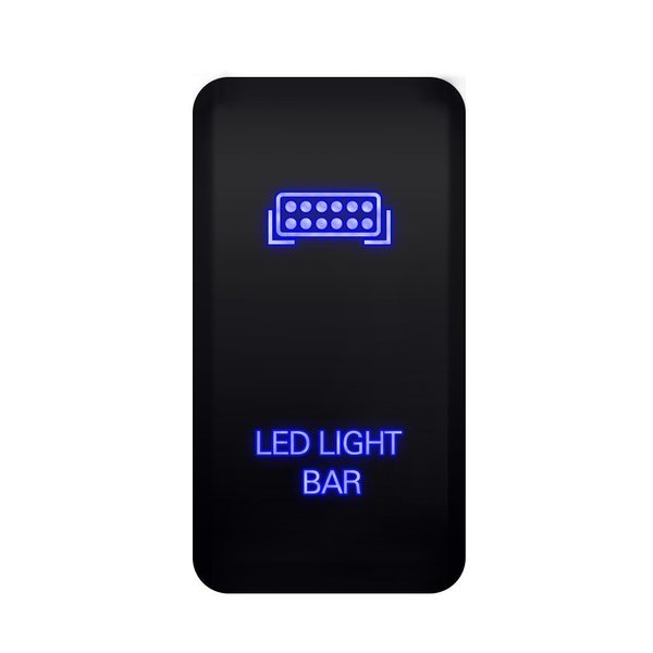

    the worst part about the switch install is that the shop drilled a hole into the trim piece with the switch blanks in it, instead of drilling out a $2 switch blank.

    Yeah that's what the dealer up here that I bought my truck does, not for me. For my lights I like OEM style switches, so I just knock out the blanks and install a switch that keeps it looking factory

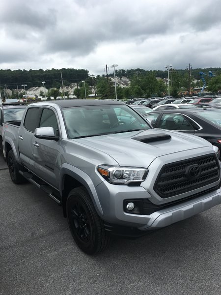

    Here's how the truck ended up. (Not mine)

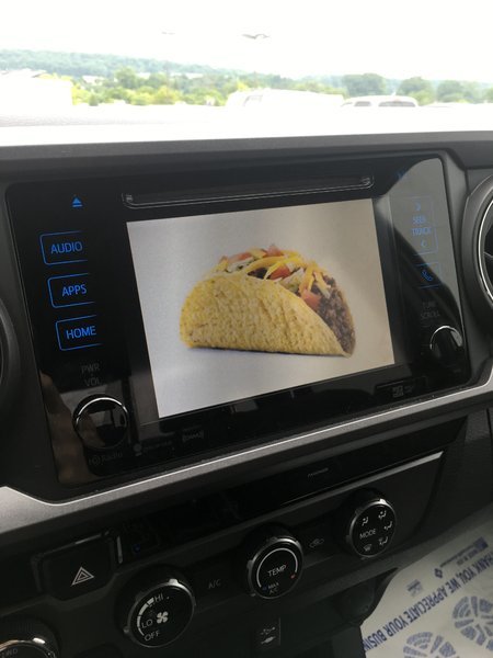

    I also gave the owner a special gift from me...New radio loading screen.
