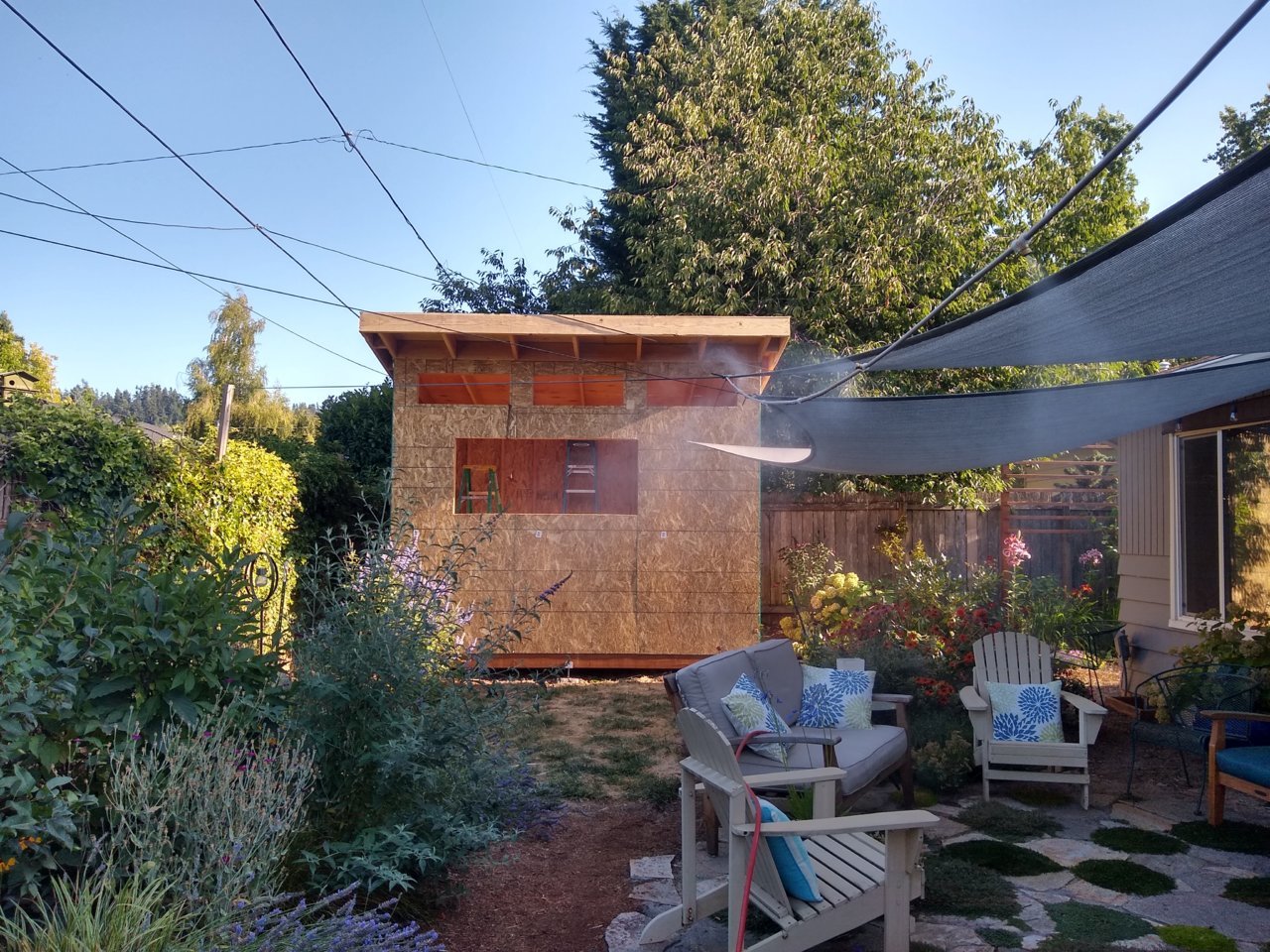

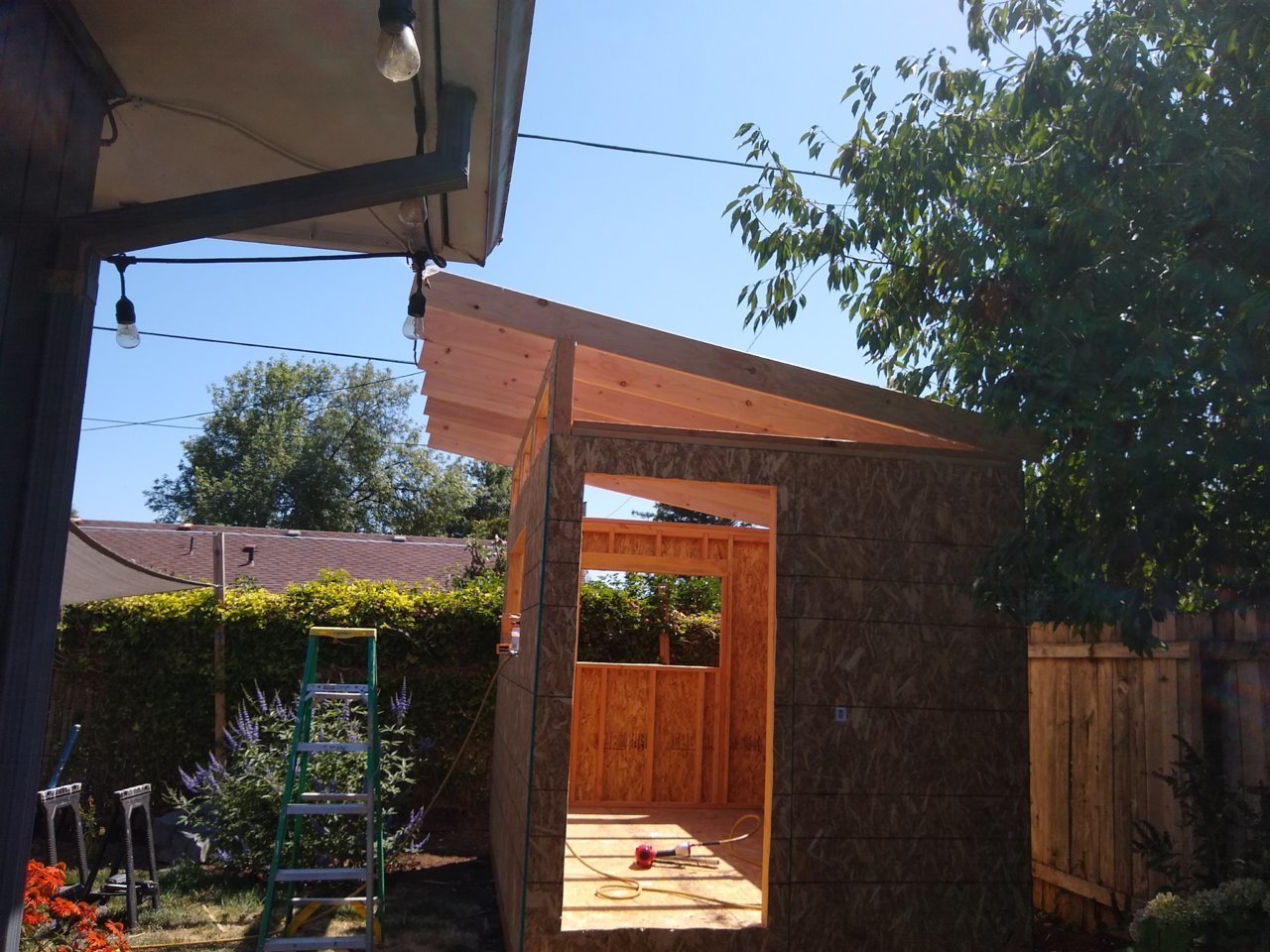

    We are building a shed in the back yard. It's going to rain Saturday so want to get drip edges (seems like when I helped with roofs back in the day we called it flashing?) and tar paper down before that happens. Trying to wrap my head around all of the flashings/edges/synthetic underlayment etc. things. Here's a pic or two for reference:
    It was 90+ in the bottom pic, way too hot for us Eugenians! Had a set of misters zip tied to the sun shade thing.

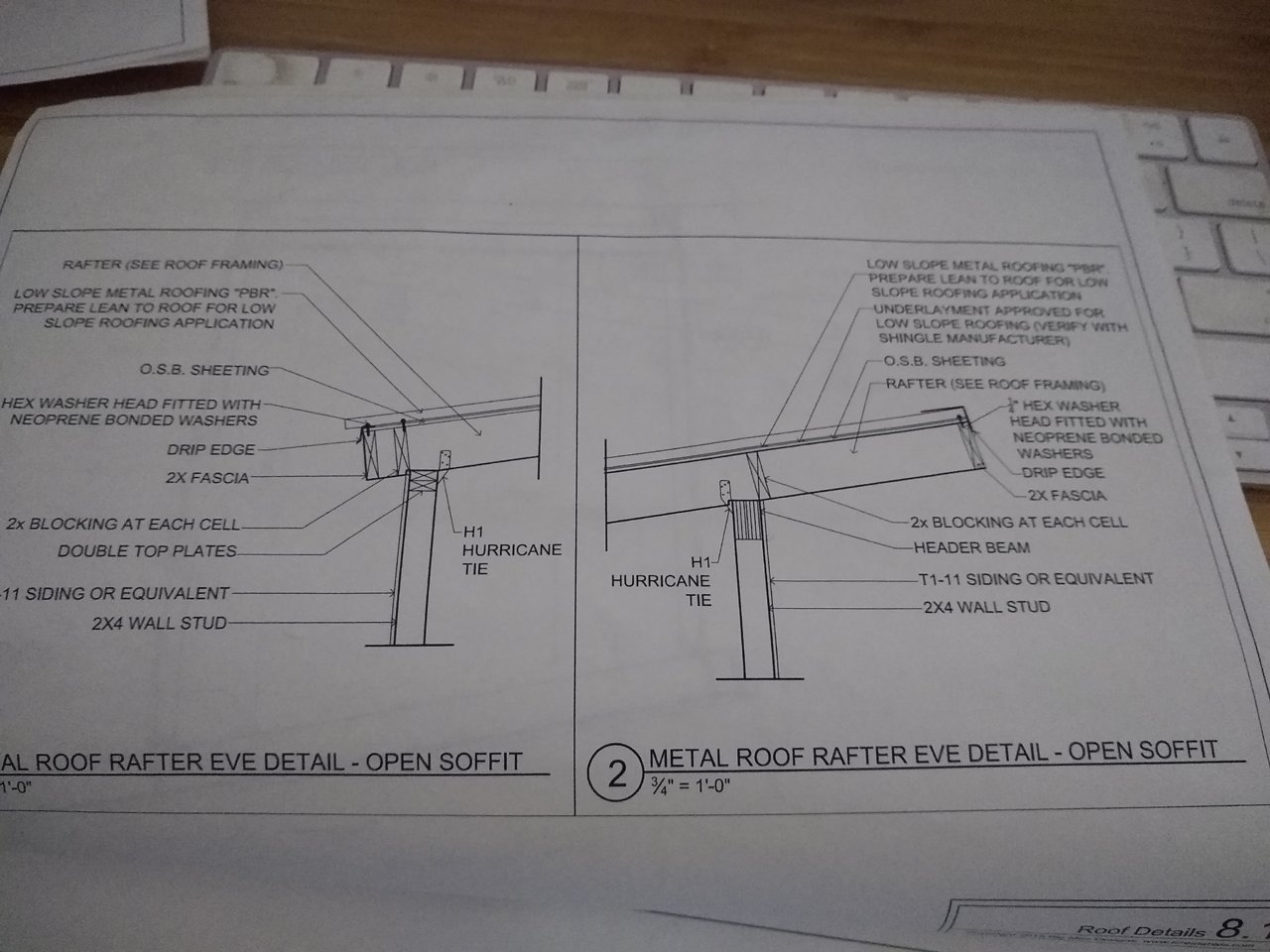

    Do I put that on all 4 sides? How do I cover the metal roofing with something like that? Looking at the plans it sort of appears like the flashing on the top part of the roof lays/lies(?) over the top of the metal roofing sheets:
    That doesn't look super waterproof to me but I'm not a roofer.

    Your plan calls for low slope roofing , is that what you are going to roof with ?
    Whats the roof pitch ?
