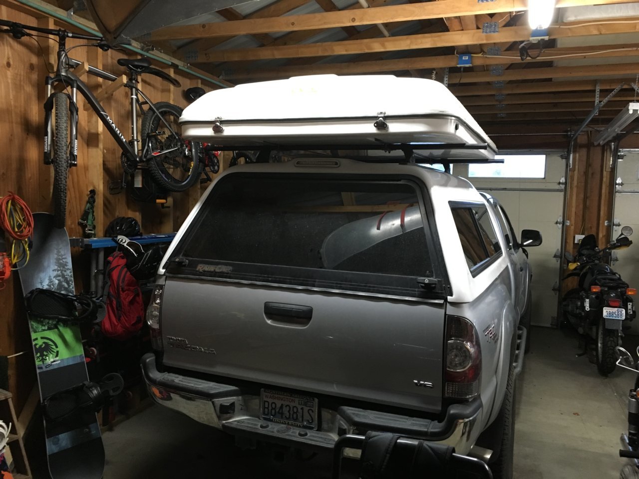

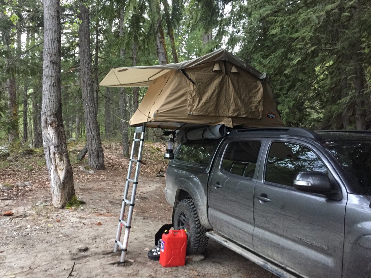

    If you can, run a third bar in the middle to spread the load out a bit(it’s not in the pictures, I have an extra set of bars for other roof stuff and just use one in the middle for the tent). And avoid jumps.

    If the leer cap is only rated for 200lbs, assuming that means driving and bouncing down the road, not just a static load, then no roof rack will help. It will just add more weight. One of the contractors racks that go around the cap would be better and take all the load off. Also, seriously consider bed stiffeners to keep the bedsides from warping out under the extra load
