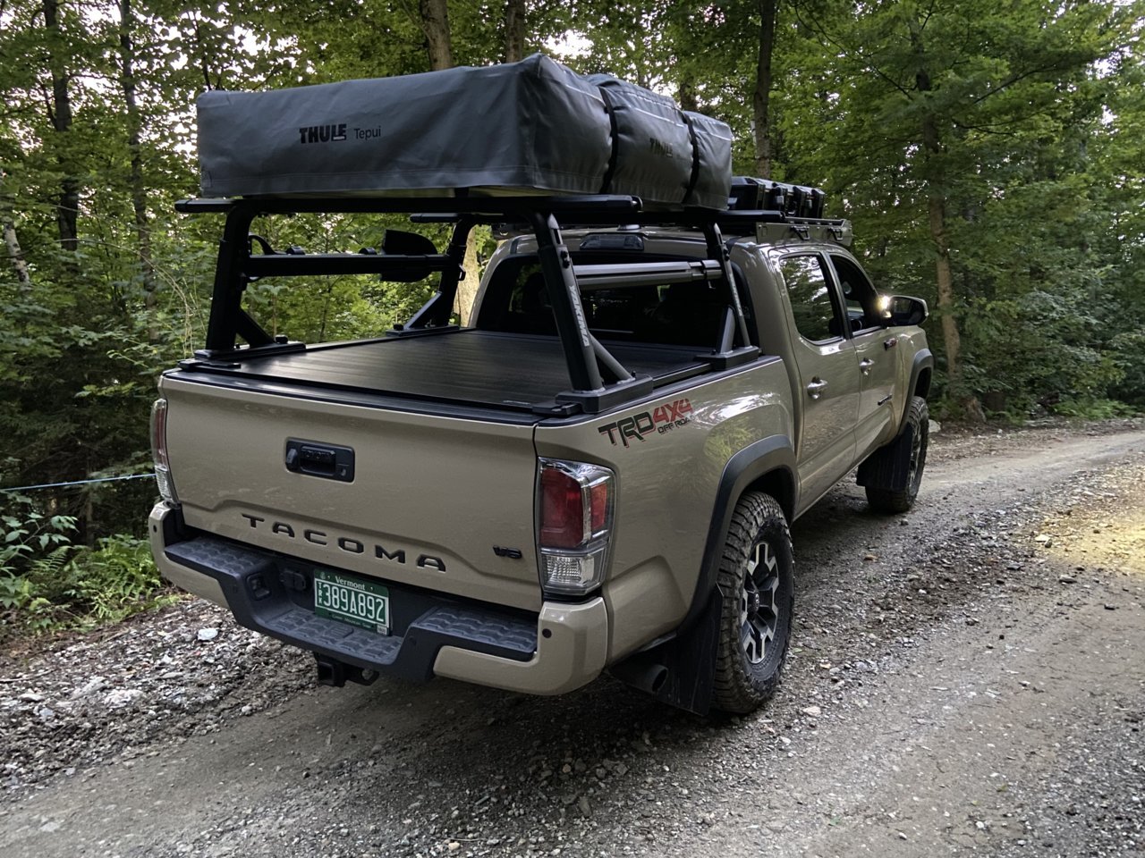

    Haven’t put a tent up there yet (we have a Tepui Lightning), but these guys no problem….

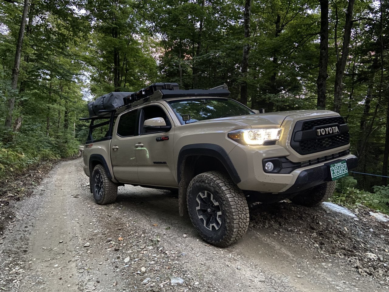

    Seems to do the trick for me! I’m not a hardcore off-roader by any means but the occasional class 4 road or impromptu jeep trail hasn’t seemed to bother mine whatsoever.
