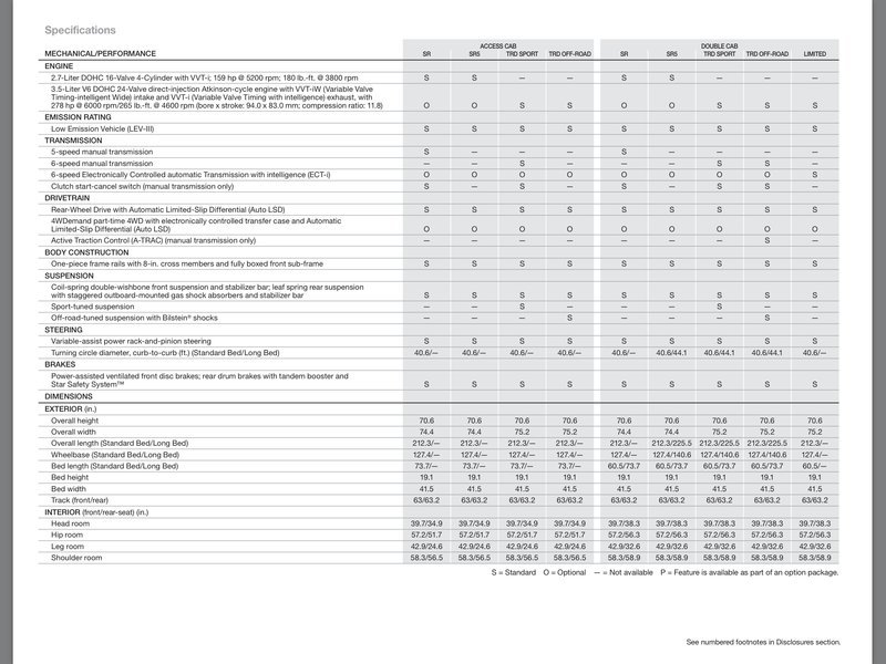

    I think the dealer mispoke definately looks like stock bilsteins on your truck, and just FYI the Sport and Offroad sit at the same height stock.
    You can fit 265/75r16s on your truck but your options will be limited to E rated, though I think theres a few that arent now (nitto and falken). Since you thought you had 5100's you could add those to get another 1-2.5'' of lift, I would advise against going with spacers as you mentioned. I would also say spend some more time here maybe in the suspension section, there are SO MANY options from $200 to thousands of dollars to lift your truck. I would also consider why you want to lift it and do you really need it. It will come with excess wear on drivetrain and components along with potential issues, but if thats something you willing to sacrifice for say just the look then go for it. But a set of good tires and some gear will get you almost anywhere that a lifted truck would.

    These dudes are trying to help you out. Don't be upset because the dealership gave you wrong information. Your truck is not on 5100s, plain as that. The OR and S are the at the same factory height. That's it.
