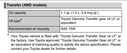

    Toyota LF 75w transfer case oil is proprietary (expensive!) and has snake-oil ingredients for keeping some of the internal parts from corroding. Kinda like the WS auto trans fluid scenario. Probably not needed but if you have issues before your 60k warranty’s up and you aren’t running it...
    Royal Purple claims to have an equivalent, IDK if it really is.

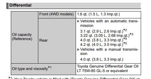

    If it makes you feel any better, unless you’ve been fording deep water or driving in 4wd a substantial portion of your 30k, it’s a waste to change in the short interval. I checked mine (loosened the drain bolt and let it drip a couple times onto a paper towel and it was perfectly clear, so I immediately closed it back up. Most TW threads also claim their Tcase fluid looks new @ 30k change.
    The diffs are spinning all the time and a different story. Wish I had changed those earlier. Here’s a relevant thread on the Tcase fluid for whatever it’s worth...
    https://www.tacomaworld.com/threads/transfer-case-service-on-the-2016.497574/

    I changed the rear diff (with Mobil1 75W-90) and it was nasty. I’ll do the front diff soon for good measure. Maybe I’ll hold off on the TC.

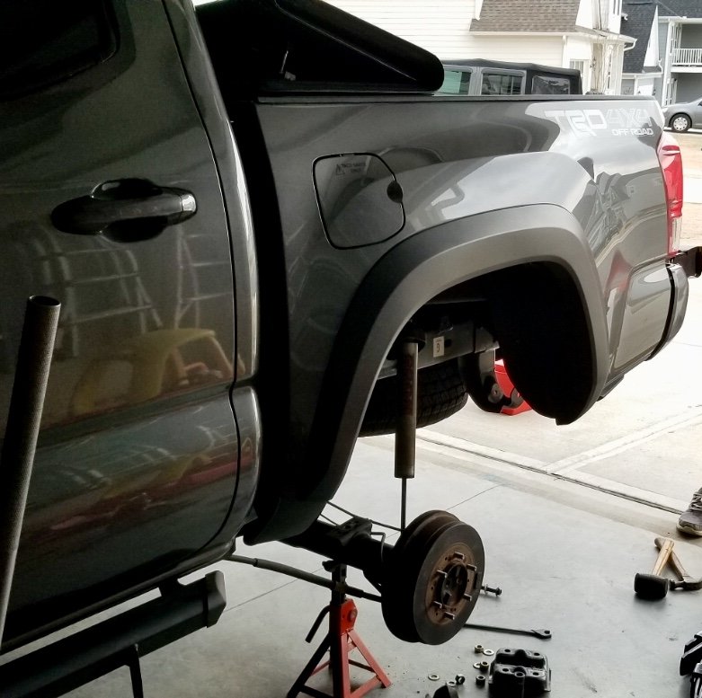

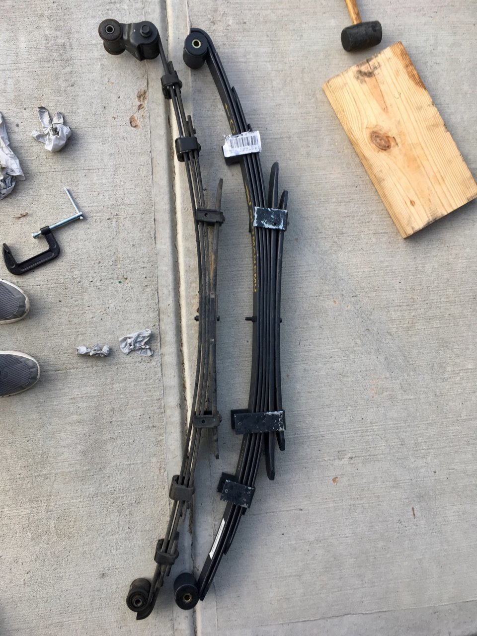

    First time installing OME leaf packs... all thanks to @CowboyTaco offering up some help! Thanks bro!!!
    The ride quality back home was noticeably improved over those blocks.

    Just went back and looked at OP. I didn't realize rotating tires was on the list. We should have done that since we already had the two rear off and the front tires were off the ground.
