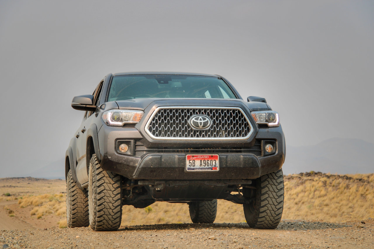

    I did Bilstein 5100s up front on the 4th notch leveled it out nicely and am running 265/75r16 if you want to go larger than a skinny 33 inch tire you are gonna need to do the CMC (cab mount chop).

    Looks good. Is 4th the highest or do they go to 5? How does it ride? I want to get rid of the bound of the OE Sport shocks but don't want it to ride like a rickshaw either.

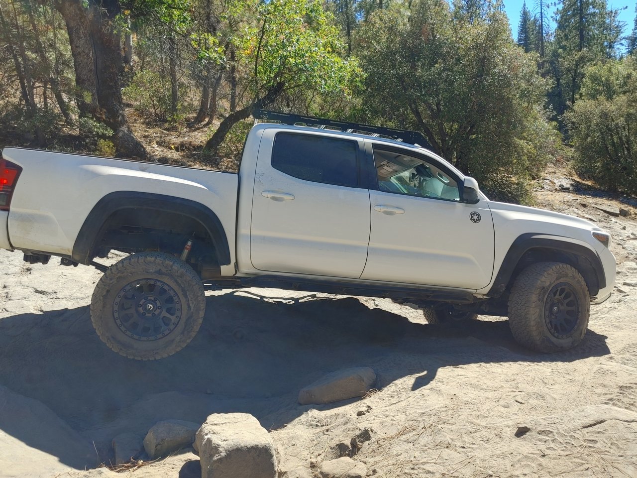

    I run a eibach pro stage one 1 spent about $800. Im also running icon 1.5" AAL's in the rear, spent about $240. I do quite a bit of wheeling whith a wide variety of terrain. All in all i get about 3in in the total lift. Great functionality and gives the truck a good stance. Really, the amount of money you want to spend is up too you. You should figure out what your needs will be and the lift accordingly. If your gonna do a lot of trail running then think about something along the lines of what im running or more expensive like an icon or toytec boss. If its for looks you can do blocks and spacers which will run arourd $300. If your gonna have a shop do it also factor on that cost, but if you have the right tool suspension lifts are fairly straight foward. The options are endless hope this helps.

    Thanks! Yeah i didn't go to the 5th notch because I didn't want it to be nose high. The ride is perfect not too firm but not squishy either
