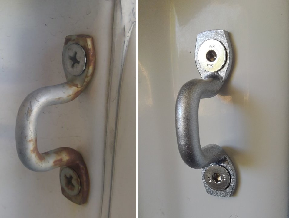

    Removed, wire brushed, primed, painted, clear coated and new stainless hardware installed with blue Loctite.

    that looks badass! ... did you remove with a screwdriver or impact tool
    i have not yet determined about the hardware and what to do :facepalm:

    This is what I used: M8 x 1.25 x 20mm. I had the spray paints and wire brush, so the total cost of the project was $7.

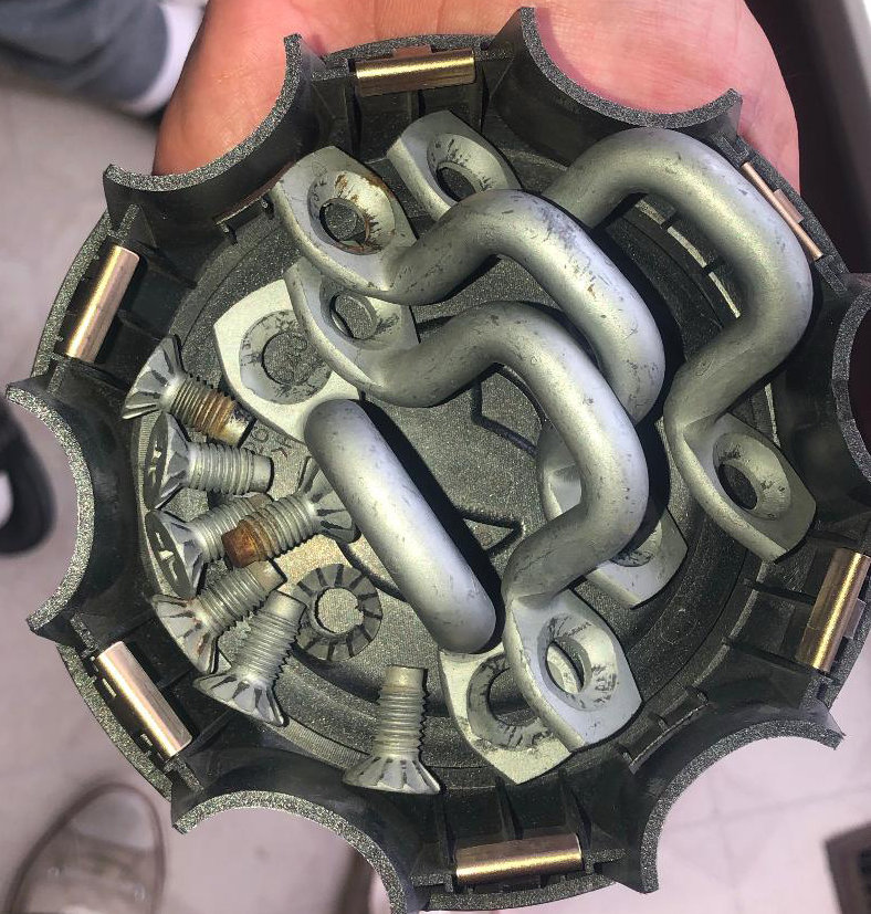

    center cap of hooks. I think the 2 bolts with crusty ends came from the driver side front but don't remember even one day later after the removal

    those look great! Ready to install after all

    magnetic??

    yes, my flashlight with a magnet stuck right up to them
    it was a bold discovery lol
    Ferromagnetic metals are strongly attracted by a magnetic force. The common ferromagnetic metals include iron, nickel, cobalt, gadolinium, dysprosium and alloys such as steel that also contain specific ferromagnetic metals such as iron or nickel.
