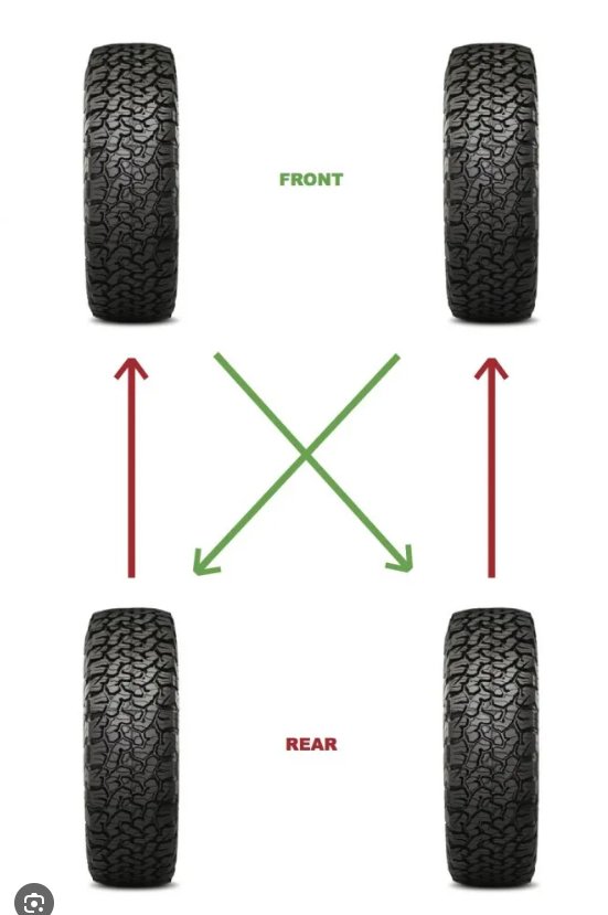

    I rotate every 5,000 miles. My oil is due every 5,00 miles so I do them together.
    I rotate the tires using this diagram. I only balance the tires going to the front unless I'm chasing a vibration.

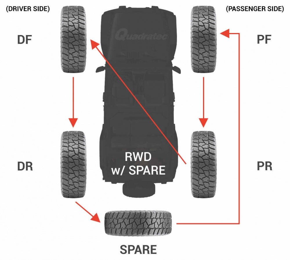

    Tacomas have full-size matching spares. Do a 5 tire rotation to get max life out of your investment.
    If your spare is currently on a steelie, just spend the $200 to buy a matching wheel /tpms. The extra wear life you’ll get will make the investment worth it
