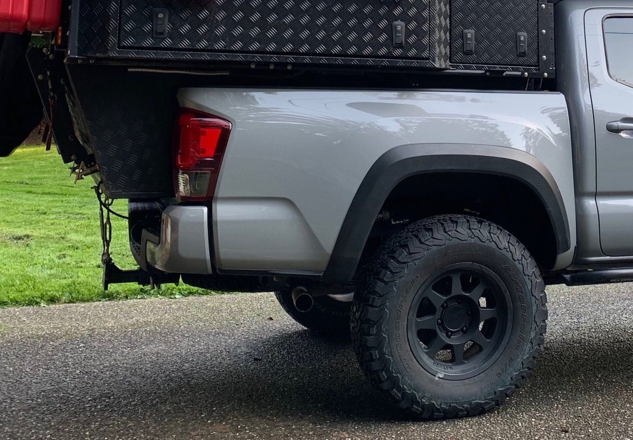

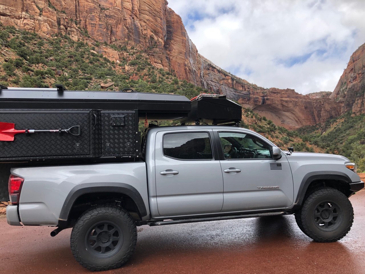

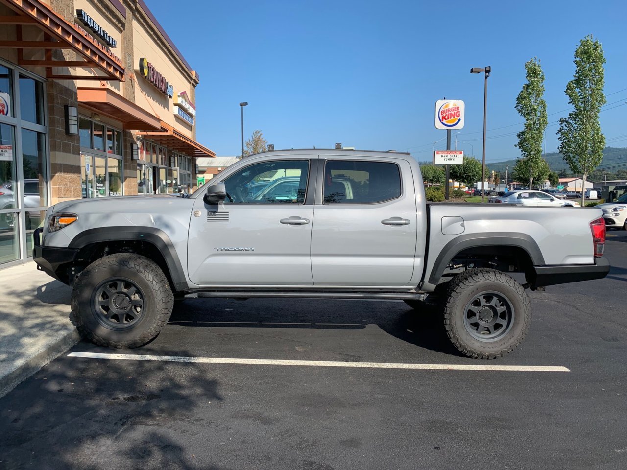

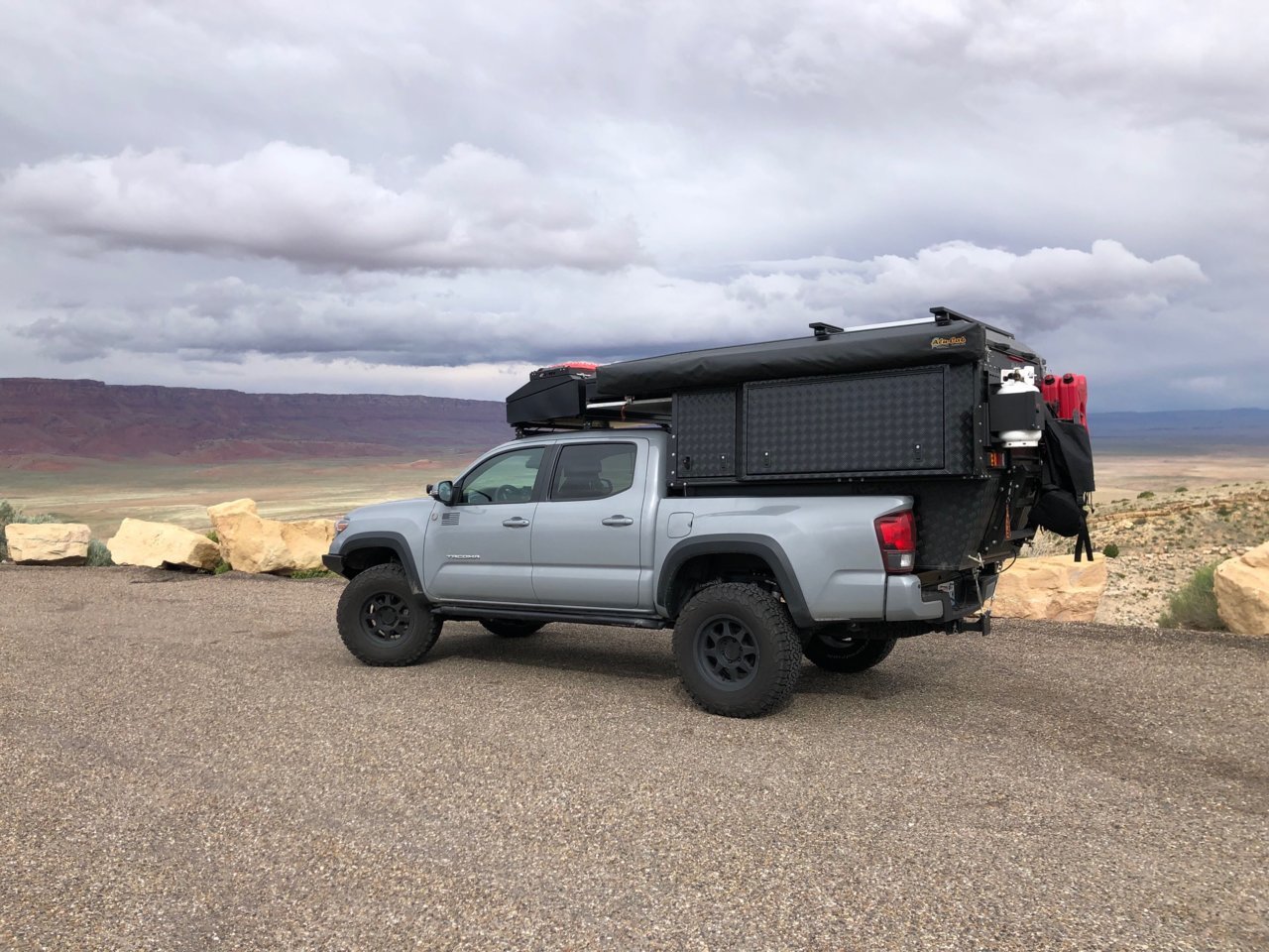

    I got the 17s and I love the way they look on the truck. Here are some photos from the last 4-5 months.
    Khaya loaded on before the rear bumper install last weekend.
    Test drive with the new rear bumper on.
    Zion National Park in May
    Grand Canyon National Park (North Rim) in May
    On the way to Grand Canyon National Park (North Rim) in May.
