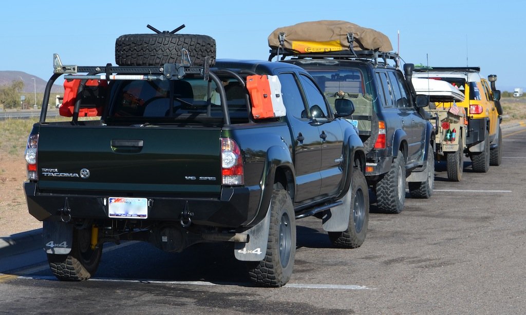

    All Pro rear bumper w/hidden hitch, All Pro sliders, Rotopax fuel, water and 1st aid storage containers, ANB Fabrication bed rack, Cobra CB, 265/70/17 KM2 tires, 17x8 ATX Mojave teflon rims, OME 886 coil overs, OME 9000 front shocks, OME N182 rear shocks, ToyTec stainless steel extended brake lines, LRUCAs, OME CS 047R Dakar rear leaf springs, 2012 ARB bumper, lights, Warn XD 9000 winch.
    This is the exact capability I am looking for.
    I just installed this bed rack and was planning to add rotopax on the driver side. Unfortunately, I just discovered this thread.
    Now that I see yours, I should have considered both sides.
    Additionally what lift did you go with?
    Thanks
    Jim

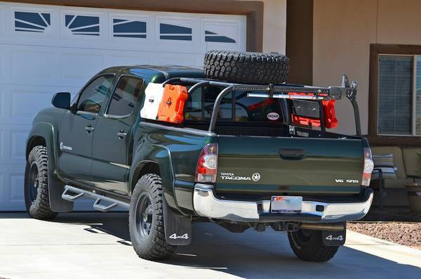

    I've had these off road now on an extended trip with all containers full with no issues and really like how they facilitate keeping the cargo area clear.
    Updated pic:

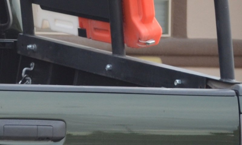

    can you show some detail on how/what mount you used to put it on the AP bed rack?
    It's not an AP rack, although its similar.
    It was locally fabbed in Las Cruces.
    I used 1/2 x 3/4 round head bolts, with the head inside the rail and threaded shank facing inboard to the bed, secured with lock nuts.
    The base of the rack is angle iron with holes drilled through it.
    Jim

    2007 Tacoma Double Cab SB 4WD - Auto -TRD Off Road - Icon Billet UCA - 8" ORI Front Struts - Bilstein 5100 11" RCD Shock - AllPro Expo Springs - Demello Sliders - Tom Woods 1 Piece Driveshaft - 16x8 Mojave Teflon Rims - Locker Mod - Locker Guard - 35" MT MTZ's - ARB Bumper - Warn 8000 winch w/synthetic line - All-Pro Front Skid/Transmission Skid/Rear Armor - ARB Front Locker - Nitro 4.56 gears - Marlin 4.7 crawl box - Twin Stick FJ t-case - ATO high clearance rear bumper
    Sorry if I was not clear. I meant how did you mount your rotopax mounts to the bed rack.
    I had steel plate welded to the bedrack side bars, drilled holes in it to accomodate the Rotopax ATV mounts and attached the Rotopax containers to the ATV mount using Rotopax fasteners.
    You can see the ATV plate bolted to the rack plate on the left side of the truck and just the bare plate on the right side of the truck.
