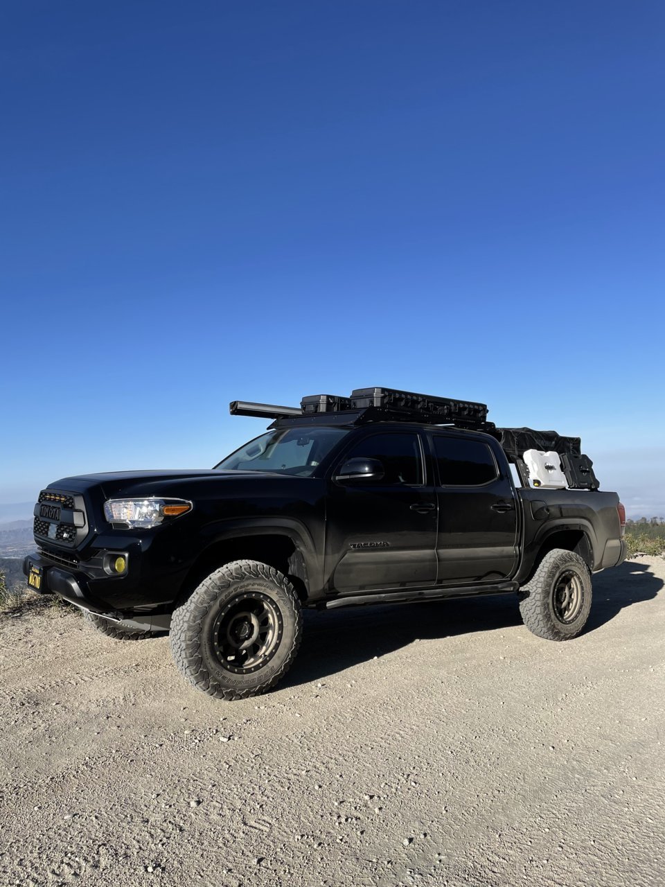

    The water pack has never leaked on me. And I store it nozzle down as well ED637495-70CD-4235-8A51-73763B09F403.jpg
