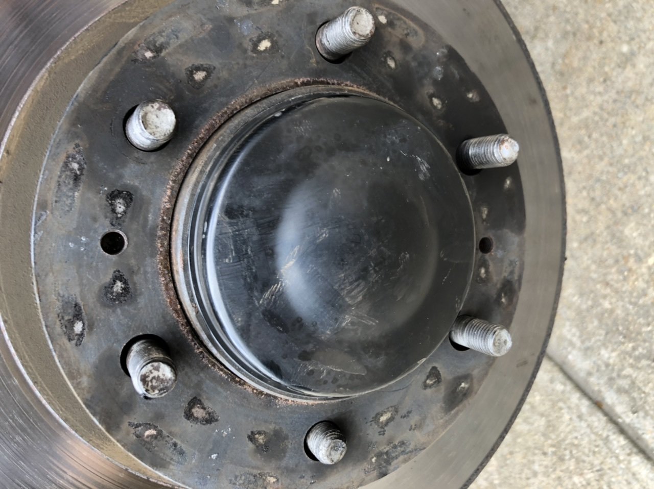

    Does anyone know what the screw is to pop off my rotor? Thank you

    m8 x 1.25

    don't see a screw in the pic, please explain so when i do mine i will know.

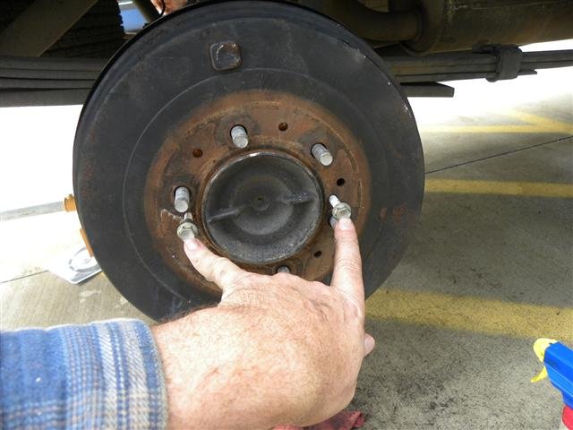

    Genuine OEM Toyota rotors and drums have two threaded holes that you use to pop them off.
    This is actually a Honda but the principle is the same:
    Rear drums:

    The m8 screw goes into the holes to push the rotor off.

    Ther s a threaded hole in the hat of the rotor. Insert bolt and it'll "pop" the rotor off.

    Put the bolt in the threaded hole to take off a stuck rotor.
