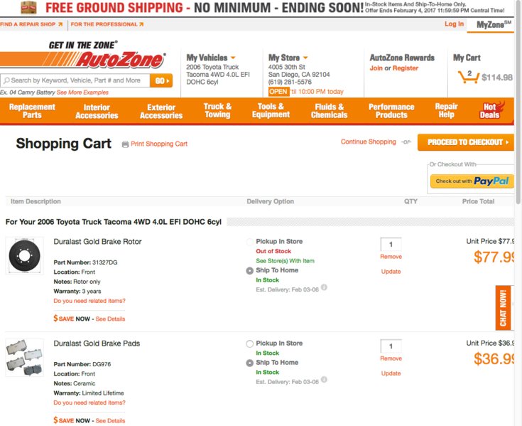

    I bought the Duralast Gold Rotors and Duralast Gold pads, still great a year later. The general consensus on turning rotors now days is to just replace em.
