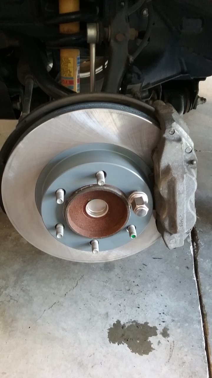

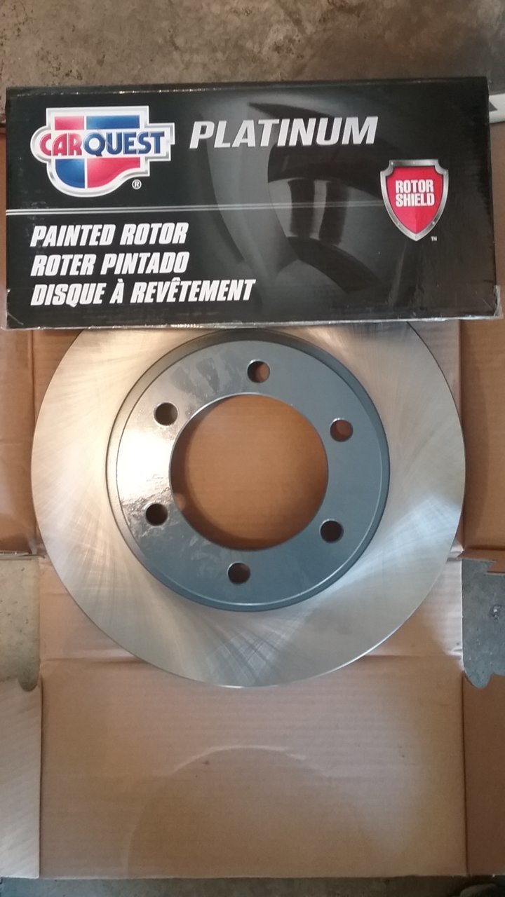

    Make sure you or someone else isn't using an impact to tighten the lug nuts. Having them too tight and or a large variance in torque between them can cause warping. Torque them snuggly only.....then use a torque wrench set to 83 ft lbs for the final torque.
    I don't feel like the OEM rotors are anything special. I replaced mine 2 years ago. These particular aftermarket ones I went with have been way smoother than my OEs ever were. And expensive rotors aren't necessarily any better.
