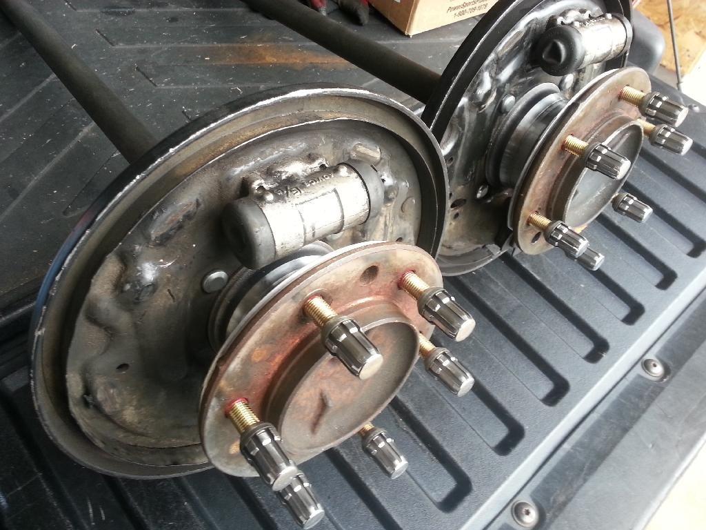

    Might. Doubt it though. Hoping to see what is all involved. I know by looking at the pics on their site, theres a few components. Would be nice to swap over components. Might be as simple as pulling off the drum and swapping over components. Not sure yet.

    I hope it doesn't involve removing the drum backing plate. As it has installed with the bearing. Which would mean either pulling the bearing, or cutting it off.

    There is no way to pull the bearing off to reuse. I have been through 2 already and one axle shaft. The bearing is expensive through toyota. My last bearing I bought was through Beck Arnley which was the same exact bearing as a toyota bearing for half the cost, my price was 200 bucks! Plus you have to get a bearing retainer sleeve, axle washer and maybe the c clip. And add the cost for the machine shop..adds up fast :mad:

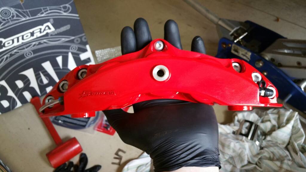

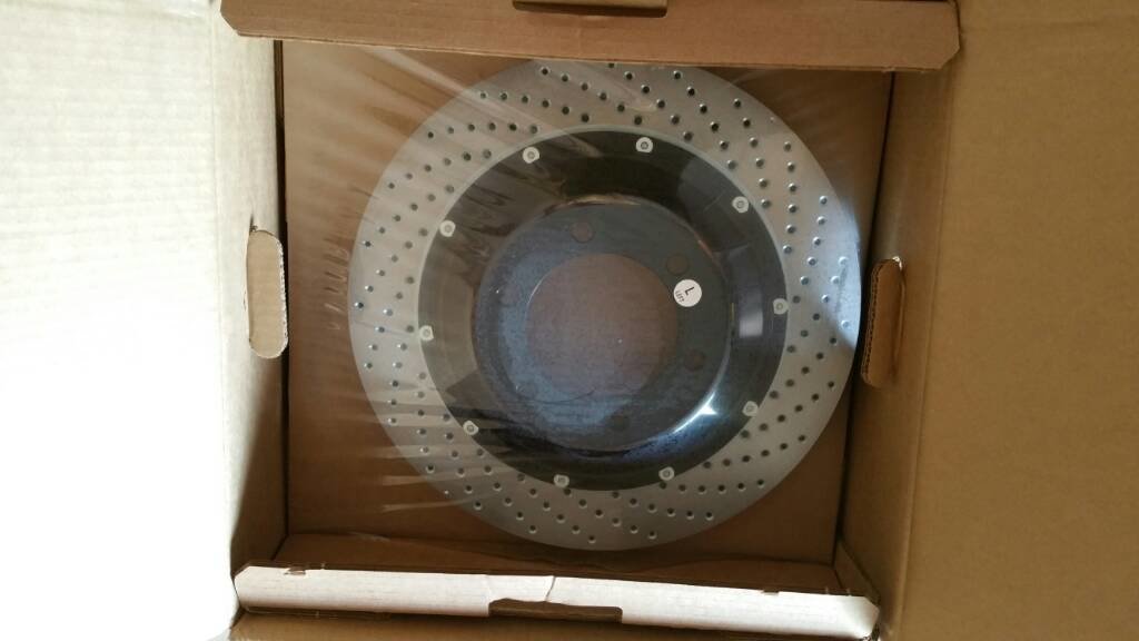

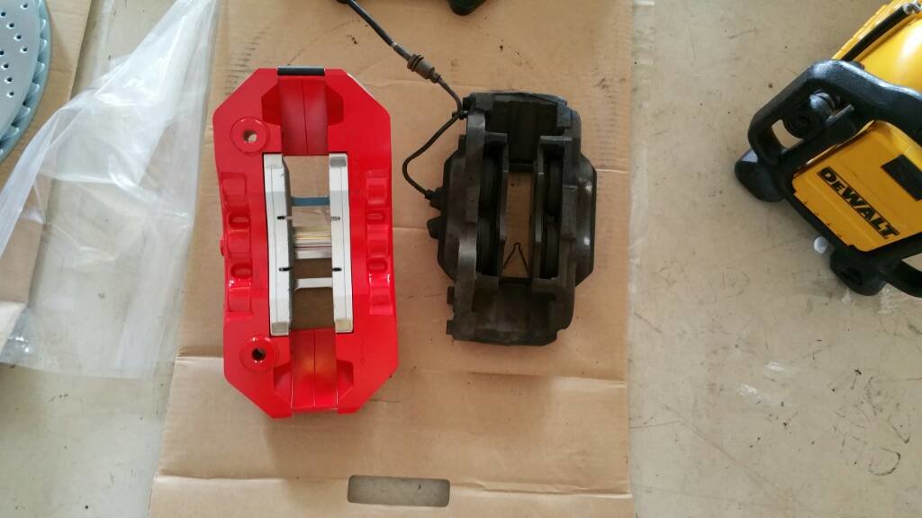

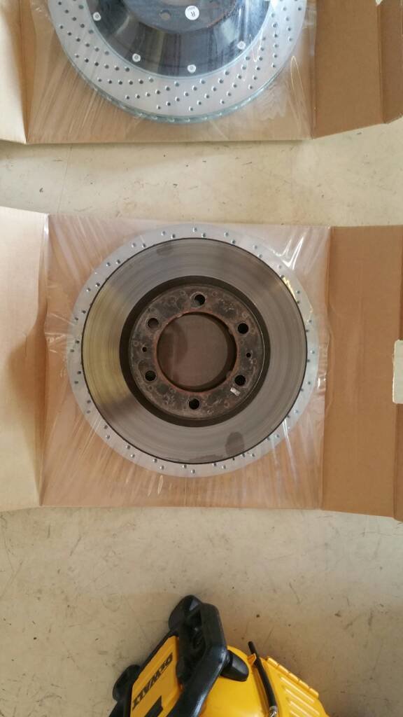

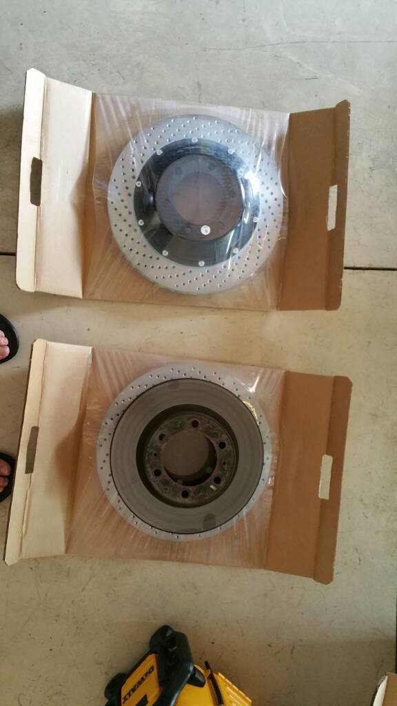

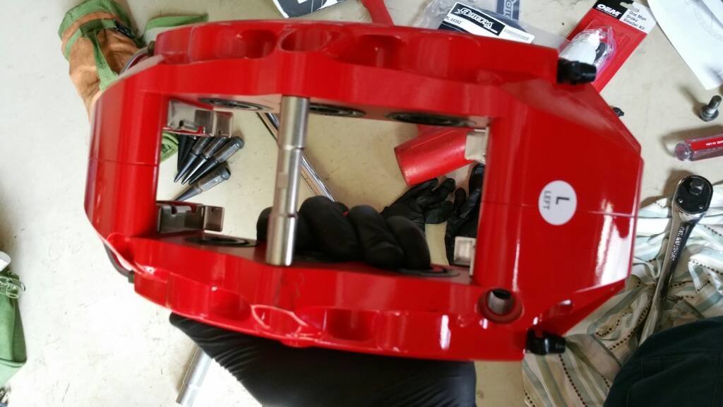

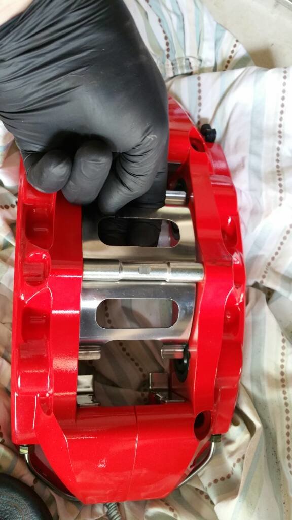

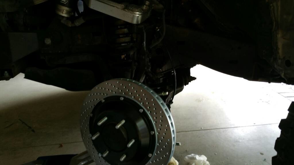

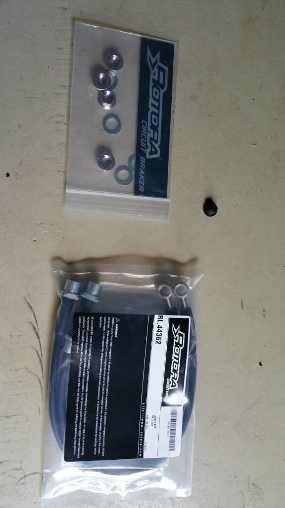

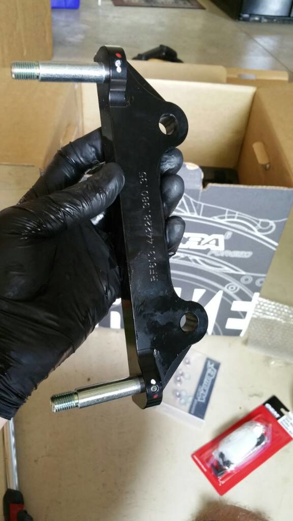

    Opened up and had a look.

    The install instructions (Instillation Manual). Should be similar for all BBK's on the market today.
  13. Apr 14, 2015 at 1:50 AM
    #93
    skygear
    skygear [OP]                    
    Nov 6, 2011
    #66558
    8,414

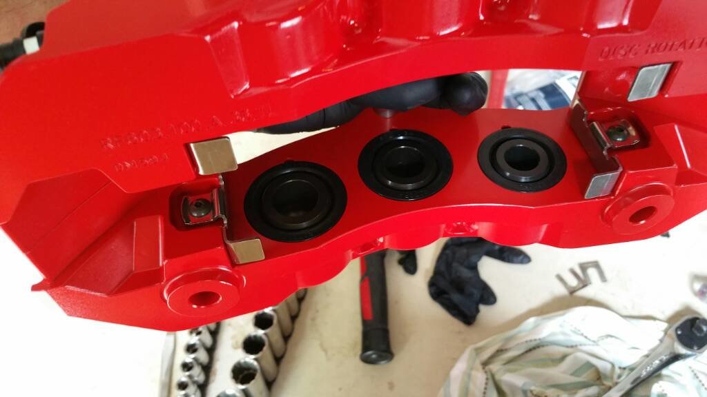

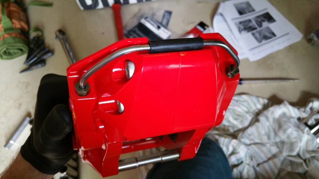

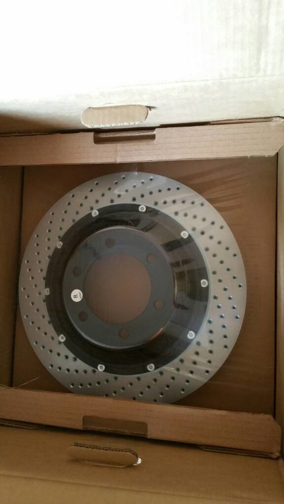

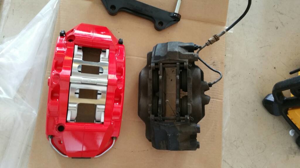

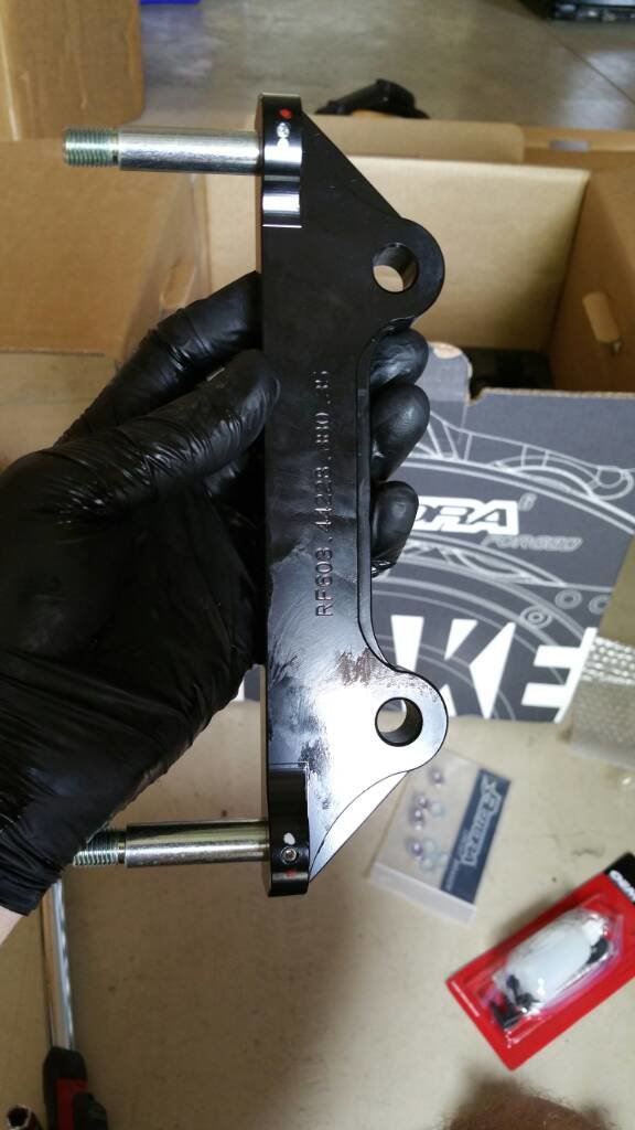

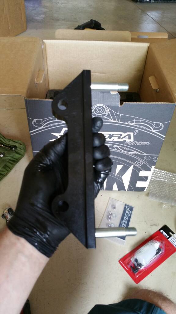

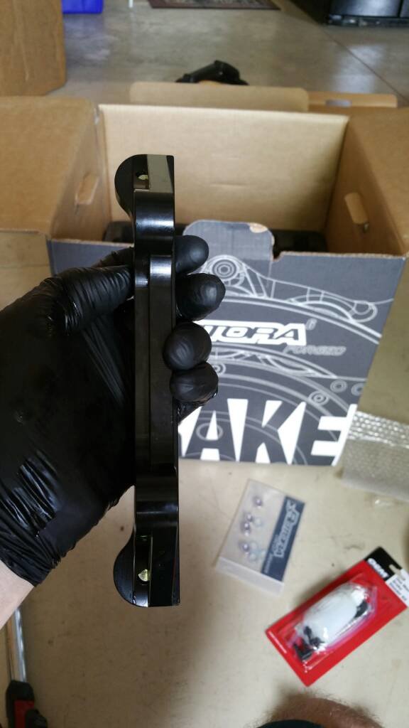

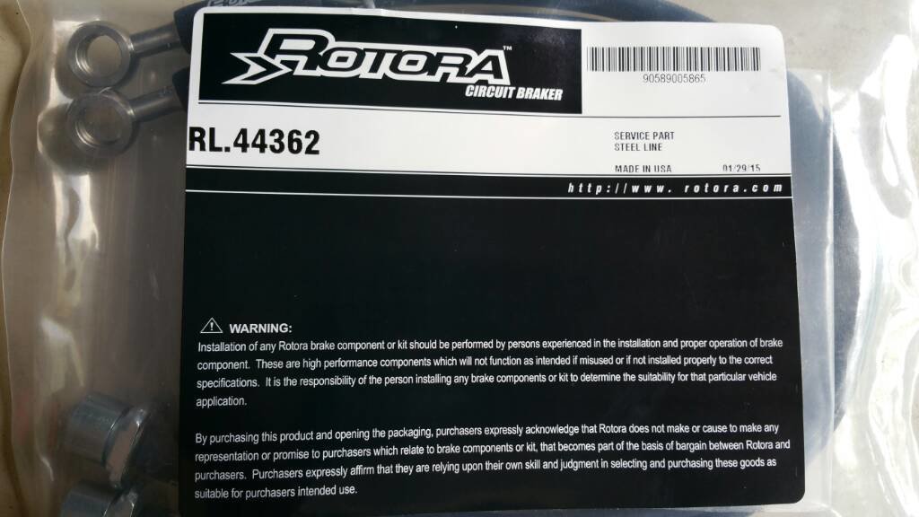

    The pieces in all their glory!
  14. Apr 14, 2015 at 1:52 AM
    #94
    skygear
    skygear [OP]                    
    Nov 6, 2011
    #66558
    8,414

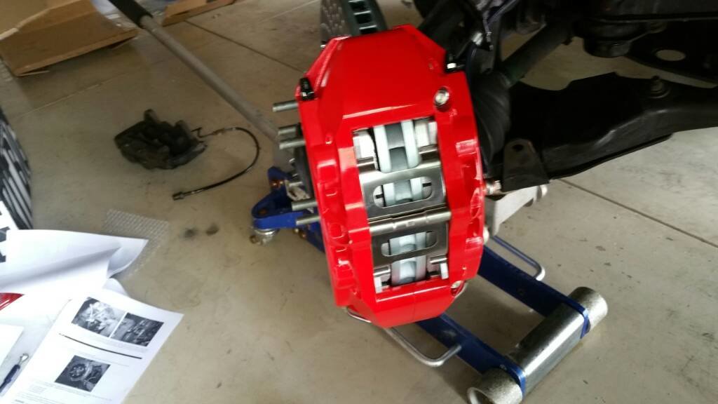

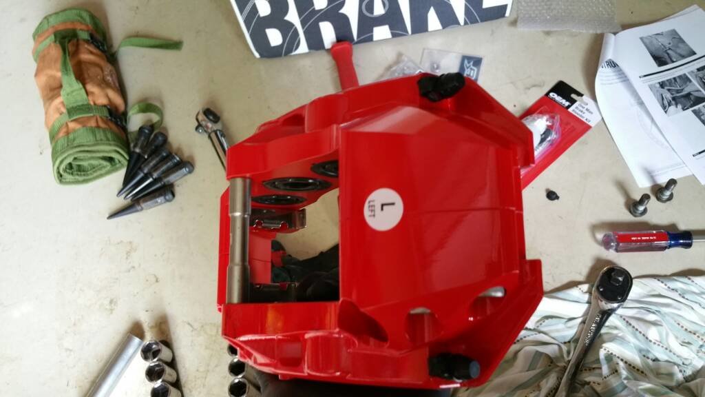

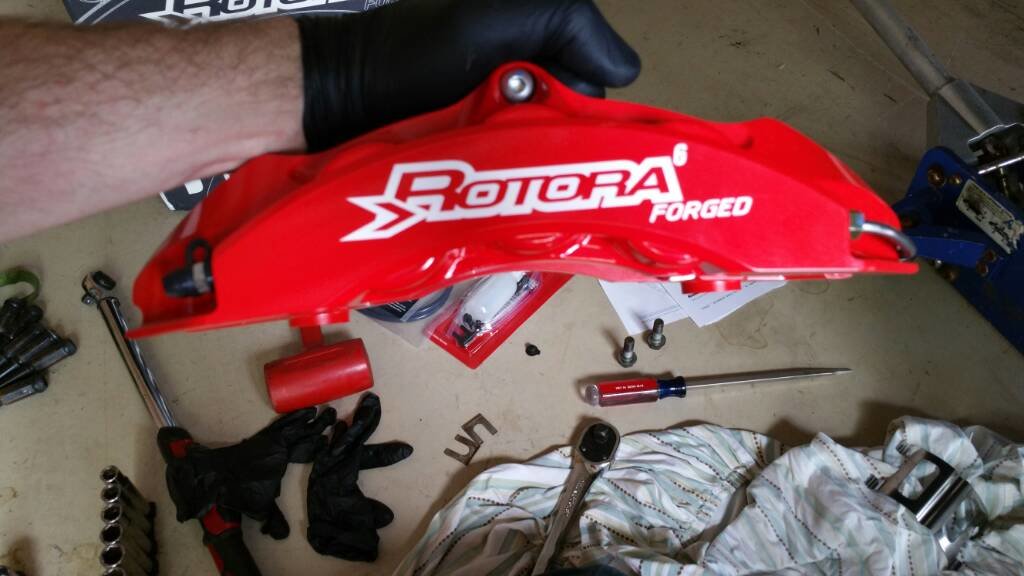

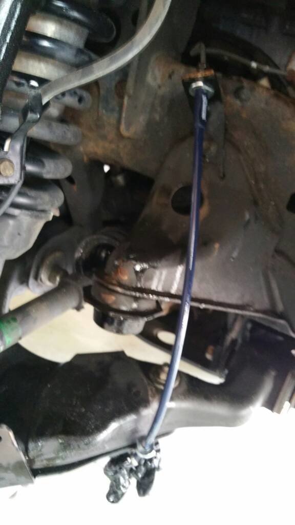

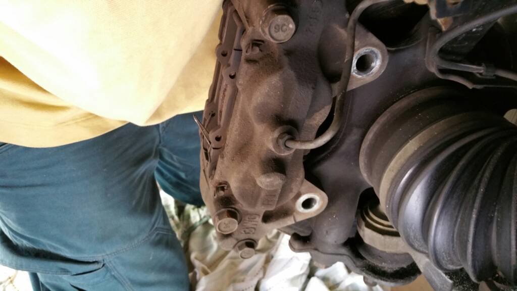

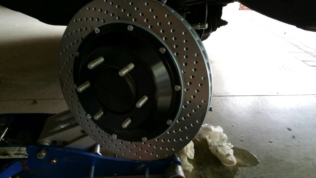

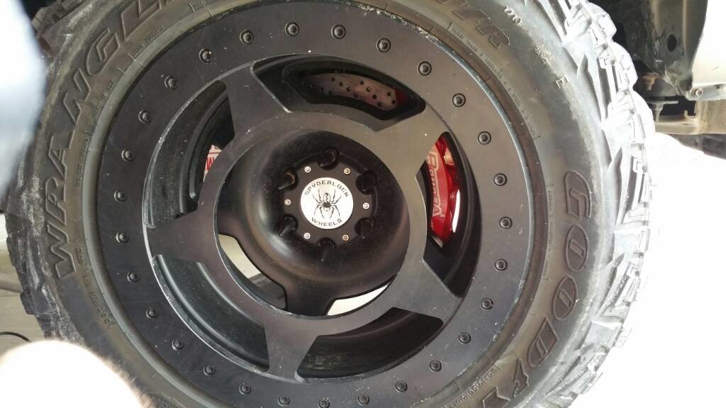

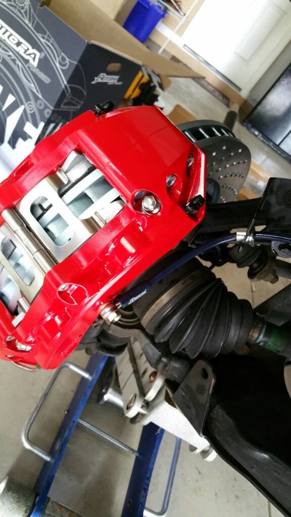

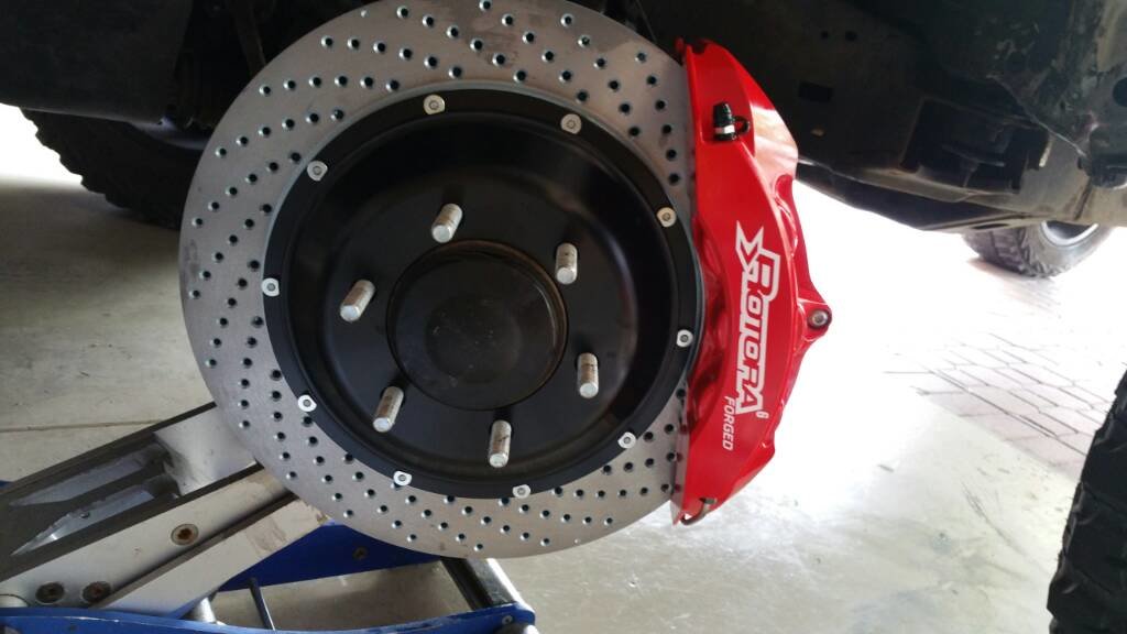

    Install (THE)
    If anyone wants to remove instead of cut off the plate, get yourself a 35mm socket and an impact. Remove the hub assembly and it comes right off. Put everything back on and DONE>
    Install is like this if you have already done the removal and cutting of the dust guard. Start on passenger side so you can bleed the brakes farthest away to closest.
    1. tire off
    2. unscrew 2 bolts holding the caliper on,
    3. disconnect the brake line and plug the system remove the 2 clips.
    4. pull rotor and caliper off
    5. install bracket for the calipers
    6. install new brake line
    7. install rotor on proper side, they are directional
    8. install caliper and bolt it down
    9. connect brake line and start to gravity bleed the caliper. Then do the brake pump to clear the rest of the bubbles after compression.
    10. reinstall tire
    11. drivers side repeat from 1-10
    12. go for a drive and do a break in on the brakes.

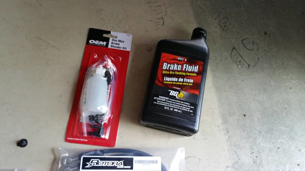

    Bleed & Flush & Bed
    In preparation for this kit, I went to the Local Toyota Dealership and had a buddy do a full system flush with the BG DOT 4 Brake Fluid Flush Kit. Hoses were hooked up and machines going nuts. All the while, he was just feeding the machine Fluid. Then came out the baster. He sucked all the old stuff out of the reservoir in the master cylinder and cleaned it some more.
    Went from dark almost black to the yellow goodness of NEW.
    So for the bleeding of the brakes, I had to track down another bottle of the fluid. 15 miles later and about 6 stops at dealerships and parts stores for intel on this elusive DOT 4 beast, Found it. Not cheap, they got me for ~$50 for this stuff. ONE BOTTLE!.
    Couldn't find my make shift collection bottle I made out of a Nalgene HDPE Small bottle and some bubbler hose, so I grabbed the one from the local autocrats store.
    You bleed the same way as any brake system. Says the proper procedure in the manual also. Furthest away, then work your way back in.
    go for a drive and do a break in on the brakes. bedding http://www.zeckhausen.com/bedding_in_brakes.htm
    http://www.youtube.com/watch?v=Gptg5QDsypA

    Towed a 4 horse trailer Thursday for a buddy. These ROTORA breaks were the perfect addition to the truck. Absolutely no fade and worked like they were supposed to. Felt that the trailer was there of course. My confidence level was restored in the truck after this hall. If you don't have a BBK, get a set.
    Cant make up your mind on a kit to go with? Track me down and drive my truck The Rotora kit will stop you in your tracks.
