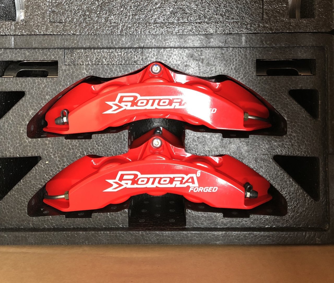

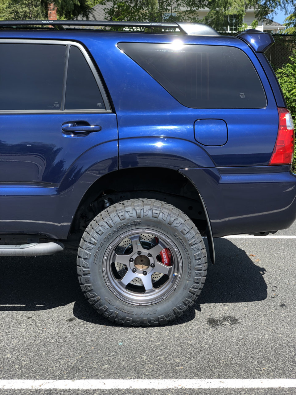

    This review is for my 4th gen 4Runner but these guys also make the same front rotor kit for the 3rd gen Tacoma.
    After adding the heavy 285 Nitto Ridge Grapplers, full skid plates, the OEM brakes were just not cutting it. I could feel the additional weight every single time I depressed the brake pedal. It simply took more effort to slow the vehicle down. In addition to the sticking calipers, the shimmy due to warped rotors, (due to the vehicle weight and living on a mountain), and in anticipation of adding a winch bumper, sliders, roof rack, etc... I started looking into aftermarket solutions.
    Big brake kits are not cheap. Many folks are not keen on spending thousands on bigger brakes and this is clearly not an upgrade for everyone. I spoke with Loren at Rotora and ordered the 14” front and rear rotors with forged aluminum calipers and stainless lines. Installation went without a hitch. Rotora brake pads are now bedded.
    Arguments against BBK:
    -OEM system is adequate
    -Once ABS kicks in BBK do nothing more to slow the vehicle down
    Counter arguments:
    -Even with OEM wheels and tires, sticking rusted calipers, warped rotors, and fade seem to be a regular problem secondary to heat. Add bigger tires, trail armor, any amount of towing and the OEM system which is already struggling is easily overwhelmed. Adding larger rotors provides a bigger heat sink and results in less fade with repeated use. Pushing the lever arm out with larger rotors and calipers will assist with slowing the vehicle and require less effort in terms of pedal pressure to do so. Threshold braking obviously takes far less effort.
    -Engaging ABS occurs faster and takes less effort.
    Initial impressions:
    Packaging: 10/10. Everything came packaged in press fit and precisely cut styrofoam.
    Quality: 10/10. Amazing quality. Caliper brackets are billet aluminum hard anodized black. Powder coated red finish on the calipers is spotless.
    Weight: 9/10. Rotor weight was reduced in the front despite being larger thanks to the two piece aluminum hat. Rotor weight in the rear was increased as they are significantly larger than OEM. See pics.
    Install: 10/10. Straight forward. Remove OEM rotors and calipers. Cut dust shields, (or remove them and place washers between caliper brackets and hub). Install Rotora rotors, caliper brackets, calipers and lines. Bleed system.
    Pedal feel: 10/10. Takes significantly less effort to slow the vehicle. Zero fade after repeated slowing from 50-5mph x 10 attempts.
    Emergency braking: 10/10. Tires skid with less effort and ABS kicks in sooner.
    Overall: 10/10. Tremendous improvement over the OEM system.

    Why is this in the 3rd gen forum?
    Looks like you have a 4 runner. Do they have a kit for second gen tacomas as well?
    Link?

    His pics are of a 4th gen 4Runner which has discs all around stock.

    Dam, I’m blind as a bat, for too busy looking at the brakes to look at the vehicle.

    4th gen and 5th gen 4runners and 2nd gen and 3rd gen tacos share the same front brake system. I didn’t realize the rears on the tacos are drums.
