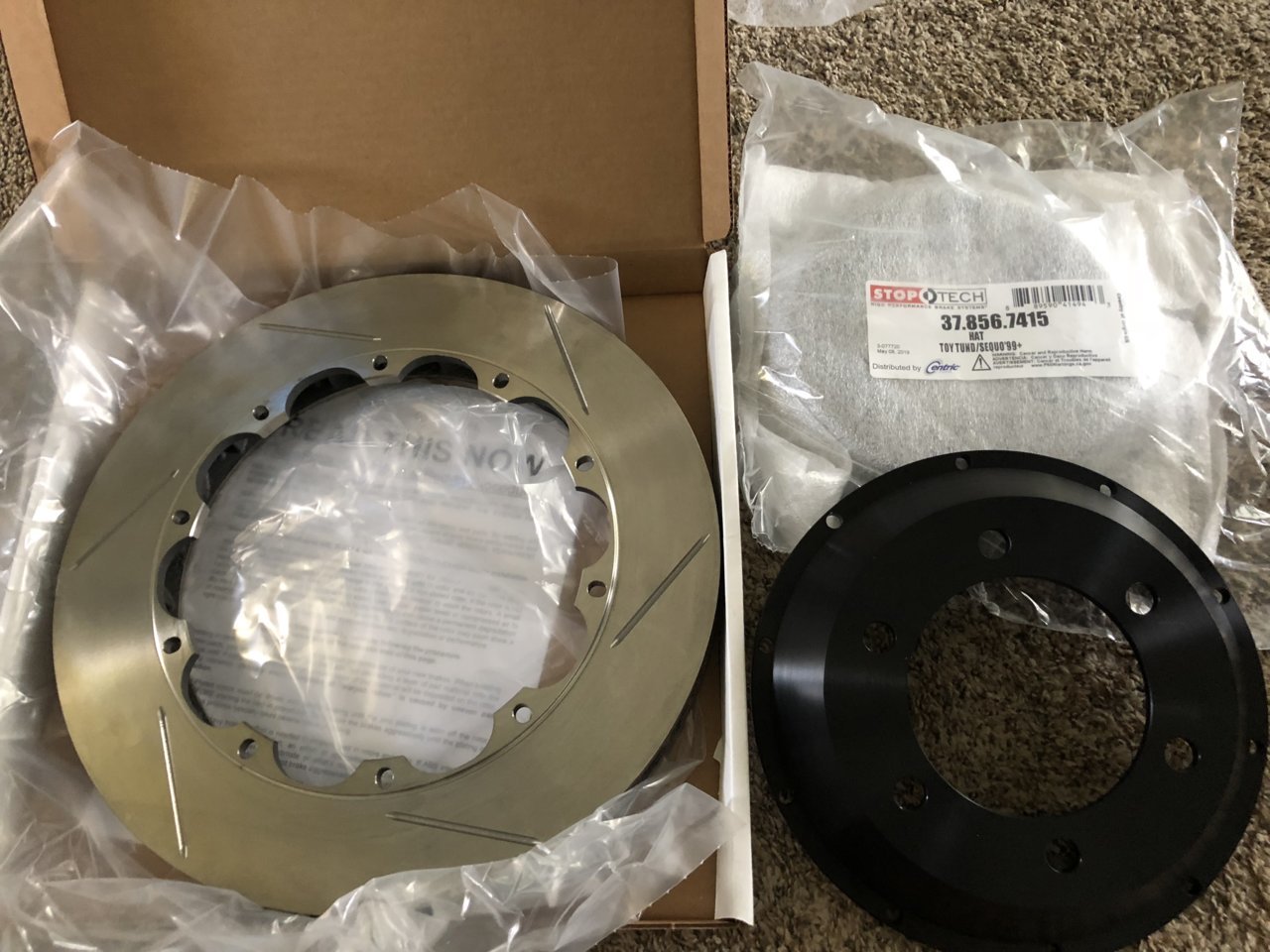

    total thread jack, but what's your opinion on the StopTech kit for 16" wheels? Is it the smaller rotor that limits its performance?
    Im trying to decide between 16/17" wheels but would like to stay with 16s..

    crashnburn80
    crashnburn80 Vehicle Design Engineer
    Jun 6, 2015
    #156893
    14,772
    Kirkland, WA
    2003 DCSB TRD OR
