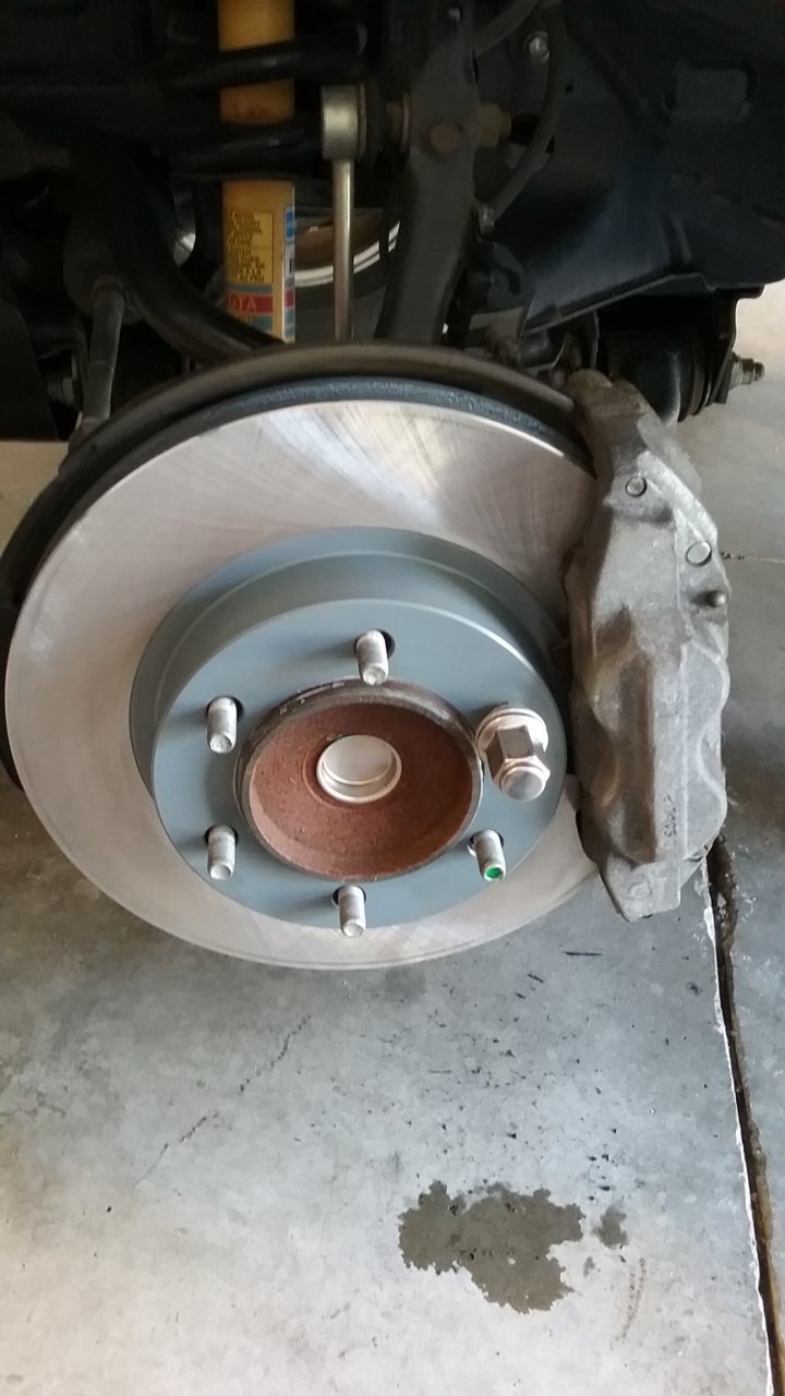

    Hey thanks. How do I make it right then? Scrub the pads and rotors ? And with what?

    Is there any other manual way to do this? Physically scrub the rotors off?

    I would try scotch brite discs on my air die grinder or in a drill.
    It's easiest to have the rotor off the vehicle so you can get to both sides without contortions.

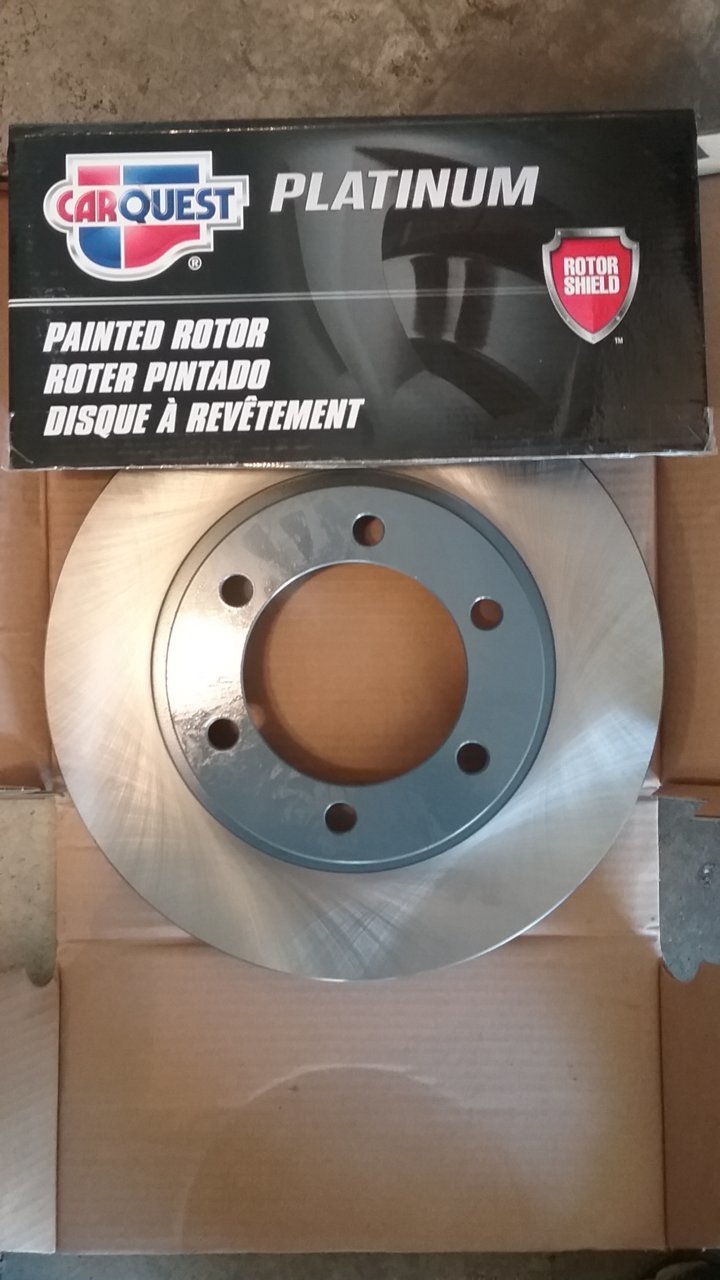

    I found my rig very slightly vibrating during brake application....despite never towing anything or never overheating the brakes as far as I know.
    I just went with the simple and relatively cheap fix. No fancy crossed drilled, vented, this, that and the other.
    Advanced Auto Parts rotors. Smooth as silk. 2 year replacement warranty, including against "warping".

    I put the same Advanced Auto rotors and pads on my truck last August. Couple of weeks ago I started having bad vibrations on braking. Knew this was caused by warped rotors. Took the rotors back to Advance and they replaced the rotors and pads under their warranty. Cost me nothing but my time to replace them.

    Curious if you followed a specfic bedding procedure when you initially installed them, and if Advance asked you about that.
    Improper bedding is a big factor in these problems.

    I have always bedded new brakes. I always put on new pads when I replace rotors. I had the setup on for 11 months, then all of a sudden I started having vibrations/pulsing on braking. Advance did not question me on anything. Replaced the rotors and gave me new pads when they saw I purchased them together. Always save receipts when warranty is involved.
