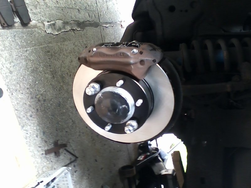

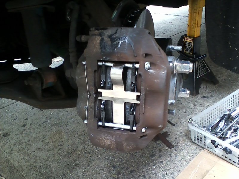

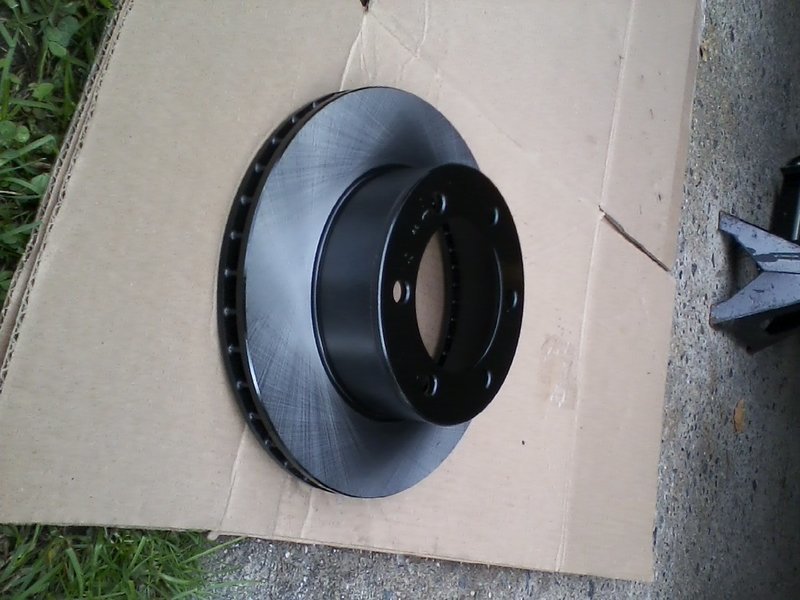

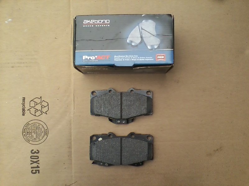

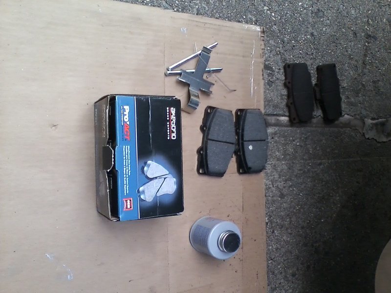

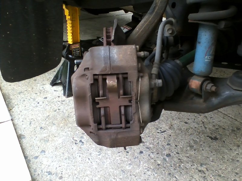

    Weather was nice, and I went to work on the Taco
    Some pics.

    I also chose the akenobo with centric high carbon alloy rotors on my 2004 double cab. For me, they work well, especially when pulling my boat this summer (16 foot inboard/outboard).
    Everything from Rock Auto.

    I bought them from RockAuto (pads, rotors and the new pin set).
    I am sure other vendors sell them too, but I have been buying from RockAuto for years, good service and pricing.
    Nice truck you have there. Always liked that color

    The Akebono brakes stop very well, have zero dust, no squeaks after 1.5years, and still have plenty of meat.
    The rotors are straight and shiny and held true.

    Thanks for the info, helps a lot! It looks like I might be going with that pad/rotor combo.

    You may want to buy the installation kit for a few $'s too. Might as well. 2 of my brake pins were bent. When I replaced them, the brake pads were hanging true on them.

    Ended up ordering the centric high carbon rotors paried with the Akebono pads. Also got the installation kit with new pins and clips. Hopefully these will hold up well. Do the Akebono pads come with shims and is there anything else I'll need to do this job?

    I do not recall if they came with shims (age related), but you can use the shims from the ones on the old brakes. A little of the special grease on the back of the shims is helpful (between the shim and the caliper piston).
    You will be very happy.
    I used Permatex anti seize on the pins just to be sure they slide free and do not rust. I always put some on the back of the wheels too.
    You do not need anything else for the brake job. I replaced the flexible brake lines going to the calipers and replaced the brake fluid a few weeks after the brake job. But that is not necessary.

    Switched to Akebono brake pads earlier this year for my Taco. Prior I had a lot of brake squeals from using cheapo ceramic pads from Autozone, but that all went away after switching to the Akebonos. Only thing I wish is that at their price point they could at least also include shims.
    Being ceramic pads they don't stop as well as say semi-metallic pads I've tried, and are comparable to the other ceramic pads I've tried prior. Very minimal to negligible amount of brake dust. The mass of the brake pads themselves are much less then the other pads I tried to (I'd guess roughly 30%-40% smaller), so time will tell how well they will last me compared to other brands. So far so good though.
