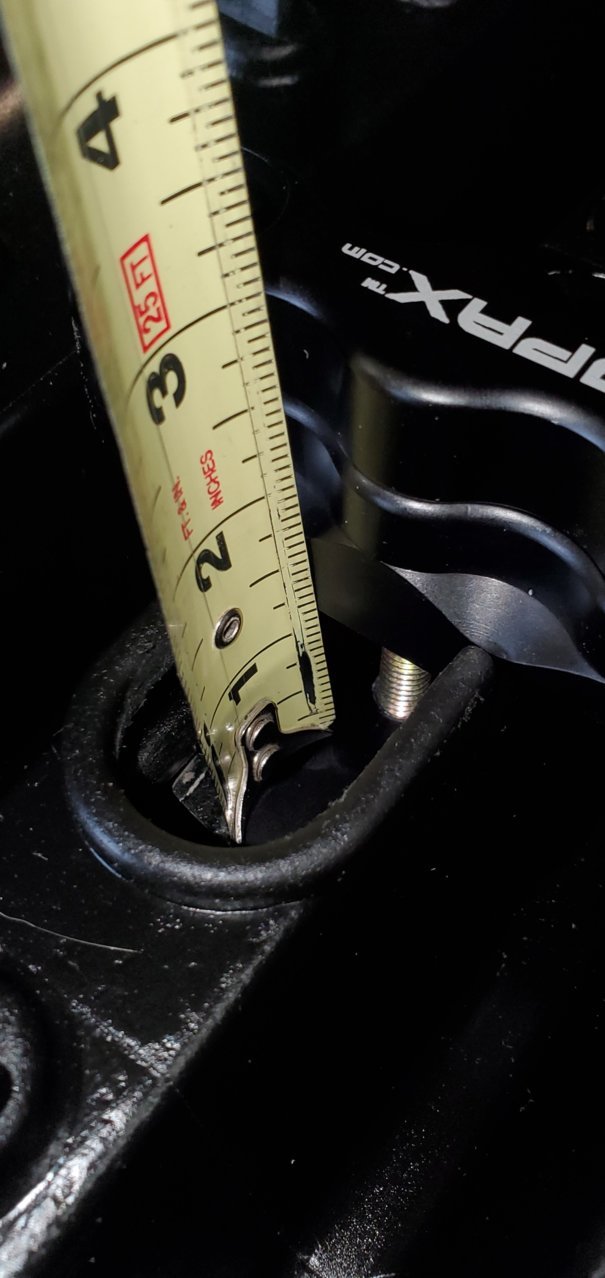

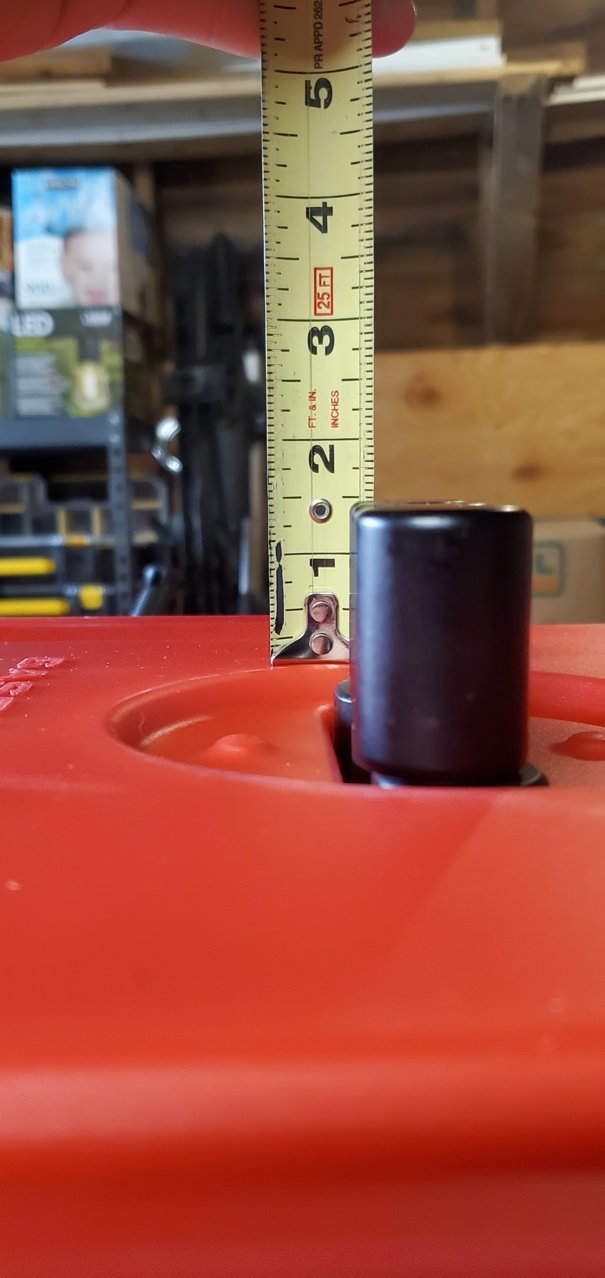

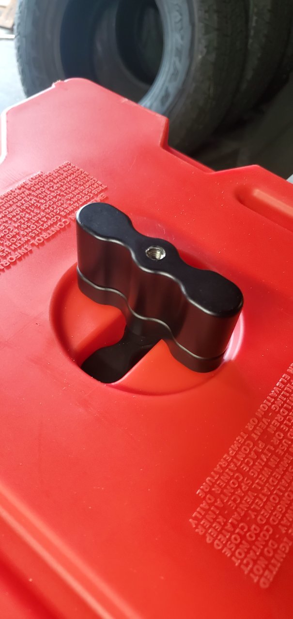

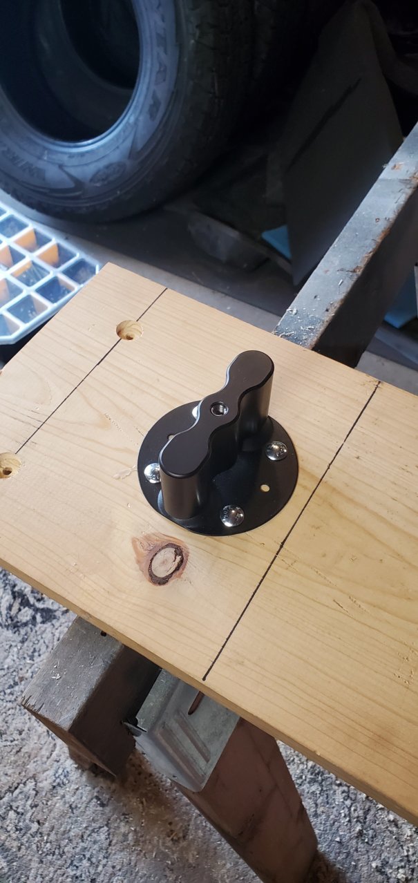

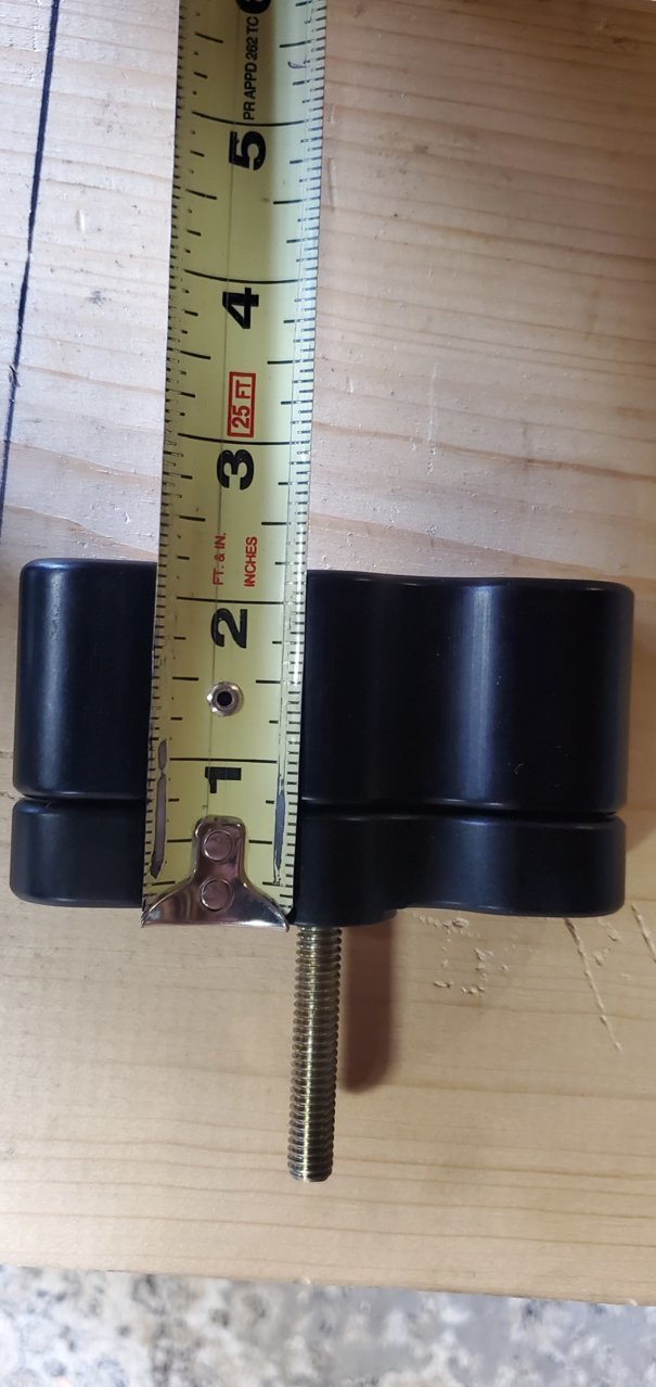

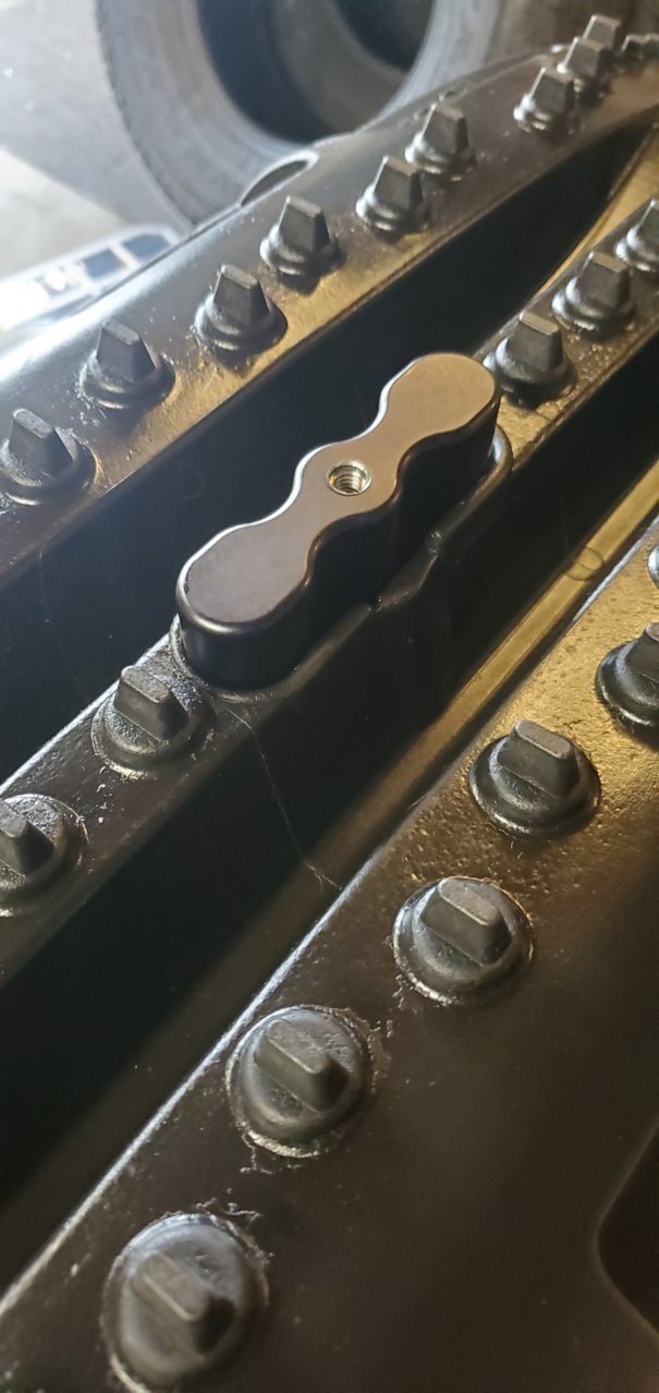

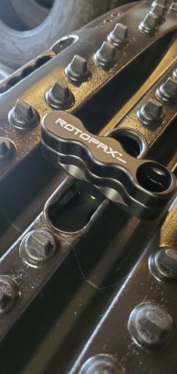

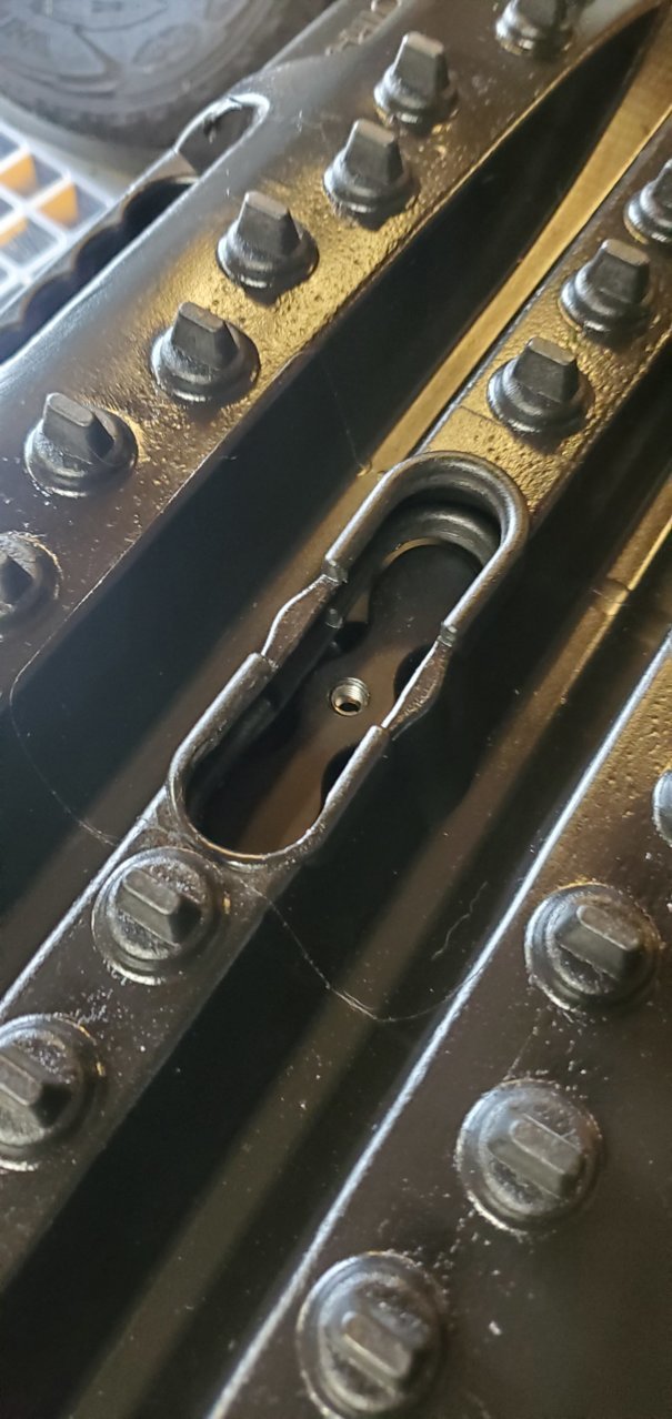

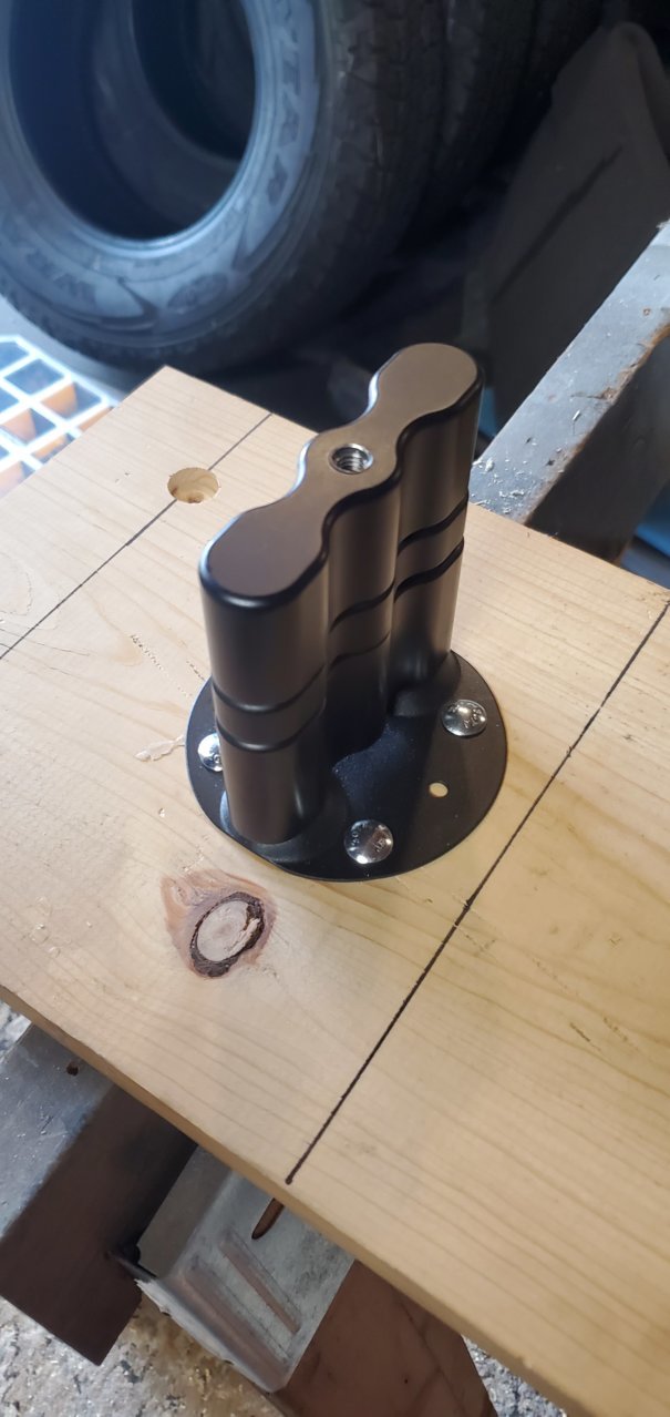

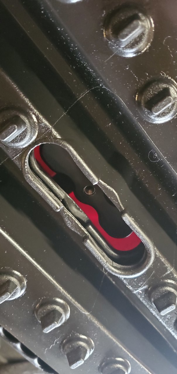

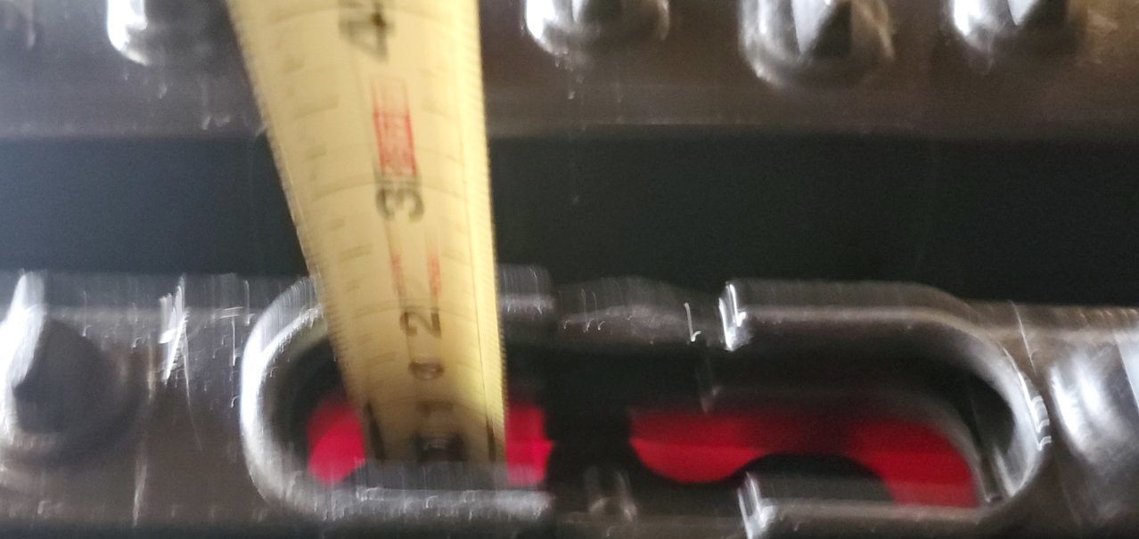

    Here's my plan:
    I have the mount I'm building in the garage, so I can simply throw this together for you.
    LOX mount base:
    RotoTrax on that base and w/ LOX:
    Now, how I interpret the sites instructions - use a small extension. Note how it doesn't work:
    Stacking info.
    Mount base + 4 gal:
    Mount base + 4 gal + extension:
    20200519_172030.jpg 20200519_172752.jpg 20200519_172017.jpg 20200519_172738.jpg
    Here's the RotoTrax on the 4gal + extension :
    IMO, the extension needed in this case would need to be 1" taller. Without dimensions from their site, I don't know which one would be best.

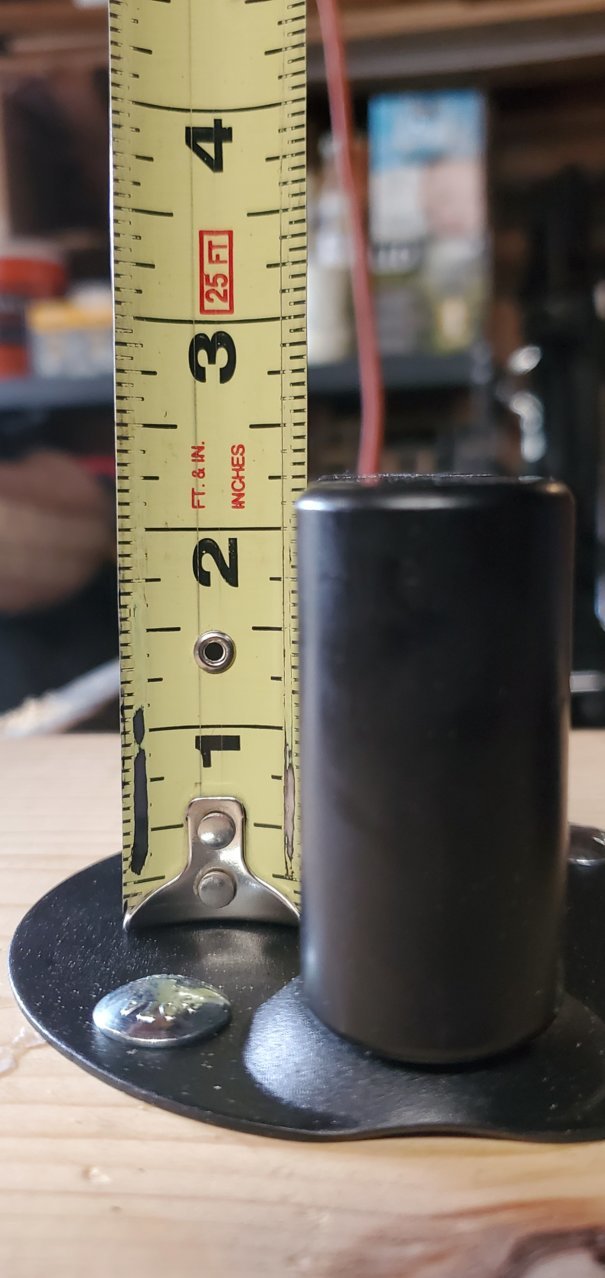

    Measurement of the small extension:
    projghost[OP] likes this.
