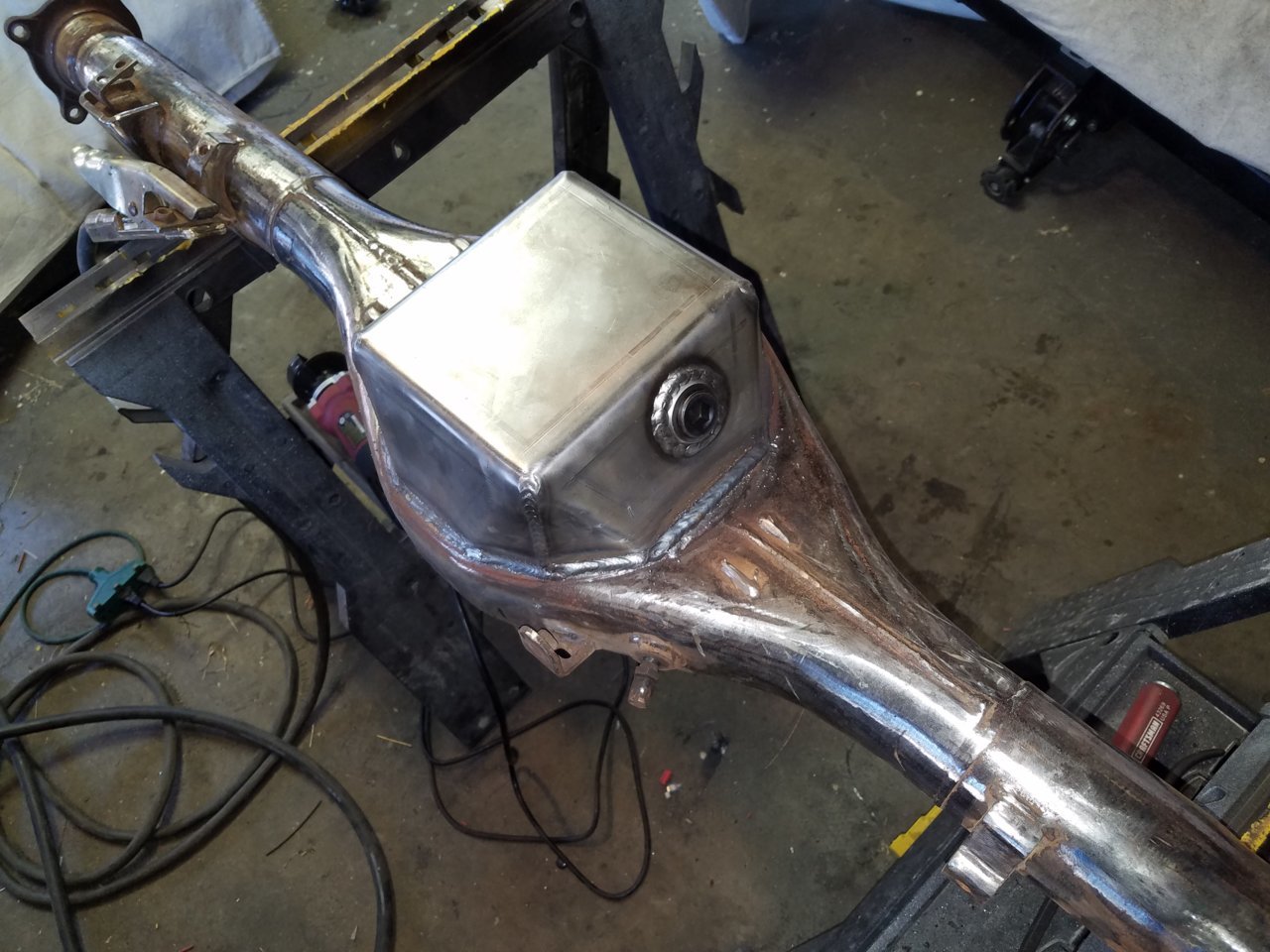

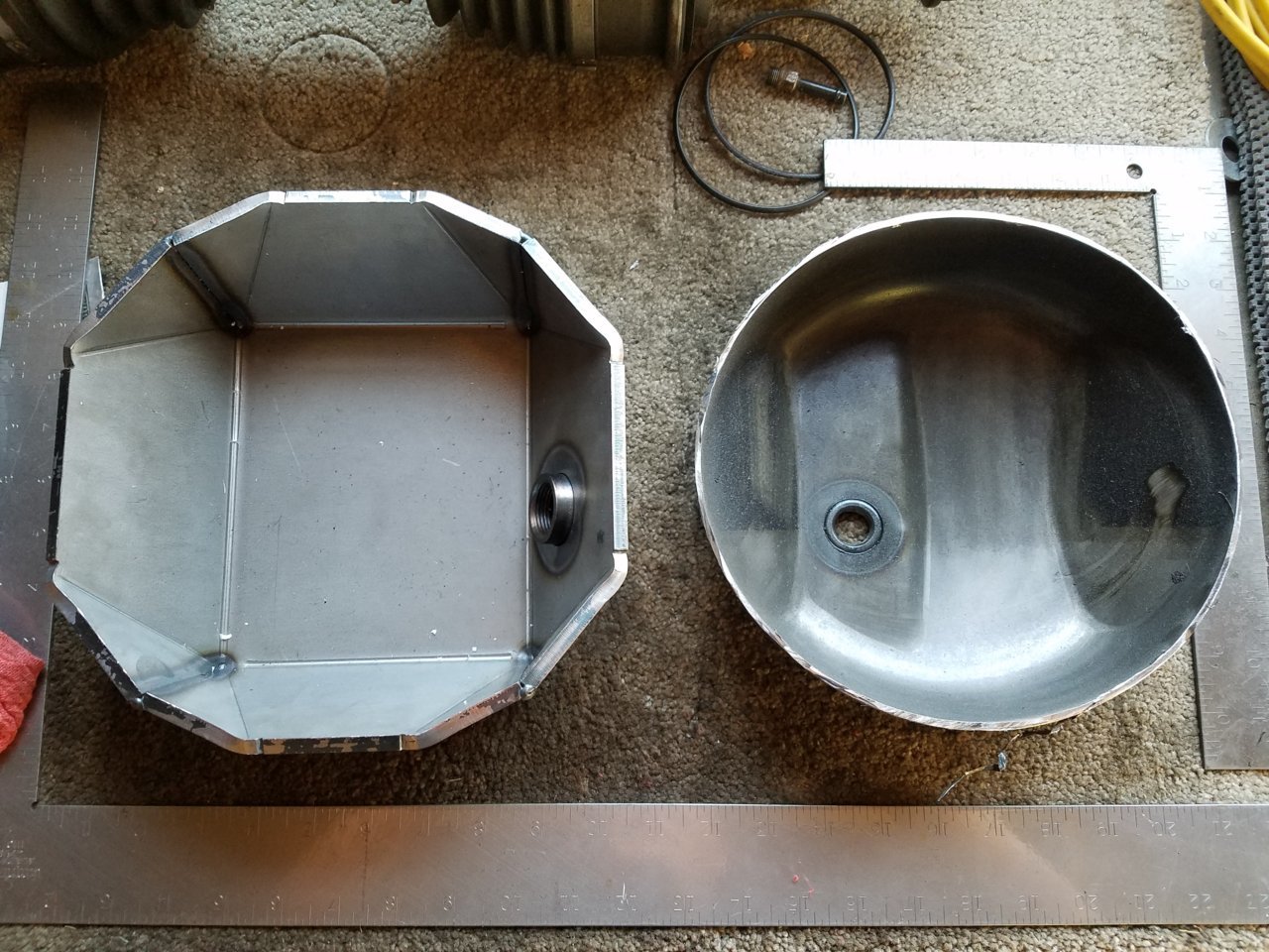

    +1 for @Wulf If your diff is rusty I'll second the Barnes fix, plus super beefy...quarter pounder with cheese vs. kiddy meal.

    Did you cut the cover off in place or was the axle off?
  20. Jun 8, 2019 at 2:03 PM
    #20
    Jiveydude
    Jiveydude Well-Known Member
    Oct 22, 2013
    #115035
    1,324
    Micah
    OH
    04Taco
    Stuff and things that make it better.
    Pulled the axle.
