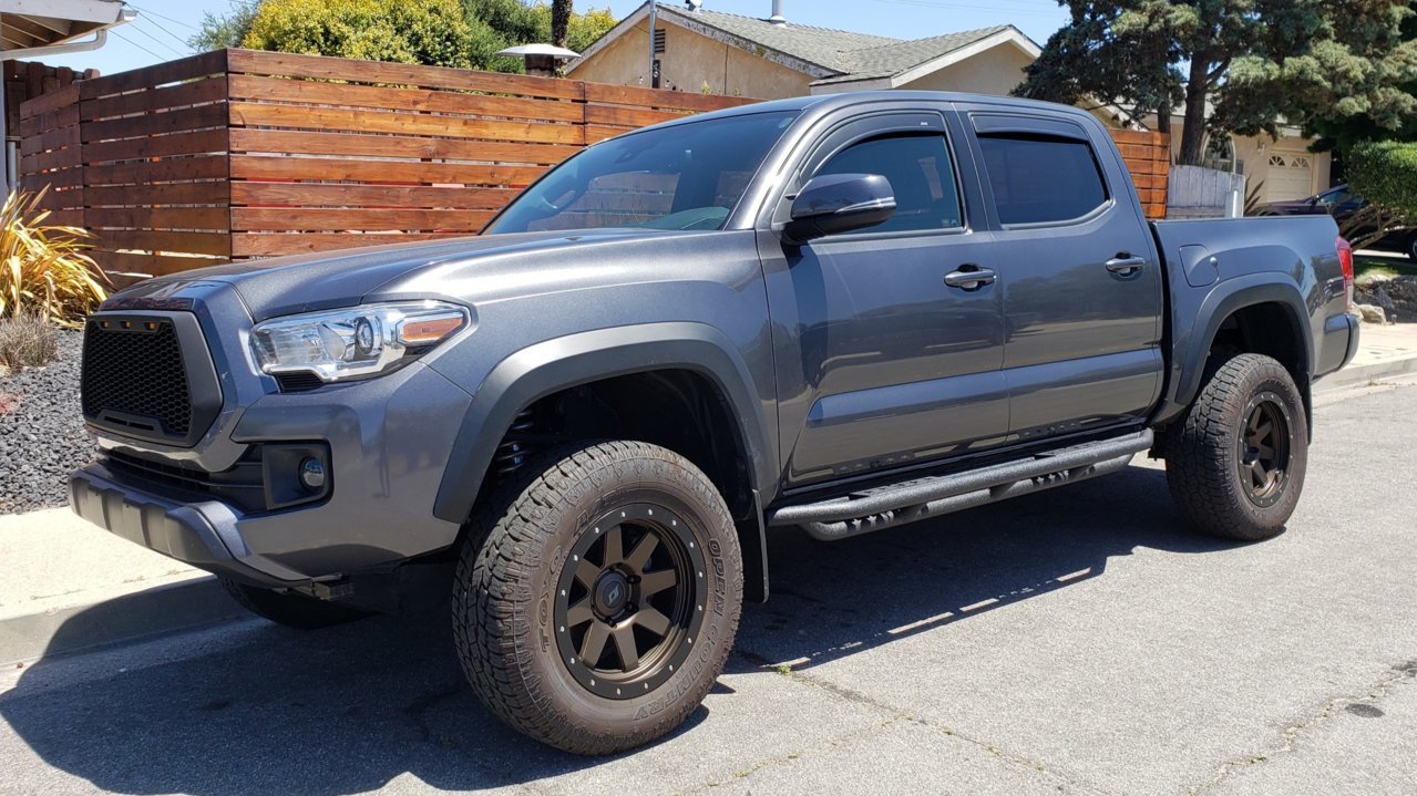

    Rough Country 2” level kit. No rear block. 265/75r16 on 16x8.

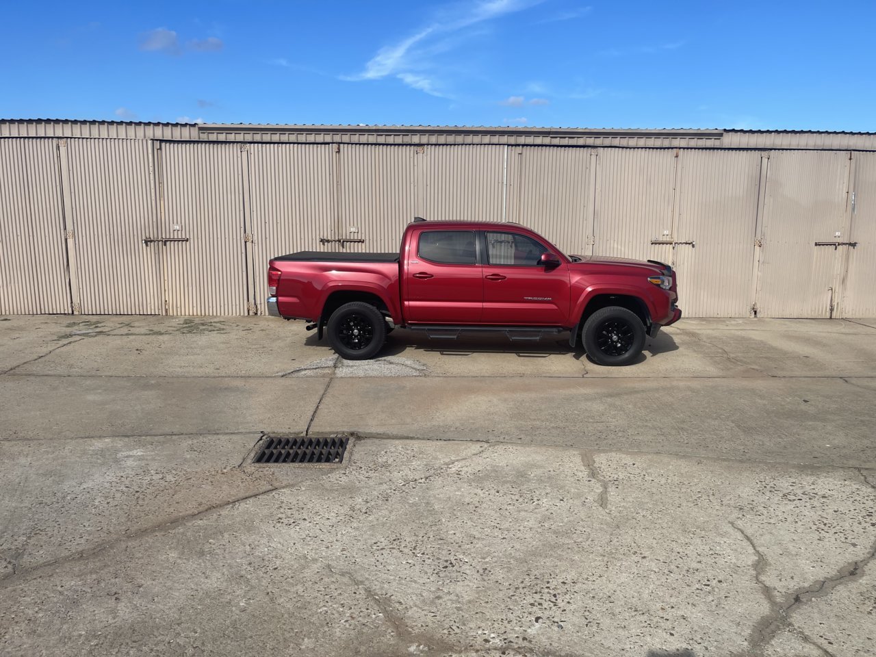

    Old post but I just installed a 2" spacer kit Saturday and it does exactly what I wanted: leveled the truck. Your LCA has no clue if it's a spacer, coils or a piece of 2x4 so what's the difference?

    I put a 1/2 block on my previous sr to level it and I NEVER went of pavement or jumped it... it served my purpose at all... it all depends on you use.... it feels like politics. You install spacers you die haha come one... it is not like that.

    Idk why everyone says that a 2 inch spacers lift makes front of truck sit higher then back , mine doesn’t before lift I had around 2.5inch difference between front and back and now after I did the 2 inch I have a little less then a .5 inch front rake compared to back , which I’m fine with cause you don’t really notice it . To me truck sits level without having to add 1 inch blocks to rear
