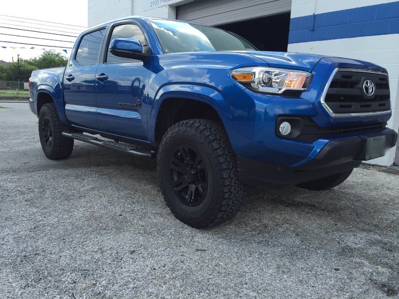

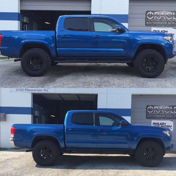

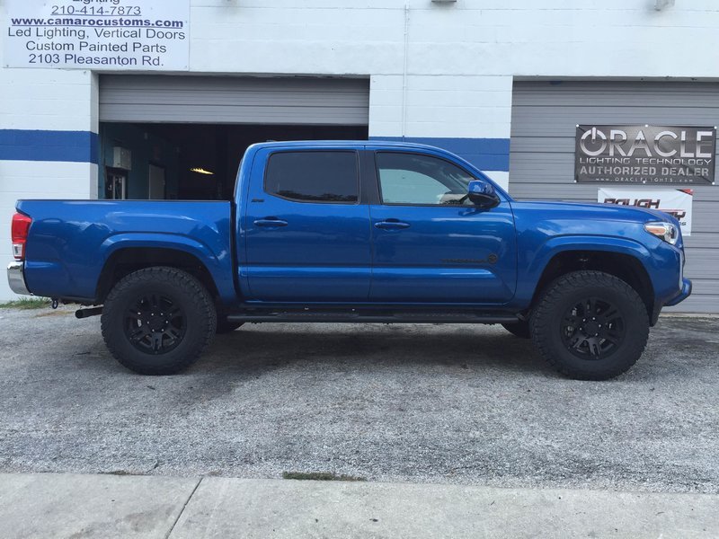

    San Antonio, Tx
    2016 Toyota Tacoma SR5
    Maxtrac/Bilstein suspension 16x8 Pro Comp 69 315/75/16 Dick Cepek Morimoto Profile Prism RGB Halos & Demon Eyes
    I have the Rough Country 2" front spacer only for leveling and it gives the truck a bit of a bro lean (nose up) look. I'm okay with it for now but soon will be putting the 3" lift from Rough Country. I have an SR5 rwd so I don't off road like you would with your truck I'd imagine. The ride for me hasn't changed much really. Some would say it's stiffer/rougher ride but I stuffed 285s with some wheel spacers and I'm sure that has helped keep the stock ride. The only thing I hate now is just the look. But overall a good spacer. I'm fine with using "hockey pucks" for hwy driving and for looks. :thumbsup: Oh and I only paid $310 w/alignment. Here's some pics of when they installed. This is also before the wheel spacers and air dam removal.

    They rubbed at full wheel lock and at 3/4 turn in reverse. I got a 2in front spacer and trimmed maybe a couple inches off front fender and don't rub no more unless I go off a steep driveway or soemething where the suspension needs to flex. In reverse I don't hear the rubbing anymore, I was surprised. I will be getting the lift so maybe that clear all my rubbing issues. No uneven wear on tires though or cutting of them.

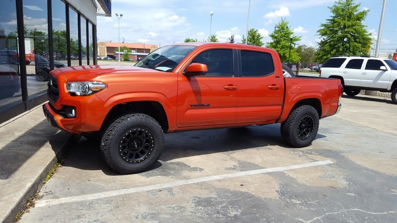

    2016 Inferno Tacoma SR5
    2" leveling kit 17x8.5 method race wheels general tires
    I installed the 2"leveling kit. Not a huge fan of it but it will do for the meantime till funds say otherwise. Here is a shot of my 16 Tacoma with 17x8.5 method race wheels.

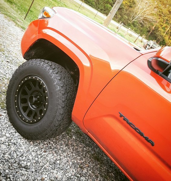

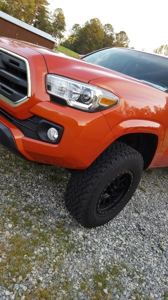

    Im running 265s and i think it leveled out pretty well. Id like to raise the rear an inch though. I do t recommend the 2"kit honestly. It is a temp till kind coilovers come i the mail. I couldnt pass them up at 50$
