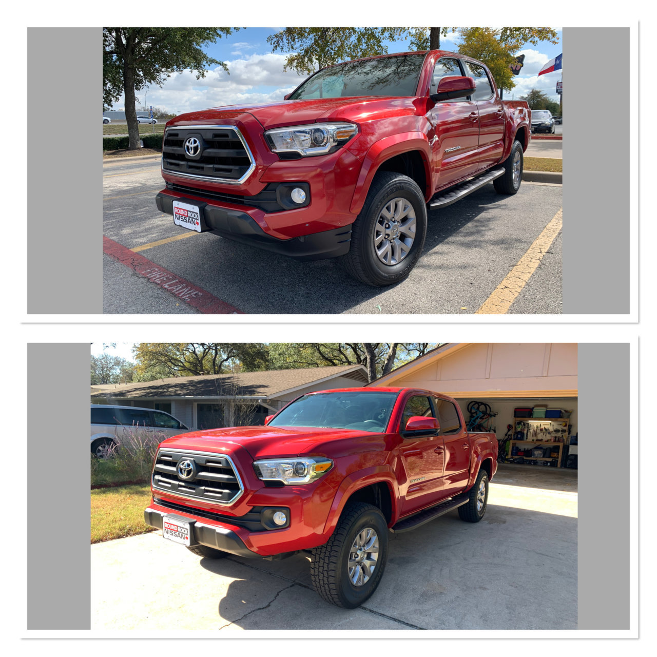

  16. Nov 22, 2020 at 6:02 AM
    #56
    dadbod512
    dadbod512 New Member
    Nov 22, 2020
    #347451
    2017 Tacoma SR5 RWD
    I just installed this on my 2017 RWD SR5. Took less than 3 hours in the garage, and I did have to grind the studs a little at the top. Ride quality hasn’t changed as far as I can tell. I put 265/75/16s under it too.
