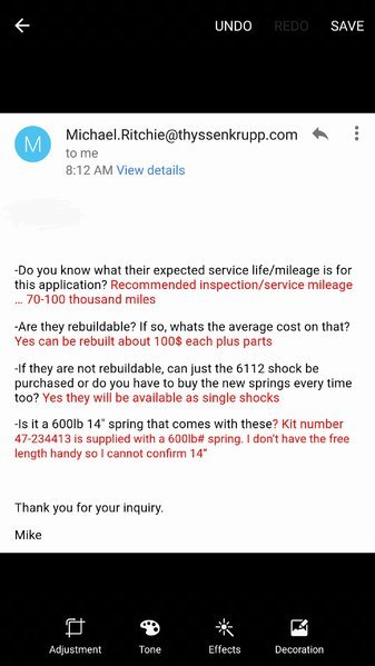

    Yeah I'd be interested to hear from them on this. I've talked with Mike Ritchie before and he was helpful on some questions I had regarding the 5160s.

    OK, talked to Mark Waite, he was in Moab over the last week. He confirmed they are 600lb springs but he stated that if under full preload, clips on 6&5 (i know you know but for other readers), then its the respective equivalent to a 650lb spring.

    Wasn't sure if I shared this here or not
