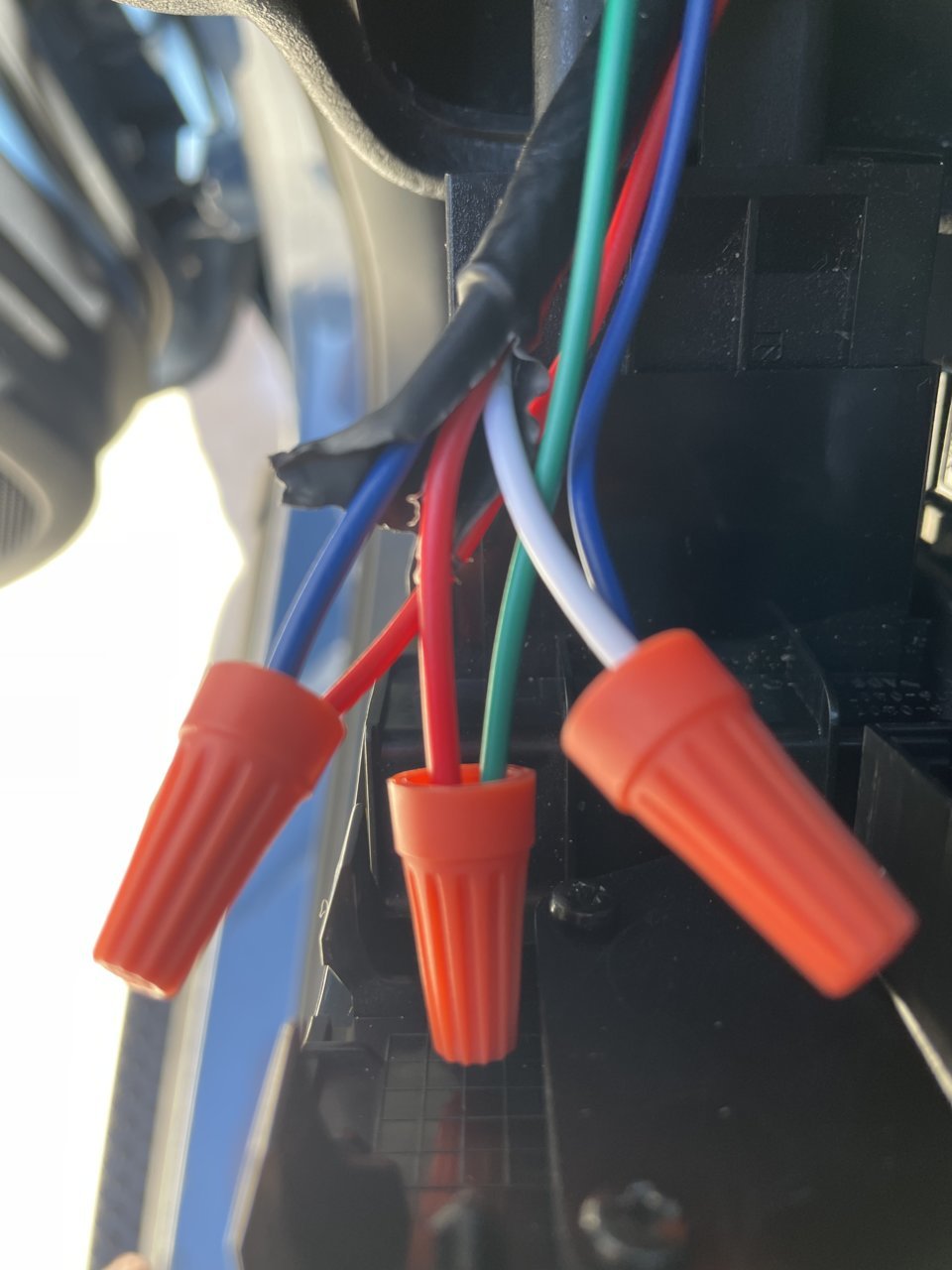

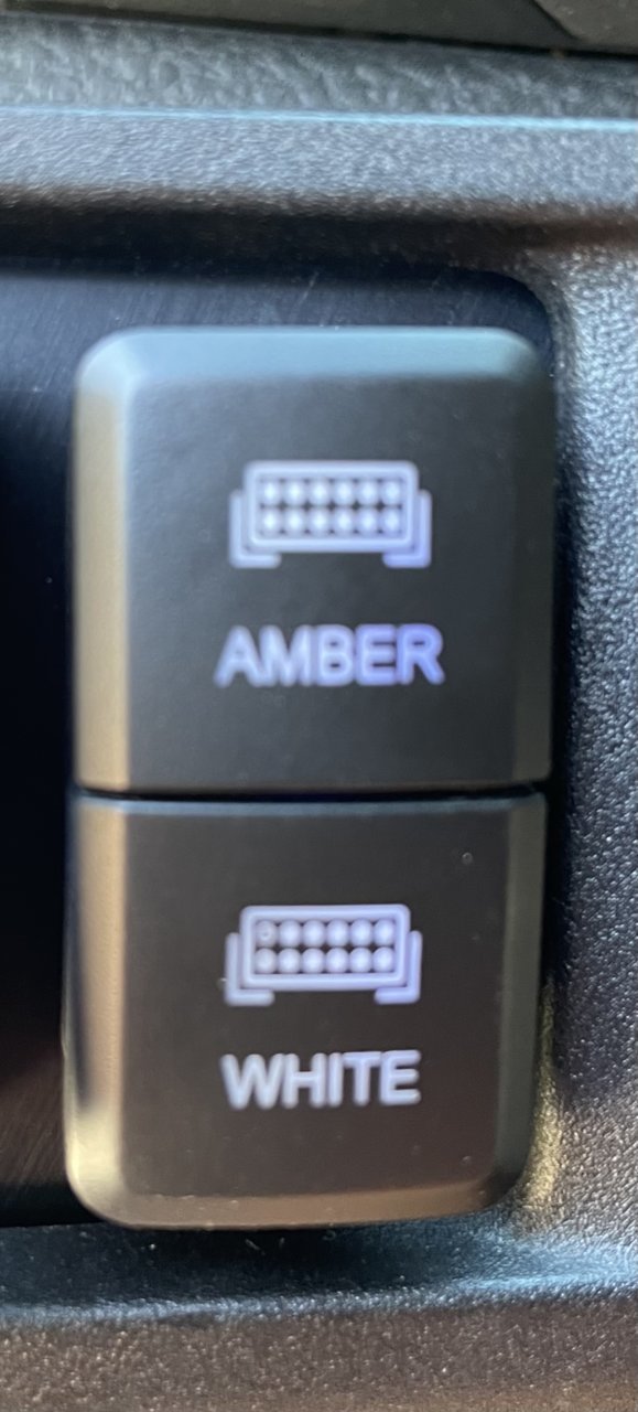

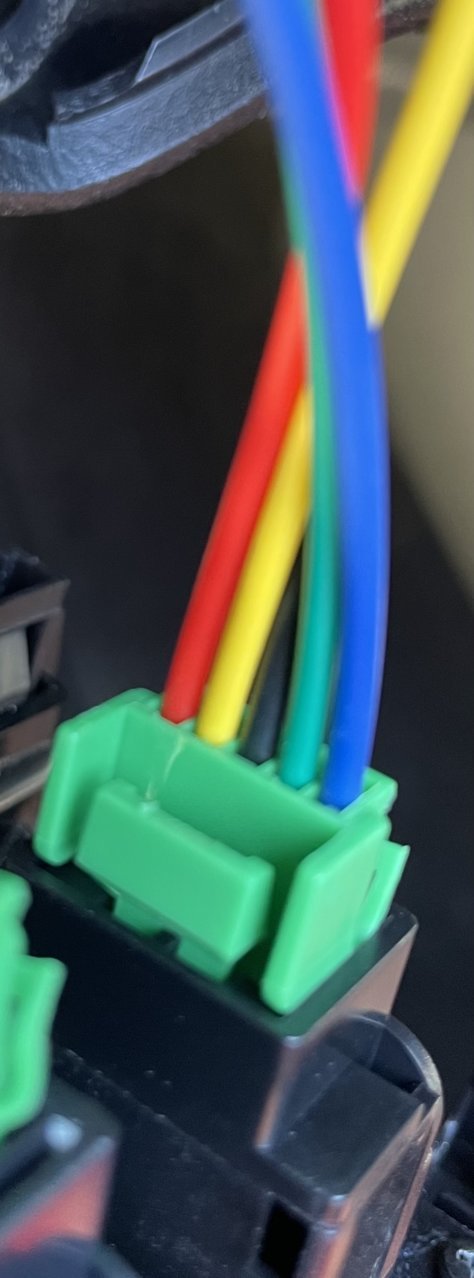

    Has anyone successfully used the Cali raised dual light bar switch to power their rough country 20” dual row crew light bar? I’ve hooked everything up, but the amber switch won’t turn on the amber DRL. I had a replacement switch sent to me, but the replacement switch is doing the exact same thing. I’ve attached pictures how I’m wiring the switch. (From the switch): Black is going to ground, Yellow going to dash light power source, Green going to light bar voltage (red), Blue going to white led line (white), Red going to amber led line (blue). If I switch the Red and Blue wires coming from the switch, the white led button will power the amber light, but the white led button wont power the white light. It seems like the amber button is bad, but I doubt I’ve received 2 faulty switches in a row… any help is greatly appreciated.

    Remove the switch and test the continuity of the wires of the switch. Sometimes the legend is incorrect.

    Yeah, I tried that and I’m getting the same results as the first switch (no continuity for the amber line). I wasn’t able to find a diagram or pin out for the switch, so I’ll probably try calling Cali Raised again and see if they have the pin outs for the switch and see if I’m making the wrong assumption on one of the wires.

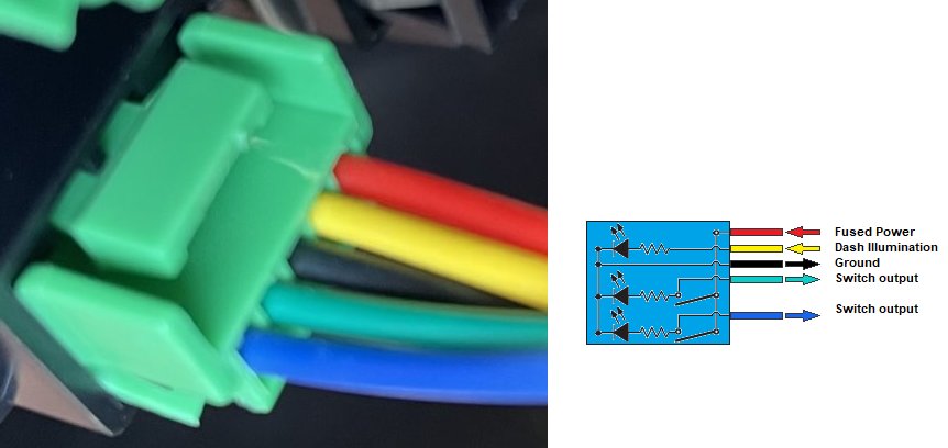

    Different color wires, but should be same configuration:
    Yellow is switch illumination.

    Thanks, I got it working. Your diagram was correct, blue and green ended up being the switches for each light. I had blue and red connecting to each lamp when red was for power.

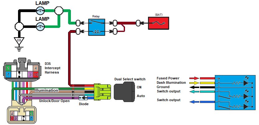

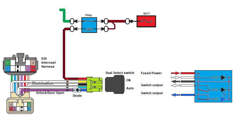

    So the setup is this then:

    Did you mate the switch ground to the dash illumination beige wire?

    If you want to add some lamps to turn ON when you unlock and/or open the door and also ON anytime:
    @kmorgan3 can sell you the D35 intercept...
  14. Nov 2, 2021 at 11:49 AM
    kmorgan3
    kmorgan3 Redside Electric, LLC | VLEDS
    Aug 22, 2019
    #302994
    1,952
    Kyle
    PNW
    2020 4Runner SR5 Premium | RAM 1500
    This should work great, but the indicator LEDs may not function if you're using (-) as the inputs to the switch. Might actually be an added bonus as the indicator LED would be a nuisance when in AUTO all the time.
