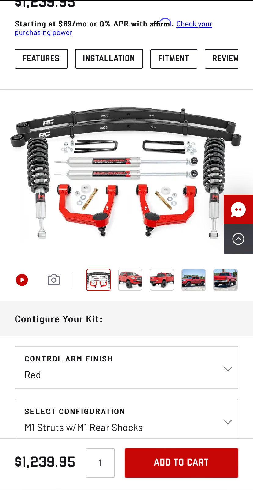

    The 3.5 inch lift kit from rough country is looking very appealing for the price:yay:. Does anyone have experience with this? Is it a good purchase and if so what else needs to be changed on the truck with a 3.5 inch lift ( besides what they provide obviously)
    If you have this kit installed some pics would be awesome :D

    Just an opinion --
    Concerning Rough Country products, in general, I adopt a "Frankie Goes to Hollywood" attitude.
    Relax, don't do it.

    Just to elaborate a little,
    That kit does not have drop brackets. 3.5" is MUCH too much lift without brackets that correct the geometry of your suspension (be ready for annual CV joint boot replacements, and possibly steering rack rebuilds too if you use that kit. Also a degraded ride).
    This is why Rough Country gets a bad rap around these parts. Not everything of RC is garbage (their Vertex shocks are decent for the price), but some things should be avoided (this is one of them).
    2" is the generally-accepted maximum height to keep things relatively trouble-free when lifting with simple shock/UCA lifts.
    I would suggest looking into the Bilstein 5100 or 6112/5160 setups. These aren't overly expensive and actually improve the ride & handling over stock, but again you gotta keep it 2" or less to get the best results.
