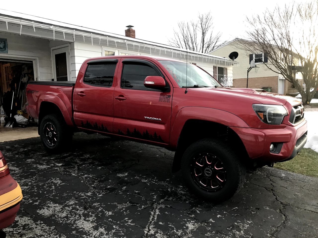

    As a Christmas present I had a Rough Country 3.5" lift installed in her 2012 DCSB Sport. She told me that I was not installing the lift which I could have done. Still has the 265/65R17 Cooper Discoverer AT3 which are about half tread.IMG_1211.HEIC.jpg IMG_1212.HEIC.jpg

    I'm being presented with the same Rough Country 3.5 in lift kit. It's been a year, how's it treating you? I don't run my taco too hard, what concerns do you guys have with this kit?
    Rough country kit: RC- 74232

    I've added the Headstrong 1.5" aal to raise the rear so it isn't sagging (kept the spacer from the lift). Just replaced the bushings on the top of the rear shocks because the lower top ones were about gone (thinking these were over tightened when the lift was installed). The driveshaft shimmey on pull out is a little more noticable. I haven't done anything to try to eliminate it. Truck is strickly street driven.
