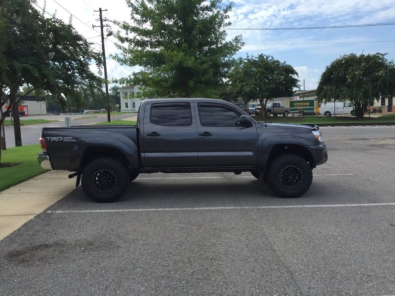

    image.jpg image.jpg I'm running a 3 inch toytec spacer lift with 1.5 inch blocks in the back. No complaints at all. I'll eventually get a OME lift but this is fine for the time being. I have 265/75/16 tires. Would be higher with 285s.

    NO NO NO NO NO NO NO NO NO NO NO NO NO NO NO

    Yes and no, to you and OP. Spacer lifts weaken the strut severely making it prone to breaking on forest service roads even. Higher you go the worse it is.
    Blocks are bad because they increase axle wrap, in turn destroying your rear end, but also flatten out your leaf springs a lot quicker. Same as spacers, bigger the block the worse it is
