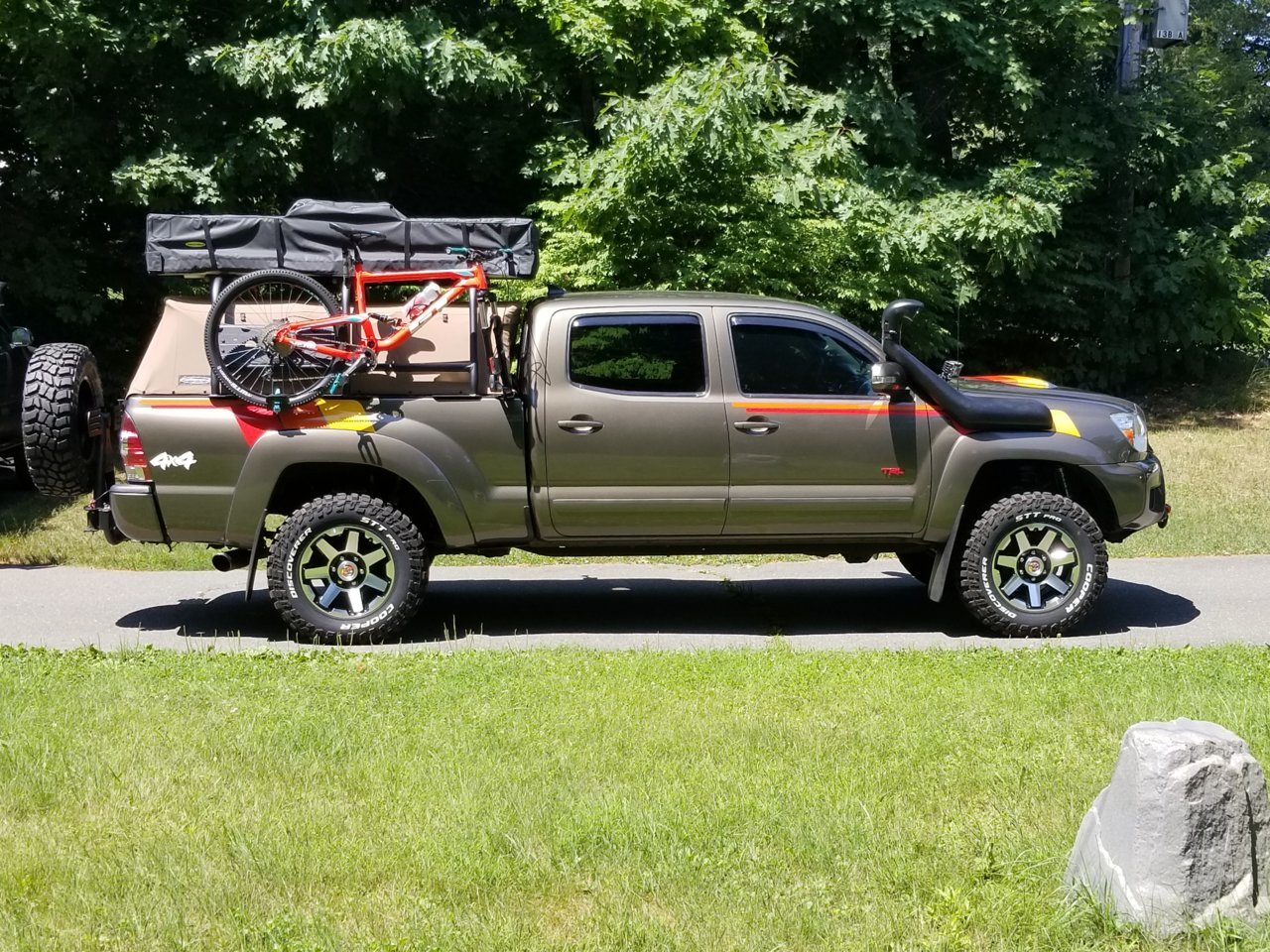

    I started off with just 5100's in the front on stock coils. Then went OME 887's on 5100's up front for 3 inches, and 5100's in the rear with an ICON 3 Leaf Progressive AAL overload in for 2 inches. I still have the ICON 3 Leaf on but have upgraded to overkill KINGS Extended Travel front and rear with resi's. I have waiting to go in an ICON RXT Leaf Pack on the #2 setting as I have a an RTT with a Bed Rack over my Softopper and a fridge/freezer in the bed. I also have a 2nd heavy ass NorthStar Battery in the bed that will be hooked up to Solar etc. Here is how it sits now with the rear a little lower which is why I am redoing the leaf springs, also have aftermarket JBA UCA's as it's recommended for lifts over 2.5 inches.
