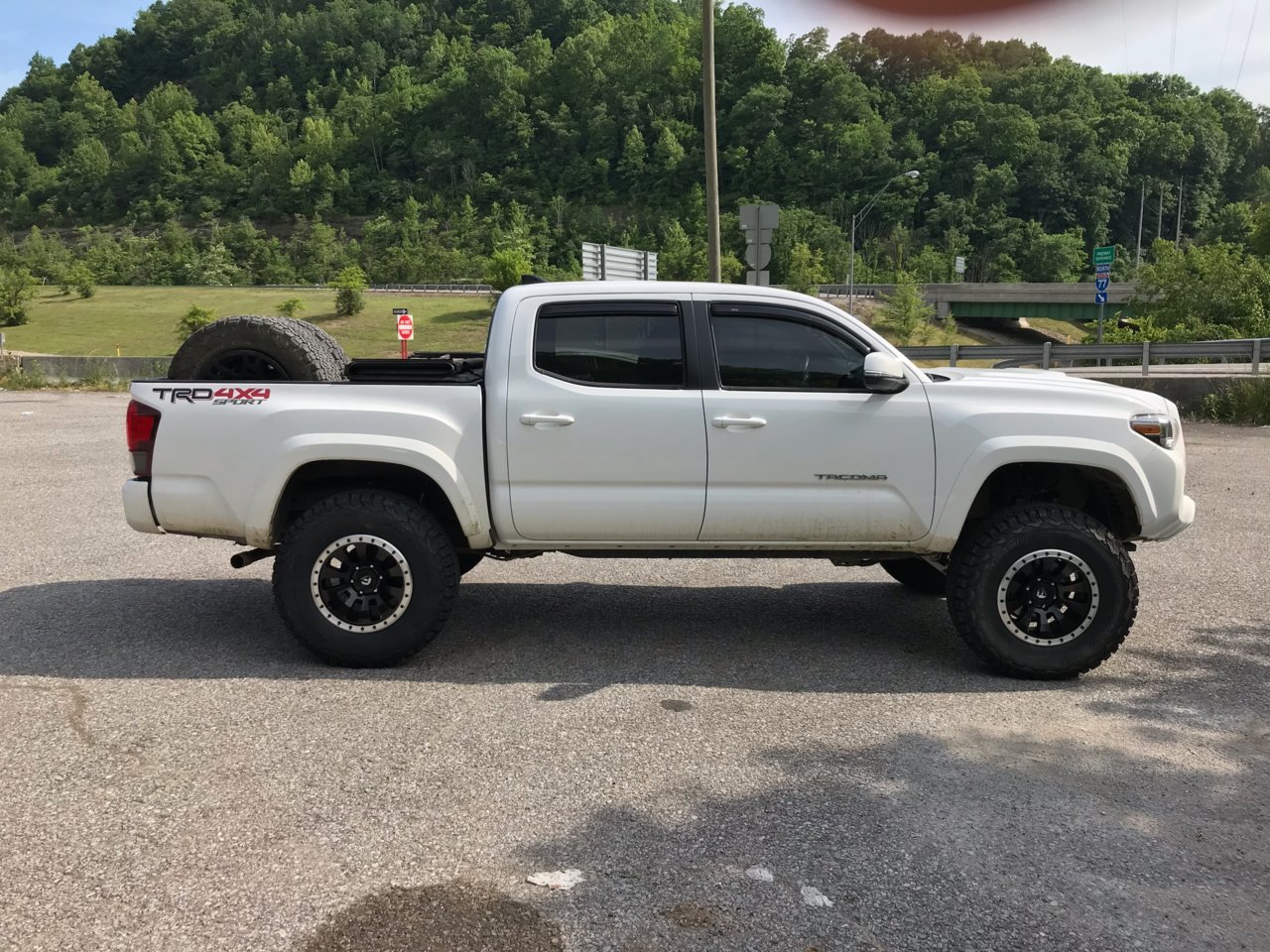

    Who’s got the 4 inch RC installed? Had mine done last weekend and I’m setting 1.75 inches low in the rear end. Anyone else with this problem?

    Can’t tell as much here but it sure did mine

    OP, did it get any better as you drove it more? I would assume that the front end will drop a bit after the springs wear in. Otherwise, you may have to counter it with a bumper and winch lol

    Only drove it about 400 so far, it drives good but first one I’ve seen that wasn’t level. I believe I’m gonna get the 4.5 inch blocks for the back that the 6 inch one comes with to get it back level. Bumper is a good idea though!

    Front should settle some more (maybe another .5-1”). Should be closer to level but I would still expect it to be a bit higher afterwards.
    Is there an AAL or a completely new leaf pack in that kit?

    I sure hope you’re right! Nope there sure isn’t just the 2.5 inch blocks in rear
