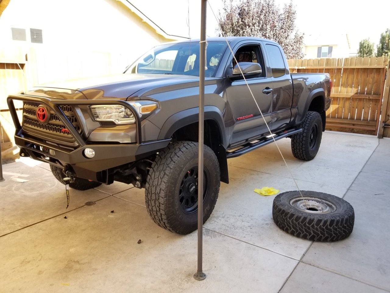

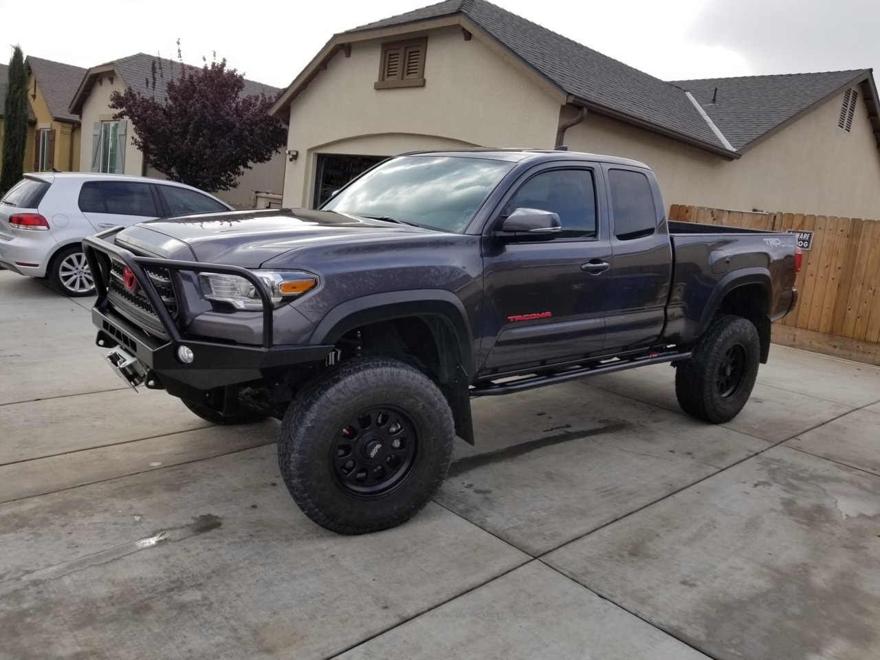

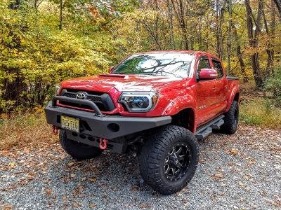

    SWEET! You going about an extra inch to compensate for the weight of the winch bumper? Any pics how she sits?

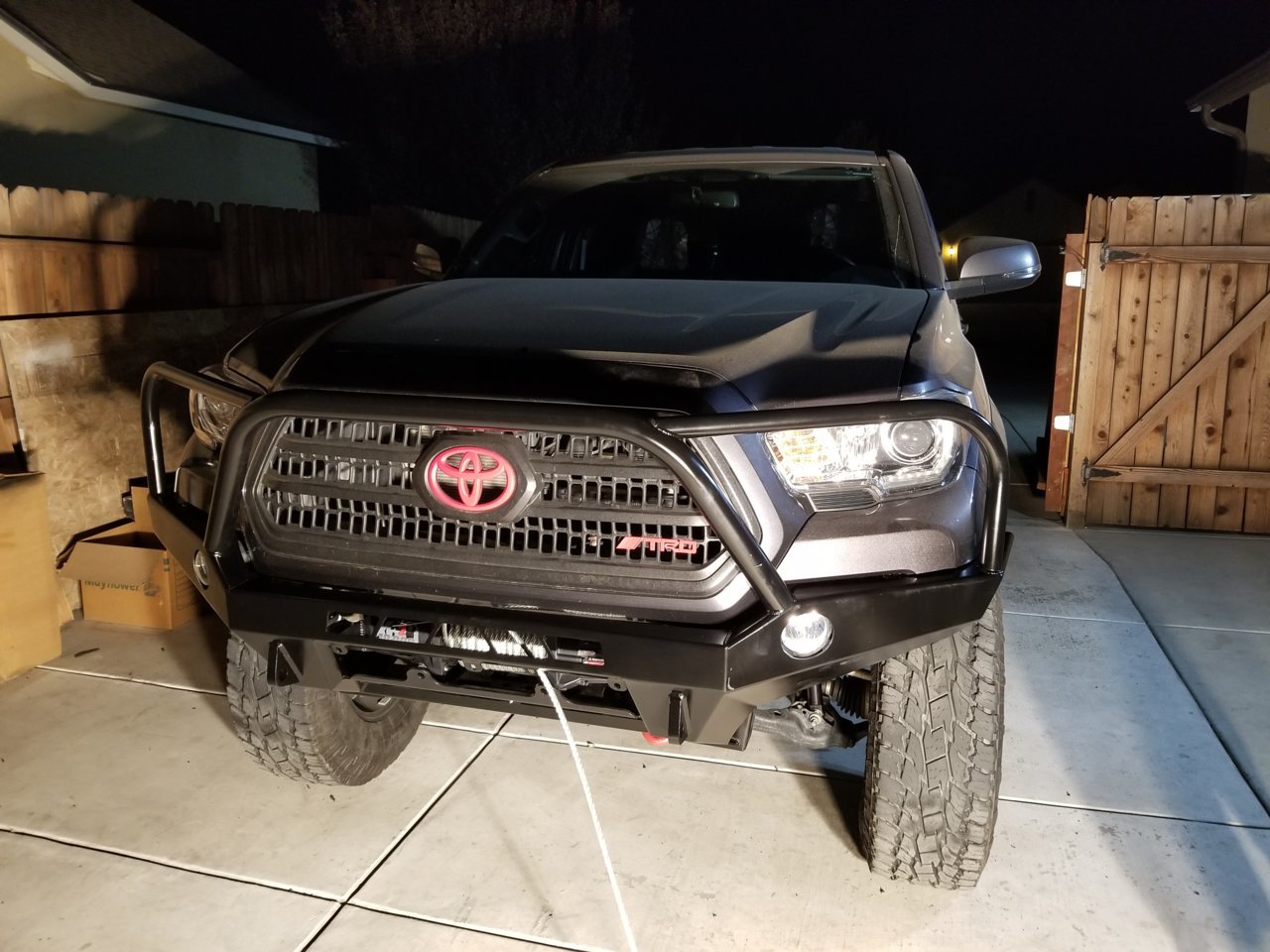

    Here's the best picture for now. Got the winch all hooked up, the truck is only sitting about a 1/2 " lower with the bumper and winch right now. I'm gonna drive it around tomorrow and see how much it settles. I was honestly expecting it to say a lot more than that haha20181014_214726.jpg

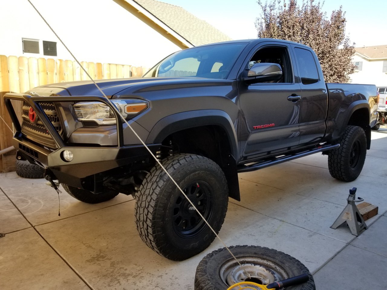

    Heres how it sits before the adjustment to get it where I want. Now it's down q full inch in the front after driving around for a bit

    Cranked the front end up another 2 inches.

    Sits great up the 2 inches, looks level. Bumper is bad ass too!

    Thanks man! It has a 1" rake as it sits right now. It's at 42" ground to fender in the front and 43" in the back

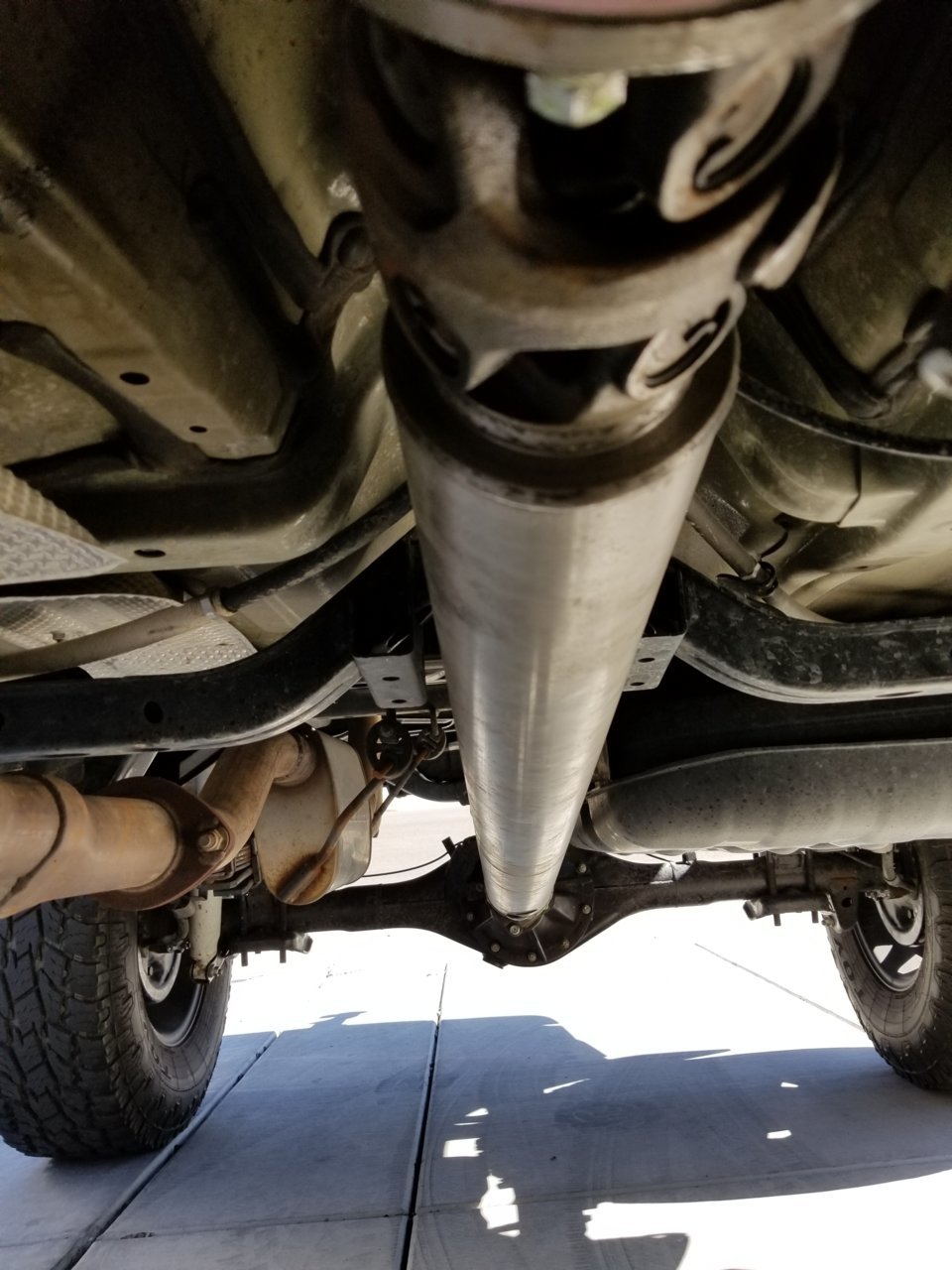

    It's not an extended drive shaft, buy it is a custom double cardin from tom woods. All you have to do is measure from the transfer case flange to the rear flange on the third member. Use that when placing your order.

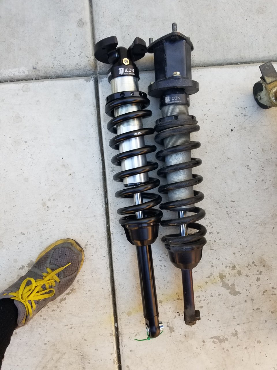

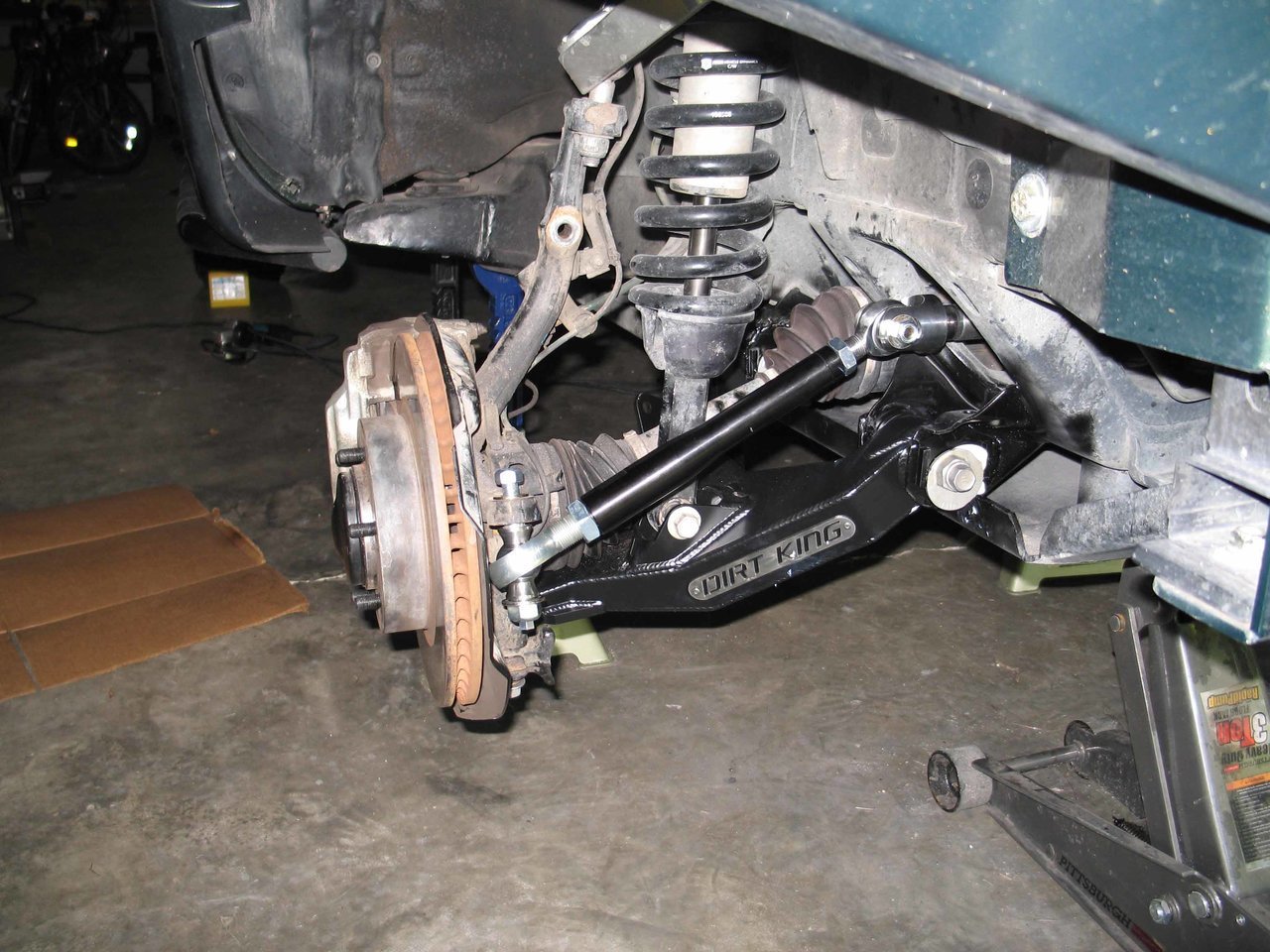

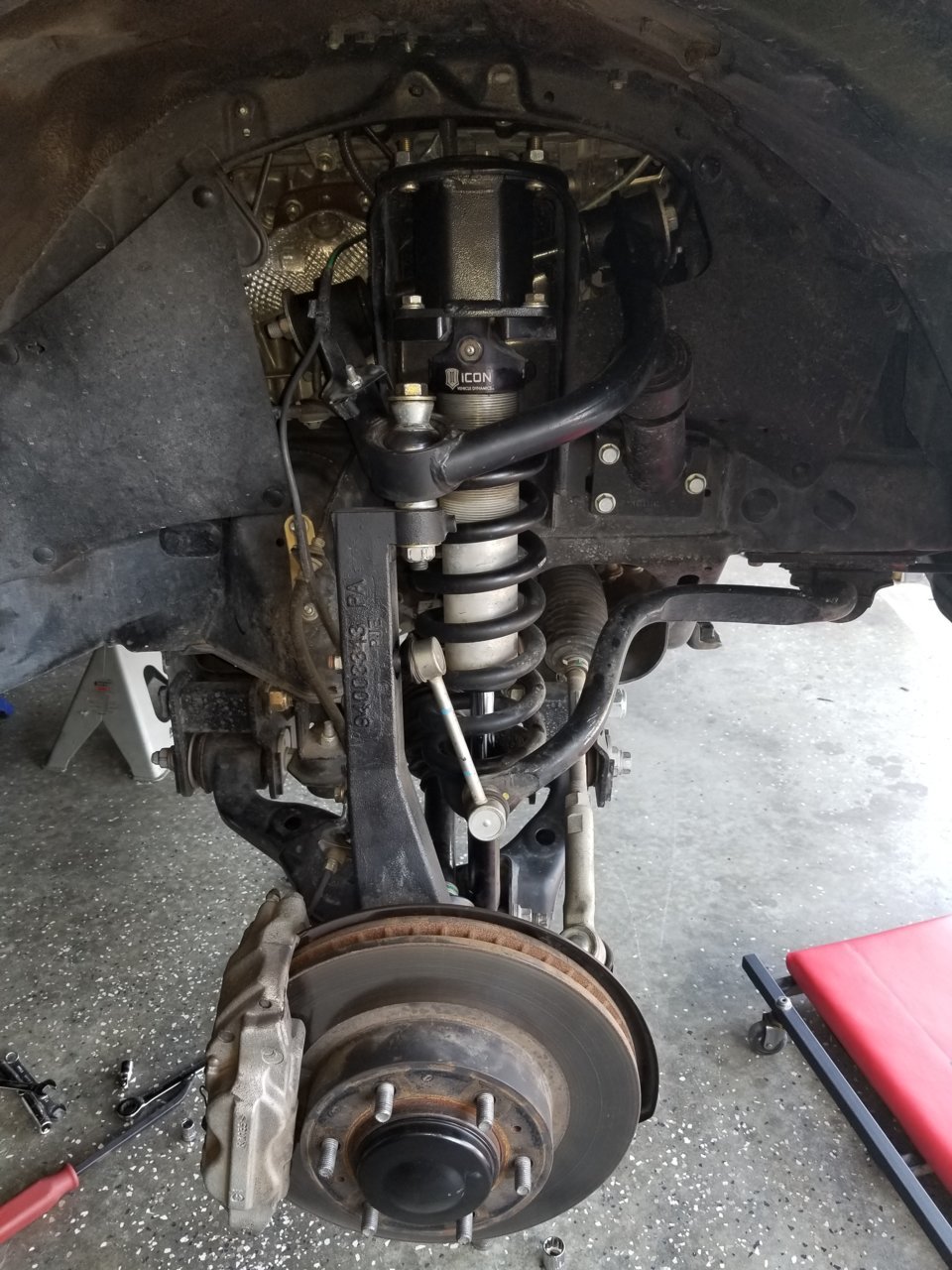

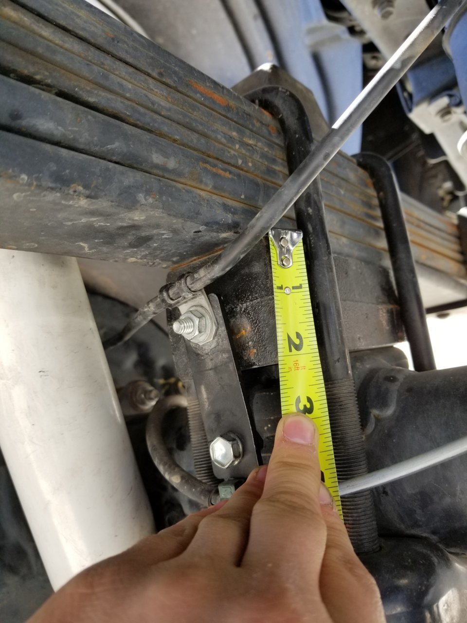

    You may need a shackle flip like I have in the back end. That combined with the leaf packs should have you sitting between 5-6" in the back. As far as the front and rear shocks go, icon has some 6" versions of their shocks available. The rough country skid plate works with pretty much anything that you put on the truck too. The lower control arms and tie rods shouldn't cause any issues either.

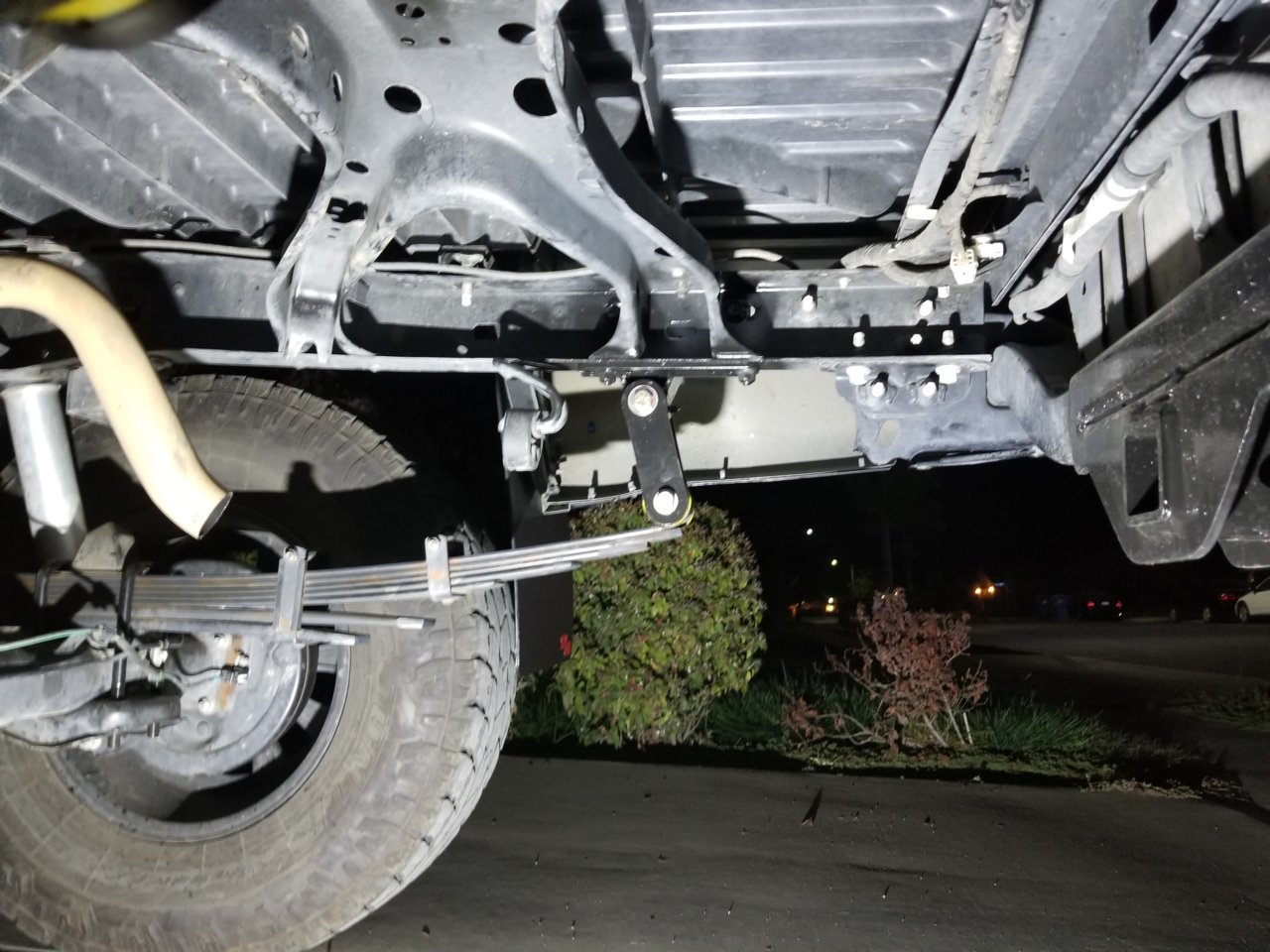

    This is a picture of my setup with one leaf packs and before the shackle flip. I went with archive garage for it and it gave me 2" of lift.

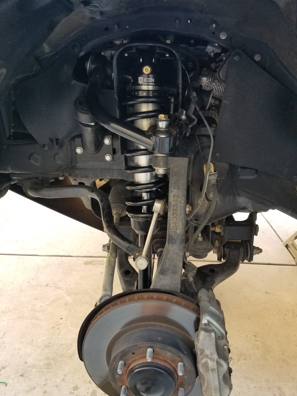

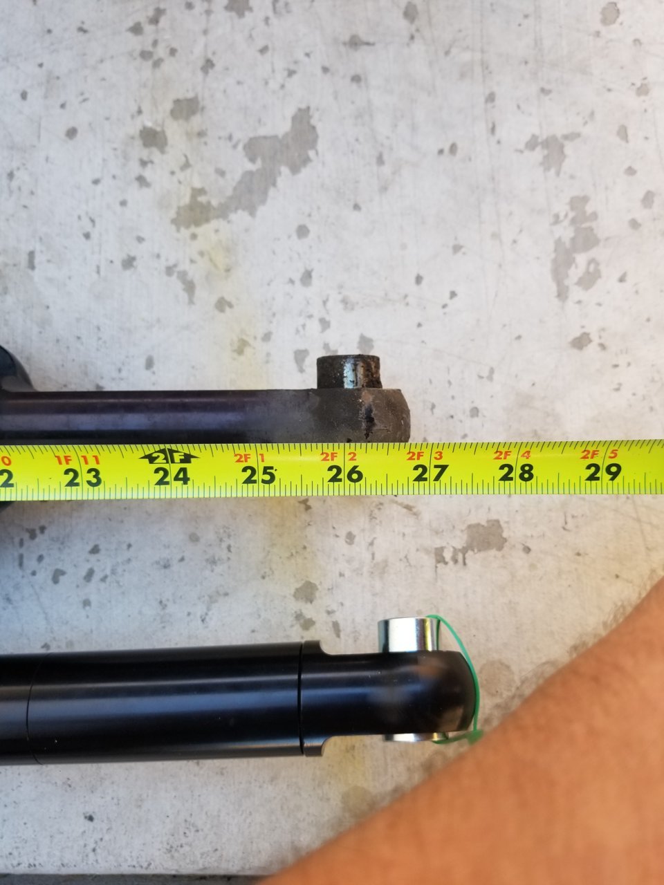

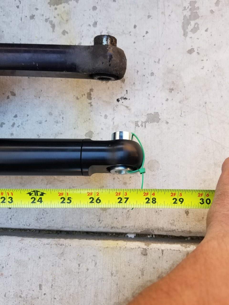

    Here's a picture of some standard icon 2.5 front coilovers with a 4" spacer next to the 6" icons.
    Heres a picture of the shacke flip with the ome Dakar cs047r leaf packs.
    Before and after the 6" icons
    Heres a picture of the Tom woods drive shaft

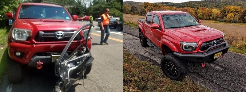

    Had a fender bender!

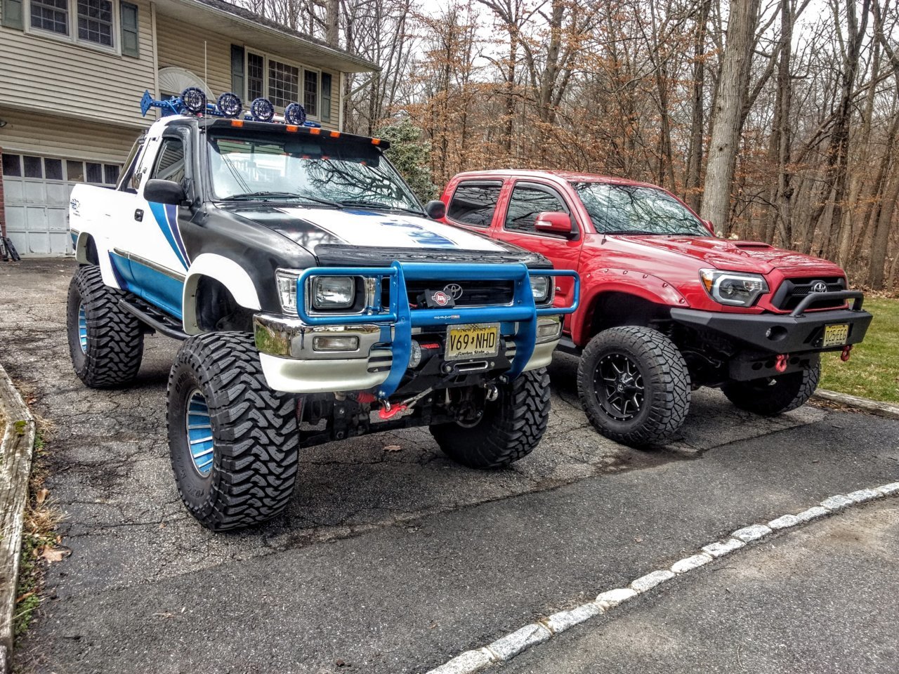

    And a pic with my 91, it has a Rough Country 5" lift, Yukon 5.29's, Yukon Grizzly in the rear and Truetrac up front!
