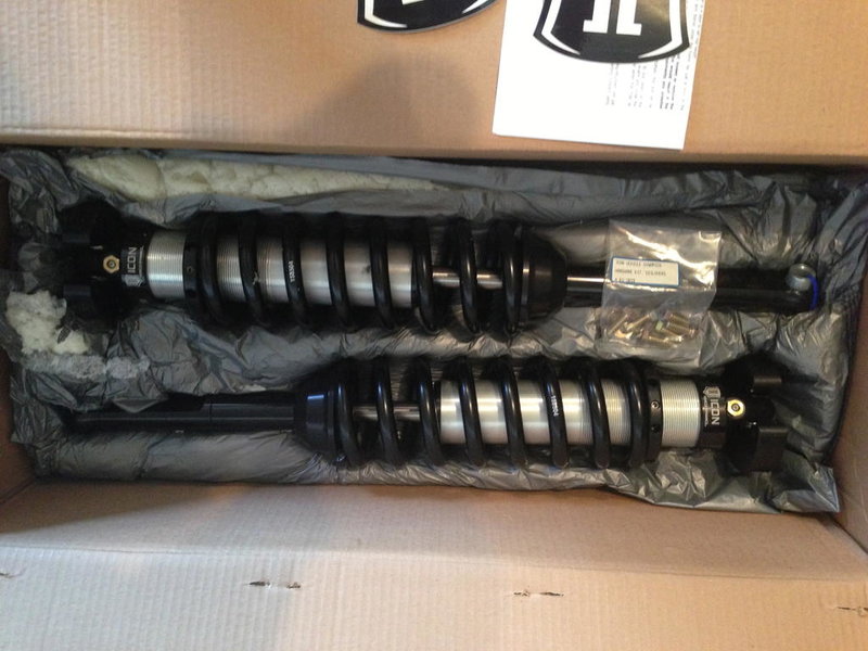

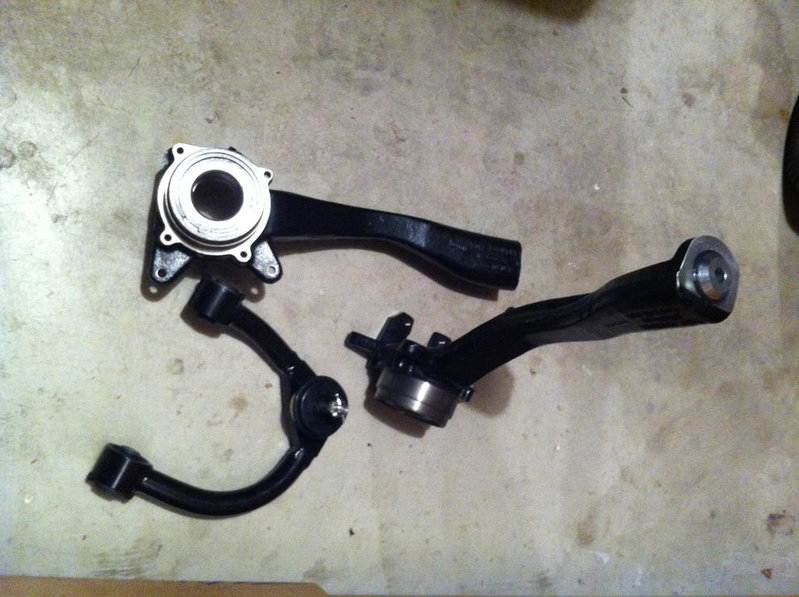

    02 4DR Taco TDR Supercharged SR5 6in lift
    12" Icon 2.5 coilovers, 6" Drop Bracket, Tuff Country 5" lift knuckles, Icon 4''-8'' Extended Coilovers, Light Racing upper control arms, 7" Alcan leafs, 13" icon 2.0 smooth bodies in the rear. 2.5" exhaust with Magnaflow cats and Thrush muffler. 295x75x16 AT's (34.4") Superchargers Other shit like rear breather mod relocate, gray wire mod, intake elbow removed, led's, toolbox, etc
    After going through pretty much issue you can have in a front end, i'll tell you that spacers are shitty. They move ALL of your suspension to the bottom causing parts to wear out quick and become stiff.
    If you are going to do a DB Kit, get the kit, but throw the spacer out, and buy coil over! You are wasting the lift without them. Spacer kits are for "Mall Crawlers".. Icon, Fox, King, Camburg, All Pro.. etc. They aren't cheap, anywhere from $750 set to $3,000+ a set. The difference is incredible.
    I purchased mine through downsouthmotorsports for $1,150 for the pair. they have a page on here. I have custom ordered Icon Extended coil overs adjustable from 4-8'' lifts (they said) but i have mine set almost all the way down and I'm above 6" lift. They have a 2.5'' Shock body. You can add reserves if you want them.
    I have Toytec UCA which are adjustable (need if you want to align it afterwards)
    My spindles are Tuff Country (not ruff). They are super beefy and extend higher to compensate for the DB. Spent around $1,100 for the pair.
    Was it worth it? Hell yeah!
    I realize I have a 1st gen and you are asking about 2nd gen, but the truths hold the same for both gens.

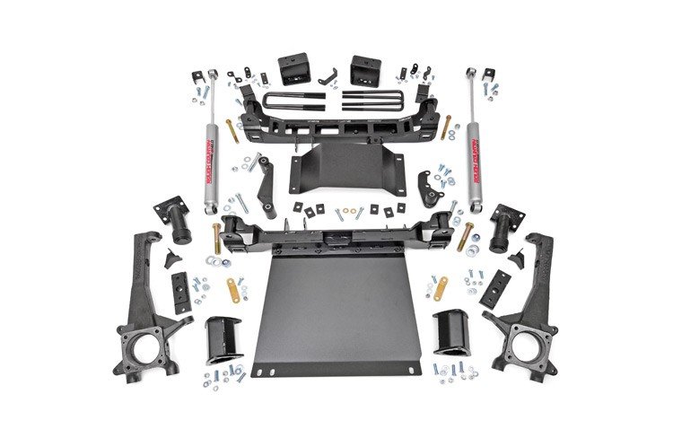

    13
    2010 toyota tacoma trd off road
    6" rough country lift

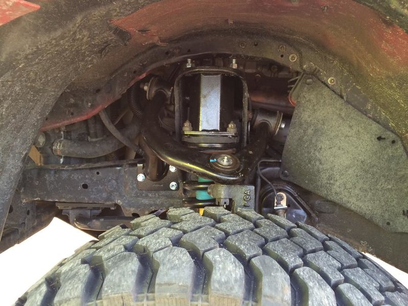

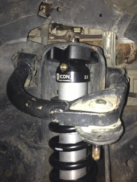

    I have this 6" lift on my 2010 tacoma and the uca are hitting springs on flat ground. Help please
    You need aftermarket UCAs and less preload on your front coils. Sounds like you have almost zero down travel, which is no bueno.

    post some pics of this

    Rough country six inch lift 325 65 18 cooper stt 18 moto metal 955 In channel visors Billet grille Alpine door speakers two kicker 10s
    Need pics but sounds like they are installed backwards

    13
    Im not sure how to send photos but i tried on this post let me kno if you guys see it

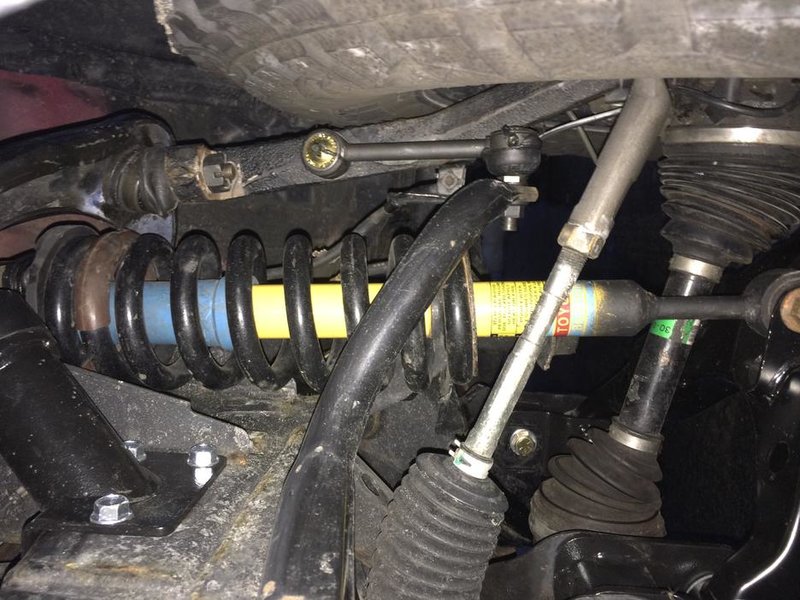

    Heres another one

    2020 TACOMA TRD SPORT DCLB LIFTED W KDMAX-PRO XT TUNE
    FULLY LOADED WITH THE TECH PACKAGE, LEATHER, JBL, LED HEADLIGHTS, MOONROOF, EXTANG FULL TILT COVER, NFAB SIDE STEPS, OEM ROOF RACK, TRD PRO TAILS, WHITE RAPTOR LIGHTS, 15% TINT ALL THE WAY AROUND, BILSTEIN 6112'S W 650# SPRINGS AND 1/4 SPACER, ICON LEAF SPRINGS W 5125 REAR SHOCKS, 18 x 9 -12 Weld Racing Ledge 6 wheels w 275/65r18 Toyo AT III tires
    Do you have a front view of the spindle assy. Your uca def shouldn't be that far down.

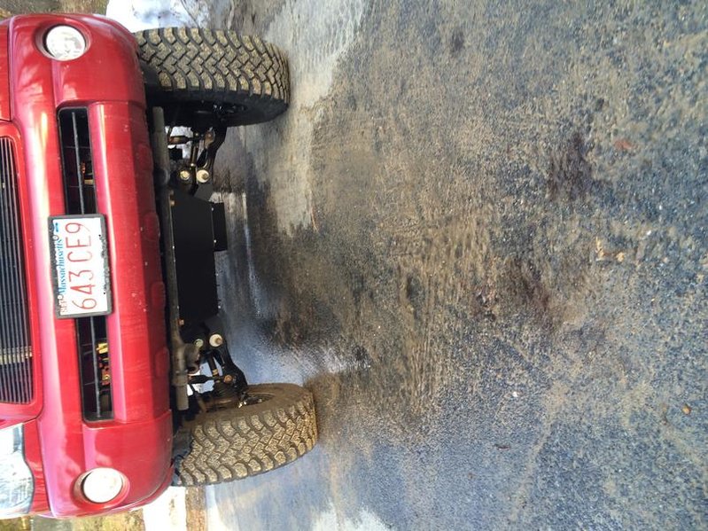

    Sorry that it is dark out
    Another front
    As long as those are your factory shocks/coils you shouldn't be getting angles like that. On the db lift your cv should be close to stock angles. You don't have any additional preload spacers on those coils in addition to the rc top hat spacer do you? From your cv angles looks like you are getting and additional 3" of lift on top of the rc lift somehow.
    If you wouldn't mind measure that top hat spacer.
    The spacer measures 5". Everything is stock coils, shocks everything. No extra spacers the only thing i can think of is the trd stock shocks are alittle bigger then the stock base shocks. Idk why its an additional 3" witch makes it a 9" in front. I dont get it.

    Florida
    The spring perch on the lower part of the shock isn't on upside down is it?
    Or one possibility might be that if you look at the picture of the spacers below notice they are tapered. I believe the they should be mounted tapering in towards the truck. If on backwards that could cause your additional lift. Either way you might want to call rough country.
    What do you mean the perch on the bottom of the spring? The tappered part of the spacers are in toward the truck also so thoughs are right
