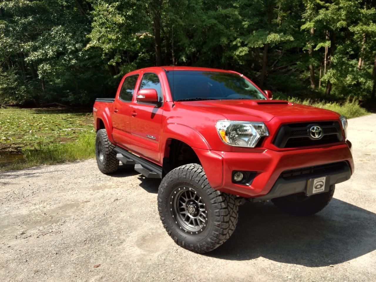

    Is this an active members truck? Curious about the N2O strut quality. From the youtube video of this truck seems like he has had it installed for awhile now.

    This is my sons truck. I just borrowed it to hit the park for a run yesterday and I love the ride! I also took it for some low key trail riding and I am actually waiting for a black regular cab to become available because I want to do the same build with the RC 6" strut lift. Probably going to add Brown's 1.5" body lift and I am thinking retro decals too, different style to fit a Tacoma, dacals from the early 80's SR5 truck.

    When we installed the Rough Country 6" lift we were able to mount the 16X8 Raceline Raptor wheels with 4.5" back spacing with 33X12.5R16 MTX P3's. My son would have preferred a 16" wheel but already had the 17's because RC had 17's for specs.

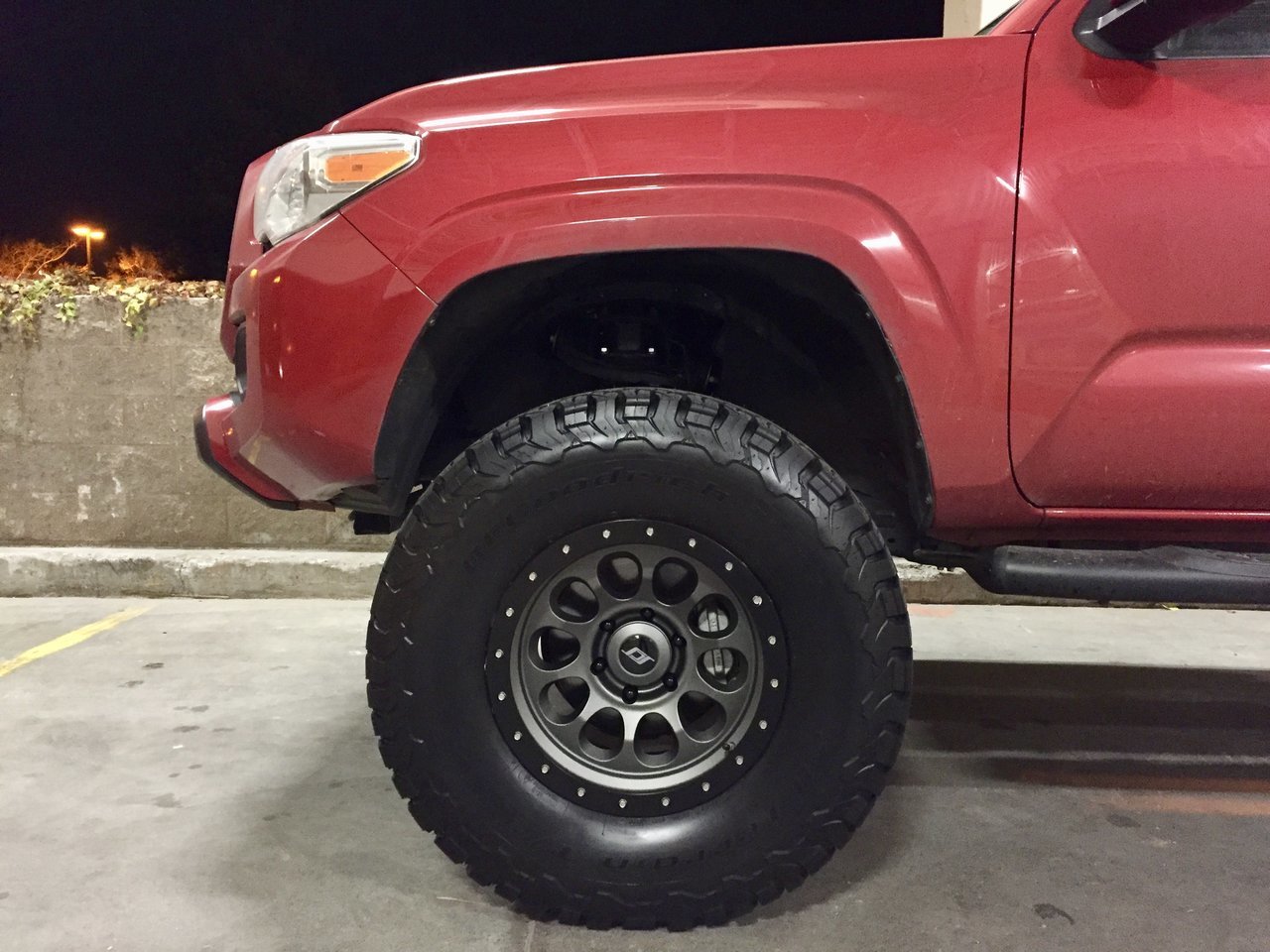

    That pic I have 295/75/16's with 1.25" wheel spacers. They are e-rated and rode really rough and we're really heavy.
    I've since switched to c-rated 315's (35s) they ride much better, and I think they are lighter.

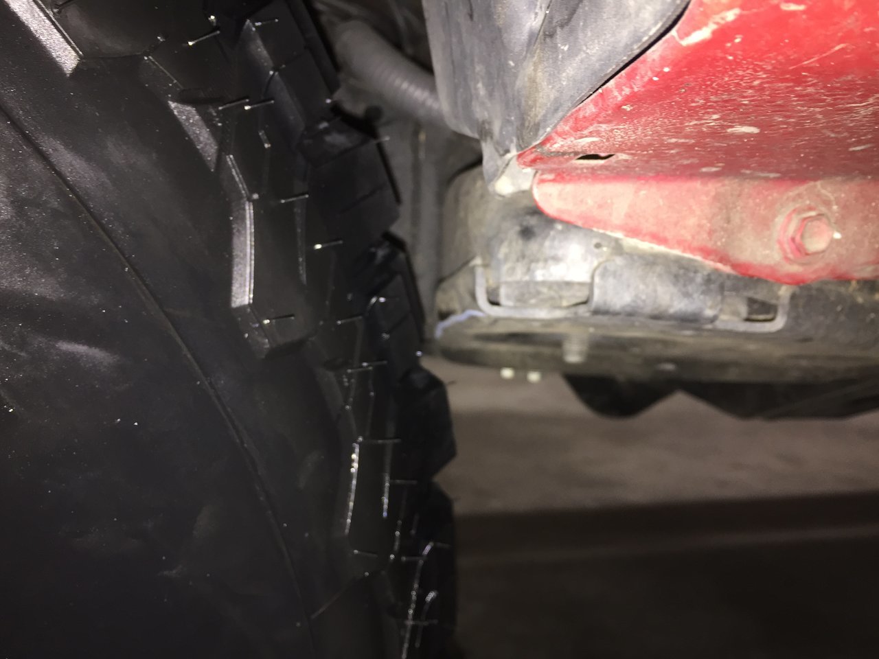

    They do rub when fully turned, but only when flexing. Normal driving isn't an issue. The RC drop brackets move the LCA 1/4" forwards, doesn't sound like a lot, but at full steer, not flexed, I have about 1/4" of clearance :rofl:

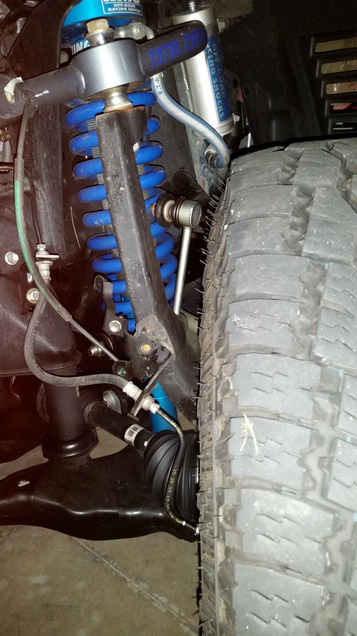

    20171027_172100.jpg I have the 6" tuff country lift. Problem is the way the sway bar links atach to the knuckle, they rub the inside of the tire at full lock even with the 4.5 bs wheels that I have, and a 1" spacer with only 285's. The links connect low on the knuckle then go up and connect the sway bar. Most othe knuckles I have seen including rough country connect high on the knuckle then aim down to connect with the sway bar. I am thinking I should be able to swap out the knuckles with a set from rough countries lift and take care of the problem. Any thoughts on my little plan?

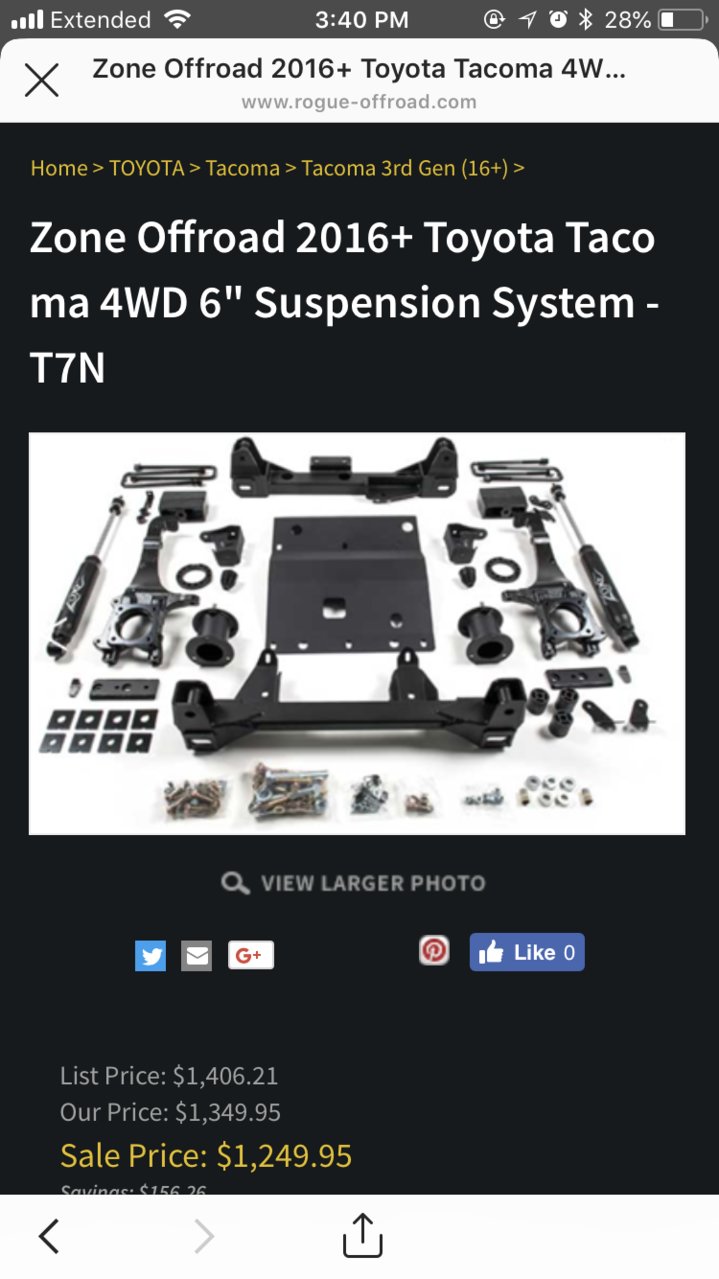

    What’s wrong with zone lift ? Are they not worth the pay and quality

    Nothing at all. Basically they are identical to BDS.

    in the jeep world zone is comparable to rough country
