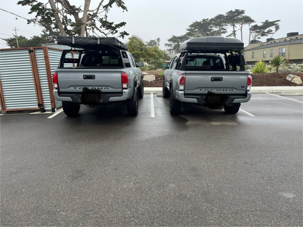

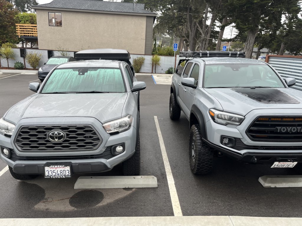

    I’ve got the rough country on. I think the line up is intentionally tight because they don’t use adhesive at the top. I thought I could get away with 15 minutes per flare and that would be fine. Turned into about an hour per each. Brutal install. The rubber trim has an orientation that I may have fucked up on the first flare. They do look decent though. IMG_1785.jpgThat’s my truck on the right and some fool I don’t know the left. My front bumper is the greenlane off-road stump with wings, it sticks out to the side about half inch or so, rough country flare lines up pretty well with it. IMG_1788.jpgI now have an rci high clearance bumper. But it’s a subtle change. Like I did some pushups in the alley before I went in the club. Lol
    Also have a decent amount of poke, sema wheel with spidertrax 1.25” spacers.
