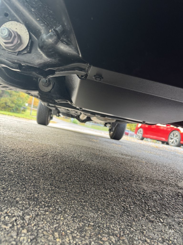

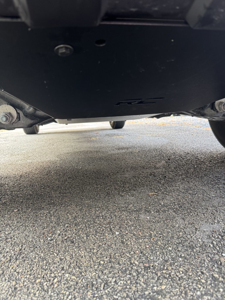

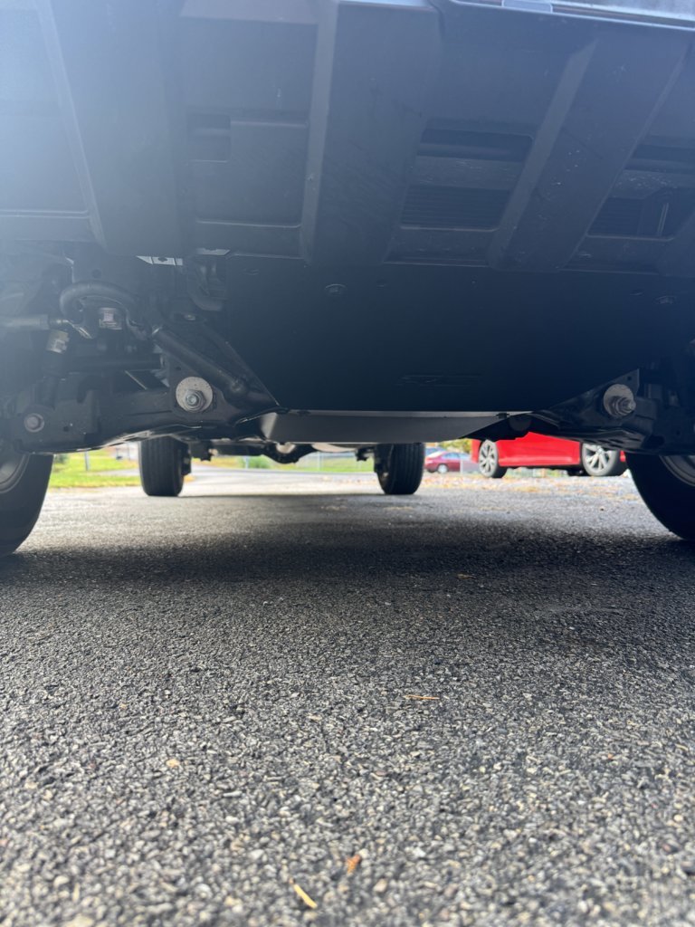

    So the wife bought me the skid plate kit. For 149.00 I don’t think you can beat it. It weighs around 30 pounds both plates total. It was a little bit of a pain in the butt to install by yourself even with the truck on jack stands. If you had a lift or a buddy with one it wouldn’t be an issue at all to install by yourself. It feels really strong and it’s around 1/8 inch thick so it definitely has a little bit of weight. So regardless of what others say I think it’s very good quality especially for the price. It’s not some kind of thin cheap sheet metal. Will try to post better pictures later.

    I'm a little OCD so I'd have to grind the welds off smooth and repaint before I could bolt anything on. And where would I get official Toyota frame paint from?

    Shouldn't be too hard to keyhole a couple of bolt holes like the Toyota plates if you need to pull them off frequently.
    Or replace a couple of bolts with studs.

    it would definitely make it easier to do exactly that keyhole or studs. You do have to take both plates off to change the oil but with that said I like the fact it wraps and covers everything oil pan, differential etc.
