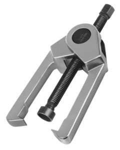

    You need to use a ball joint/tie rod puller.
    Similar to this:
