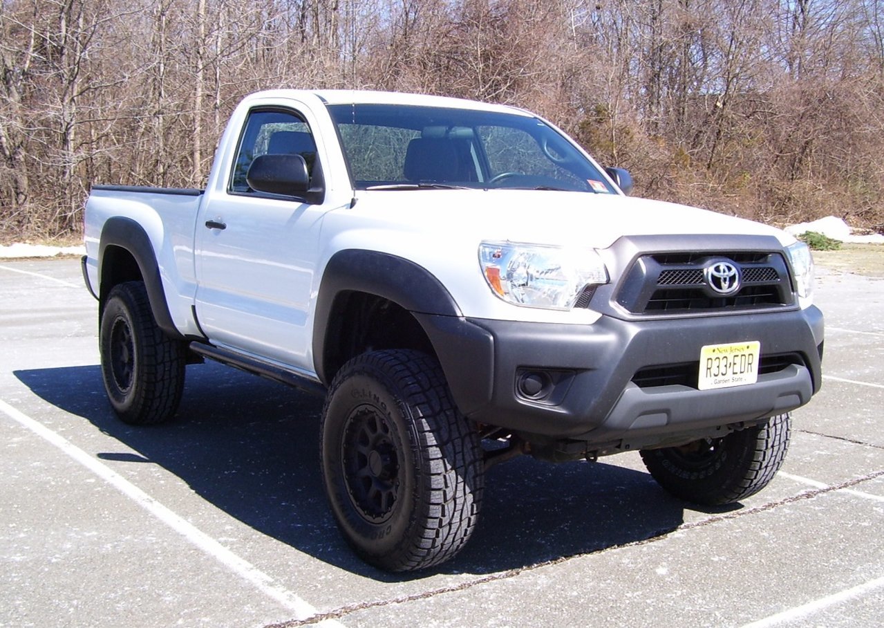

    I would prefer the taller strut/shock but it will still be pretty stiff. I think you want the 1/4" thick spacer that would give you roughly the 1/2" of lift. My truck had OME 885 springs and Nitro shocks with a 1/2" spacer when I got the truck. It was sitting around 4" which was too tall and caused severe cv angles which split one of the cv boots. I removed the spacer and that helped a lot. Does the RC 4" kit have drop brackets?

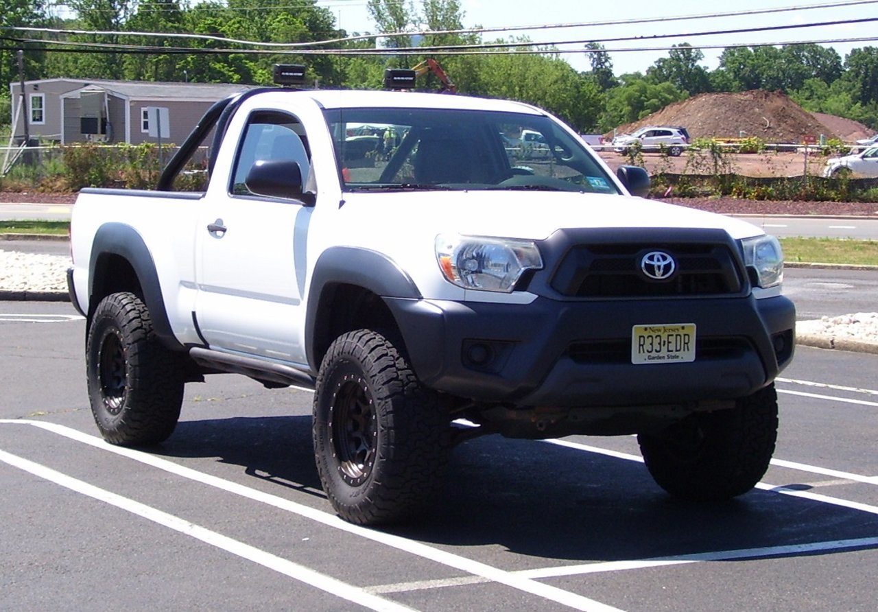

    I found a picture of my truck when I first got it with the 885 springs and 1/2" thick spacers which had the front lifted around 4". It can be done, I think RC probably says not to mess with it due to potential liability with the lift kit. The RC kit has the taller steering knuckles but I don't know if that would have any affect.

    I changed out the wheels/tires, lowered the front to help the cv angles and added the rollbar. But I sold the truck earlier this year. Which brand coils/shocks were you looking at for the 3.5" of lift, most of them seem to be around 3" on the Access Cab or Double Cab trucks. A reg cab might get more lift because of less weight.
