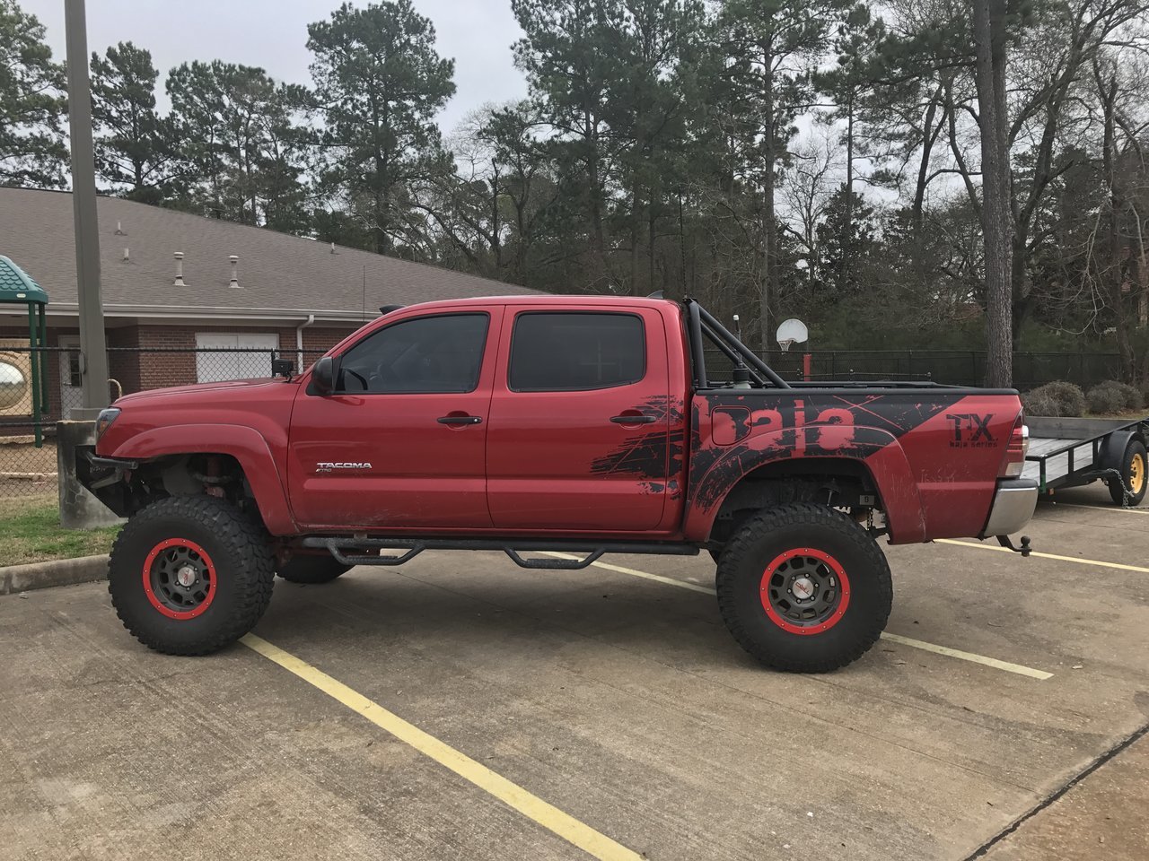

    2012 Toyota Tacoma baja
    6inch lift sitting on bilstein coilovers. Lexus is300 studs in front to keep stock wheels, general grabber red letters, nfab front bumper.
    I kept the 16s with my fabtech lift
  13. Feb 12, 2018 at 6:44 PM
    #33
    Tacohago
    Tacohago [OP] Well-Known Member
    Feb 13, 2017
    #210498
    275
    Jake
    2009 Toyota Tacoma TRD
    That’ thing is sick
