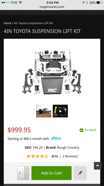

    Looking for info on the rough country 4in suspension lift. Anyone have it? Anyone had it and hated it? Good bad ugly??? I'm looking for it all. Pics? I'm new to all this so any good info will help.

    It's a drop bracket lift. You will have to cut the front crossmember to install it.

    3" > 4" not really worth the extra inch for a DB lift kit. Plus you get more clearance with a 3" lift over a 4" :anonymous:

    For $300 or so more than he's spending he could have a full 3" OME lift with Dakars.

    The leafs that come with these trucks are garbage. Either an AAL or progressive AAL are just bandaids and will eventually fail. Best bet is to trash them and get a full replacement

    Your going to have to cut to shove 33-12.5's, unless you do a 4 or 6" db lift... which we all think is a bad idea... cab mount chops are very popular on here, they sell the kits to weld pieces of flat steel back in there to prevent them from rusting and corroding ... and take your time fender trimming, it can turn out ok if you take your time (most of the trimming is the bottom of your fenders, and inside the fender wells).
