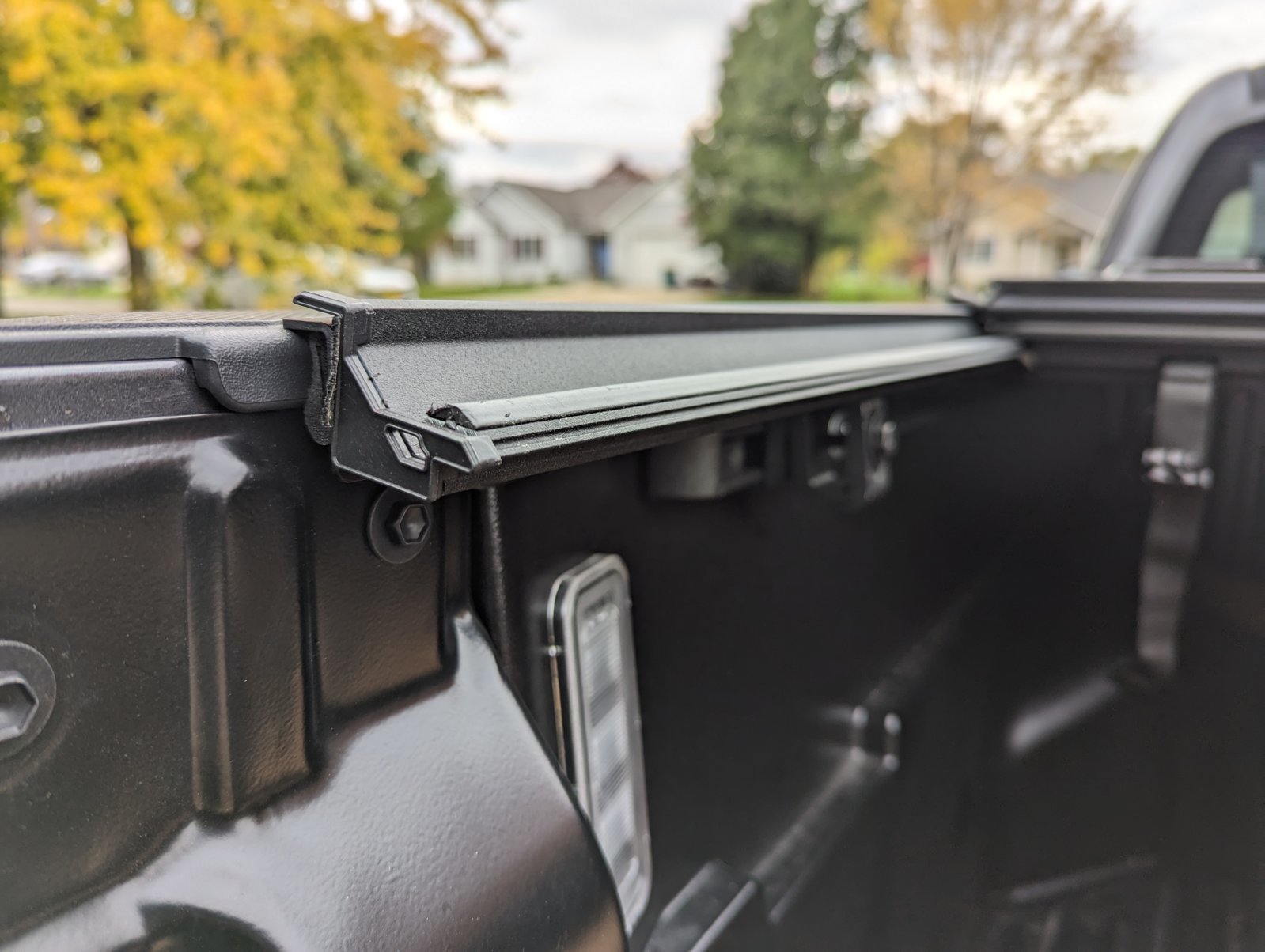

    On my kit, there were two rails per side, with neither fitting well and neither feeling solid. In the following picture, the rail on the left mounts to the truck and the rail on the right mounts to the RC rail. The rail on the left is not a good fit on the truck. The brackets that mount to the factory rail are a hair too short for a solid fit. The second rail uses those grabber clasps in the middle to mount to the rail you just installed and you have to try to get a snug fit while getting it level.
    Here it is installed. Notice how it angles down at the rear? That keeps the cover from locking into place because it pushes the rail down further. All bolts are snug and all pieces mounted correctly. But what's weird is, the right rail did not angle down and worked fine. My guess is that the 2nd rail was bent/twisted and no matter how hard I tried, it was not going to straighten out. There's also a fair bit of distance between the bracket holding it and where the cover snaps on.
    Another angle of the 3 rail system:

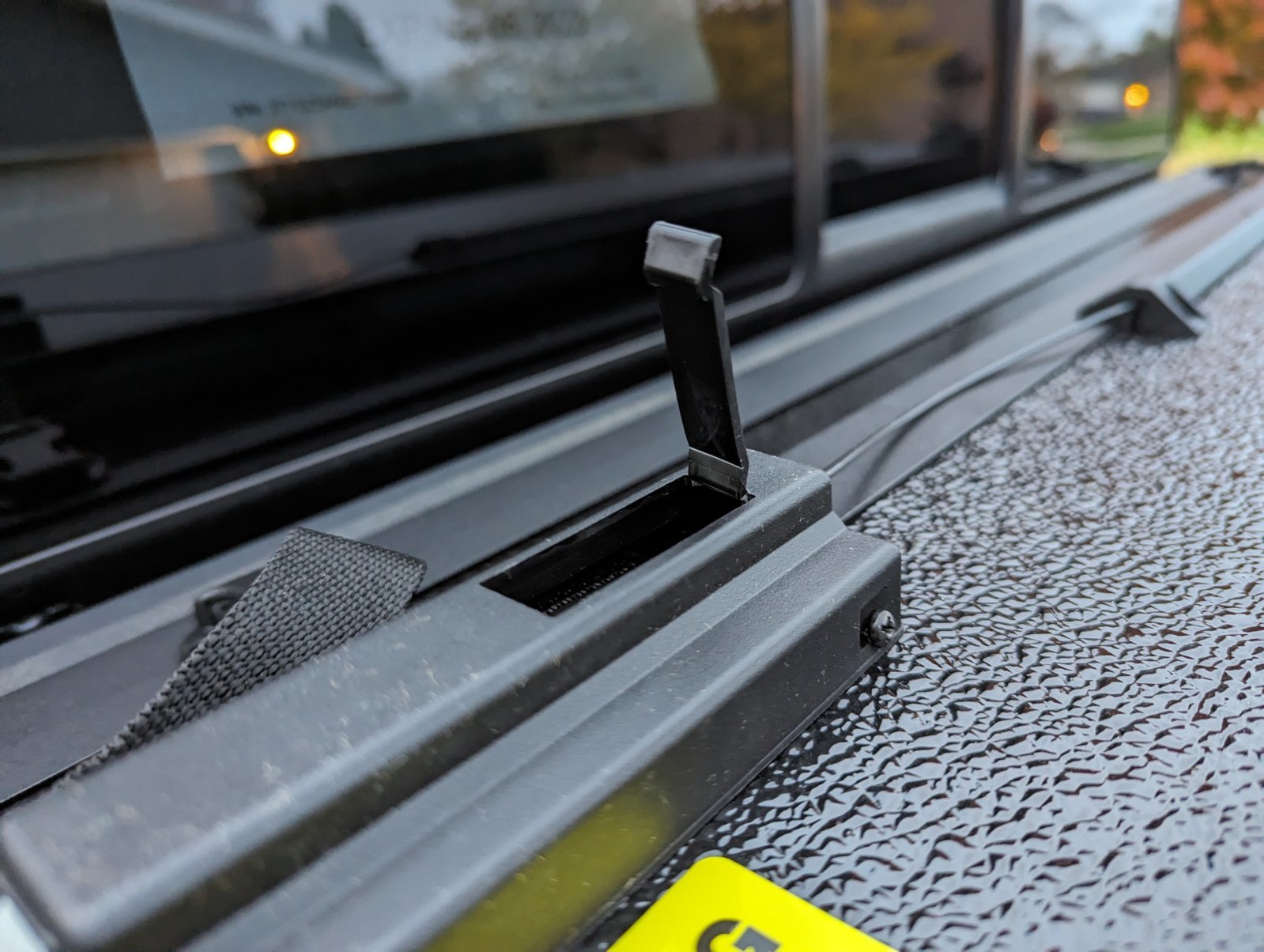

    Mine also was received damaged which makes returning it easy.
    I will say that their support is fantastic. When I first unboxed it (before installing it) I noticed the bent up plastic retainer. I called to see if they would send a replacement part. The answer they gave me was "I'll send you a new tonneau cover. You can swap covers, swap parts, whatever you need and just send back what you don't want." I'll gladly support RC in the future.
