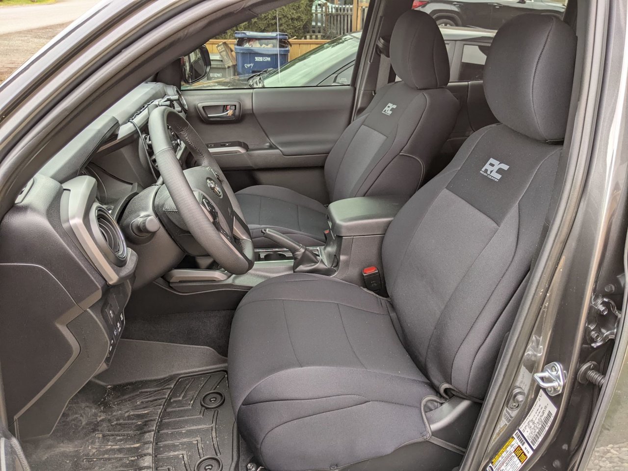

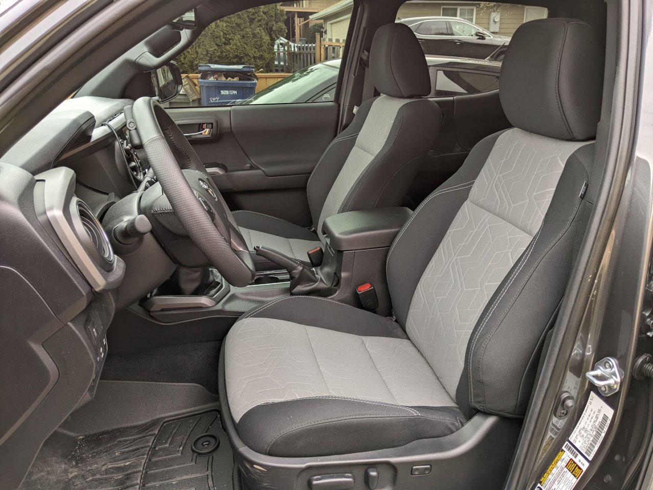

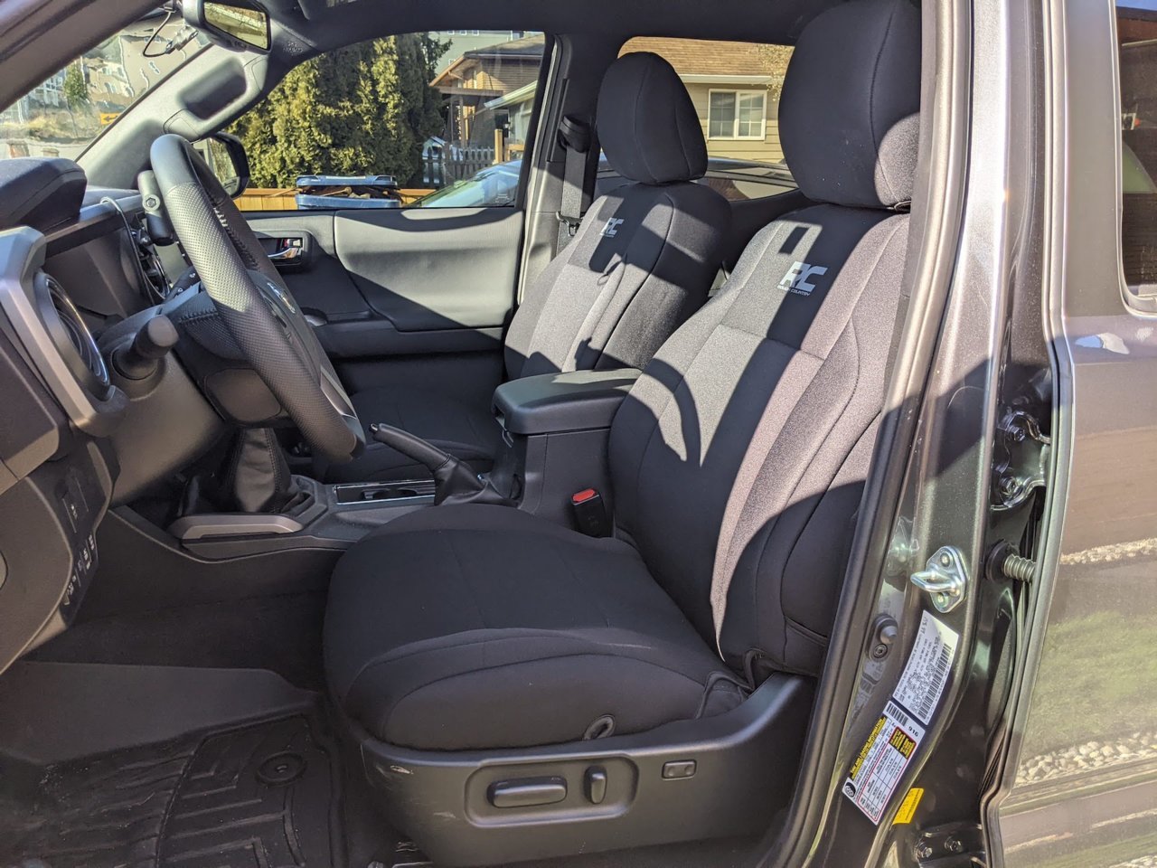

    Finally arrived after a couple of weeks delay. Not too bad for the price!

    Tuck the bottoms in behind that plastic. lol It can be done if you look through the older posts a guy posted pictures.

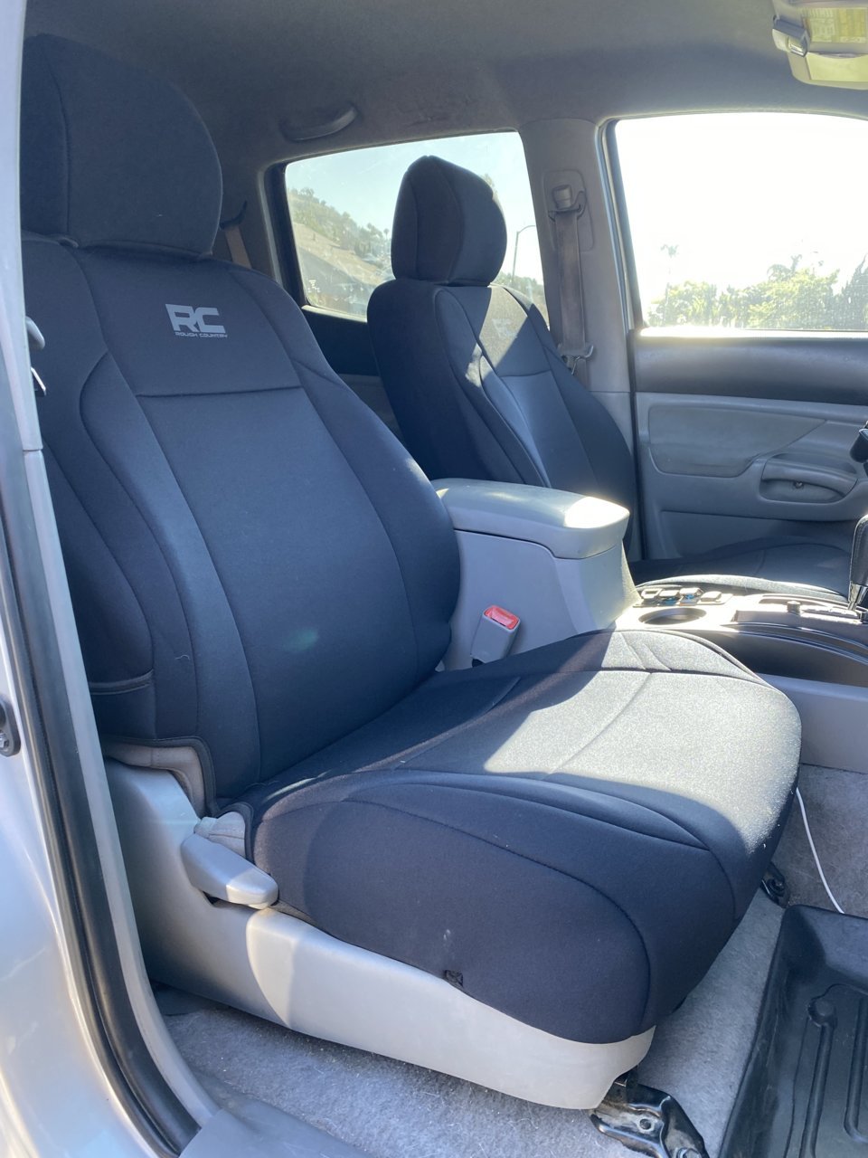

    Yes you can, that’s what I did. Absolutely love these covers and they are great with the dogs

    Oh damn, I tried doing that, but was having a hell of a time getting the straps and such through the seat and plastic trim.

    It is not easy. Takes a little time. A spatula or wooden spoon helps out allot. Also unbolt the seat and tilt it back so you will have room to work. I never unplugged any of the wires on the seat.

    And my lowly SR after the install. @era86 the wrinkles do disappear after 4 or 5 months.

    Hey, thanks for the help! It was a bitch, but I got it.. haha! I also had the covers reversed, the opening for the airbag was on the wrong side.

    Oh wow you did. I didn't notice it in the pictures until I went back and looked at them just now. I thought those headrest covers were a bitch to put on. lol

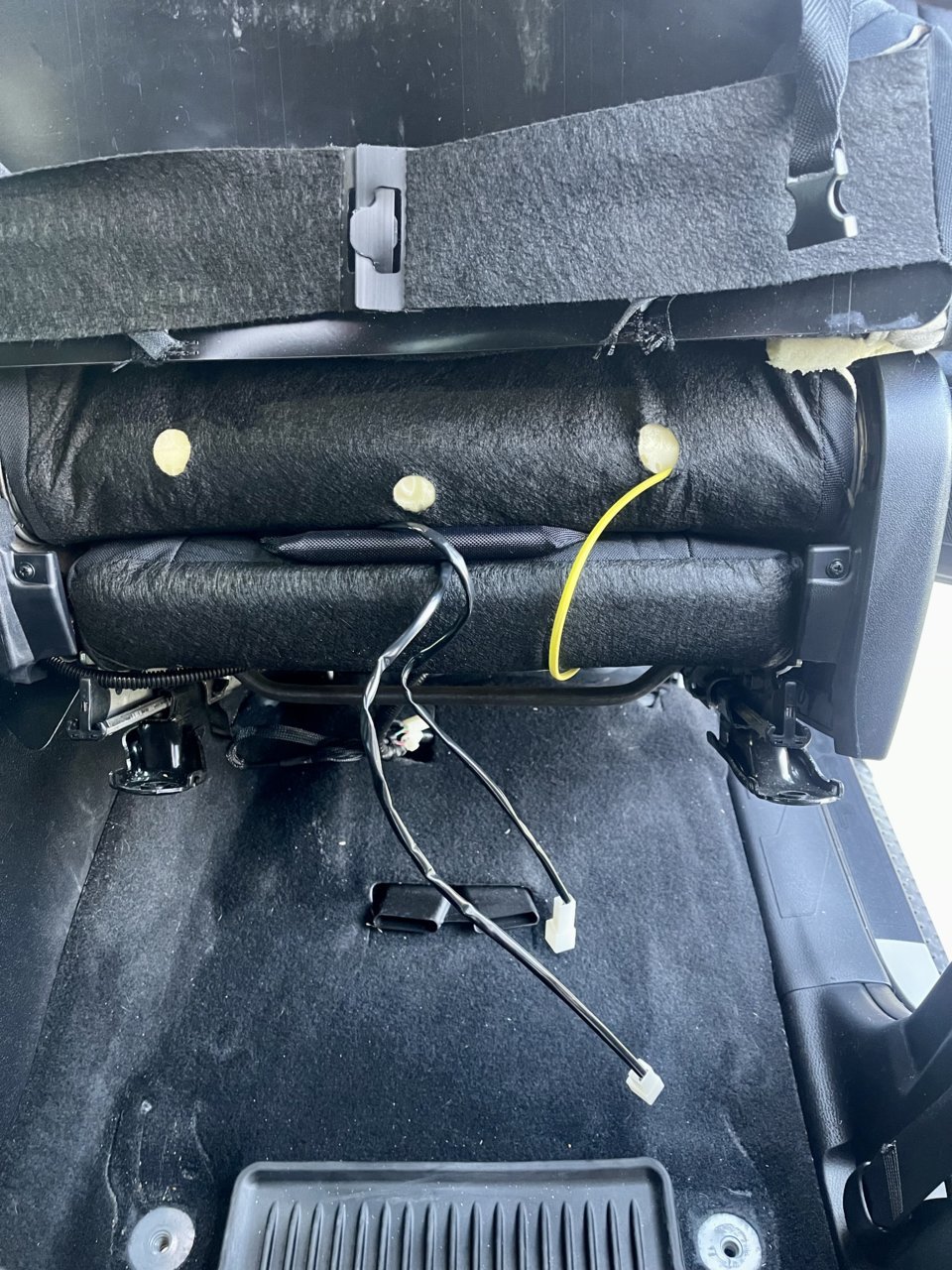

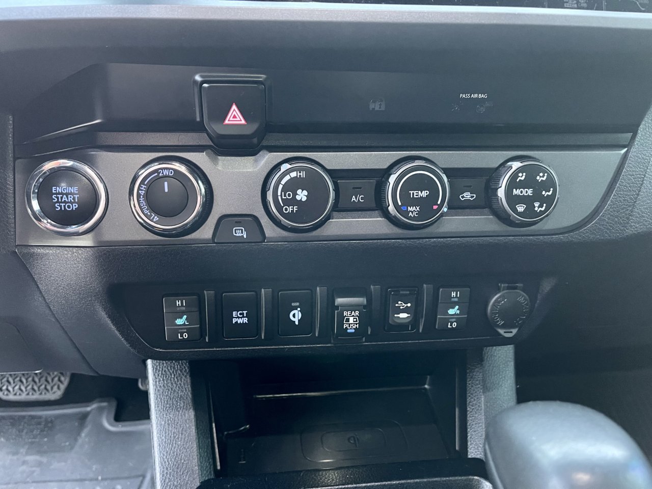

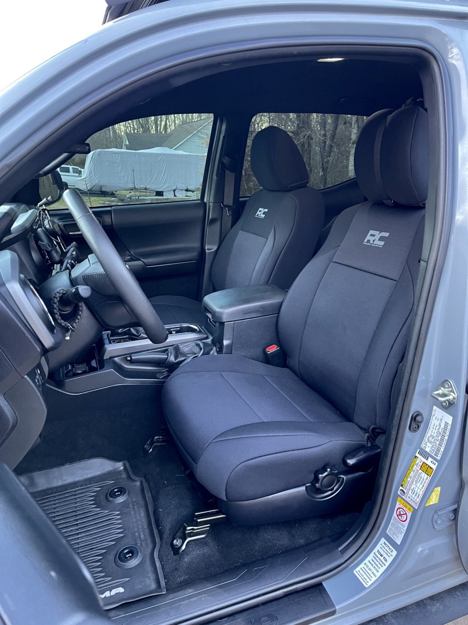

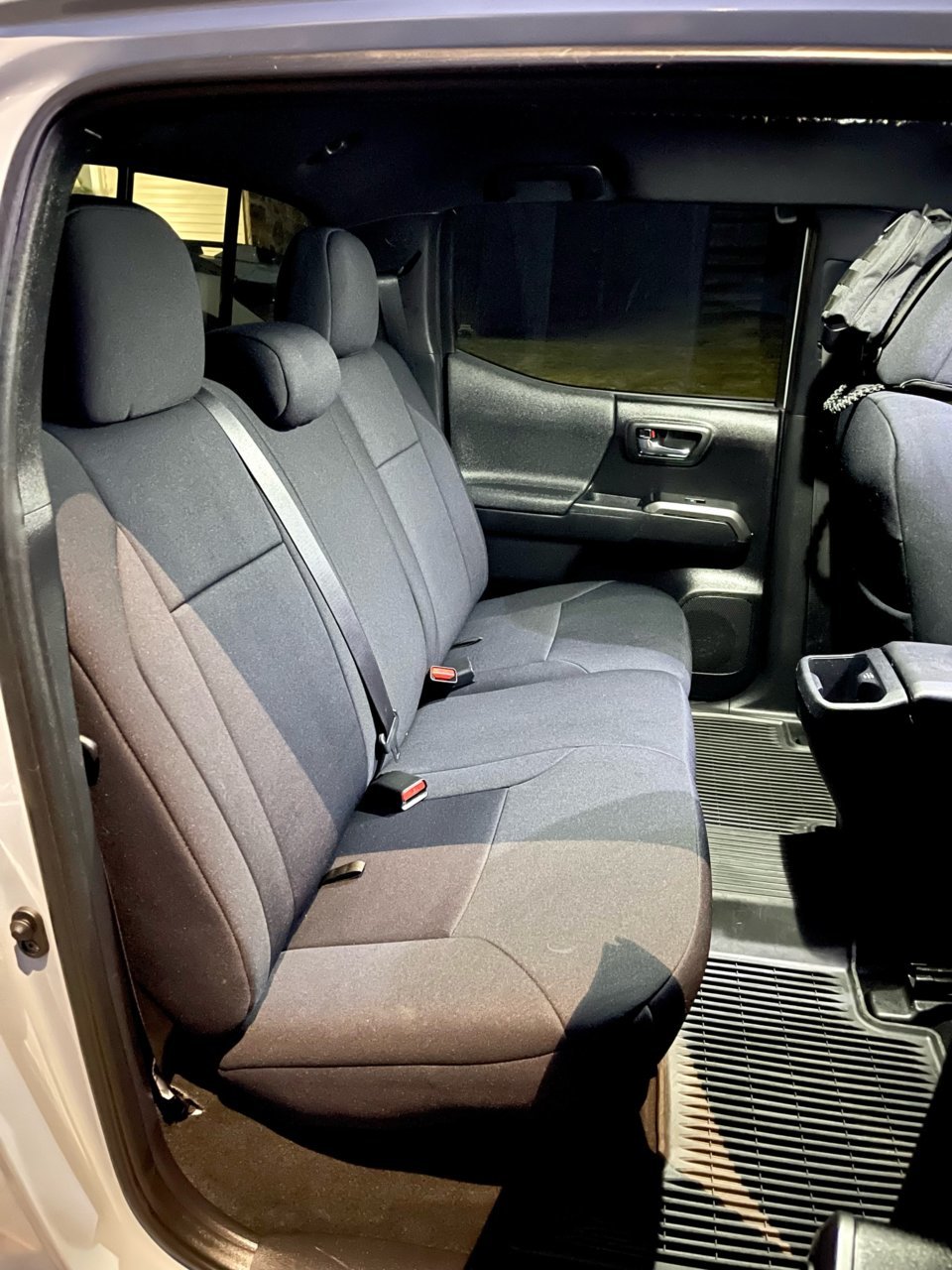

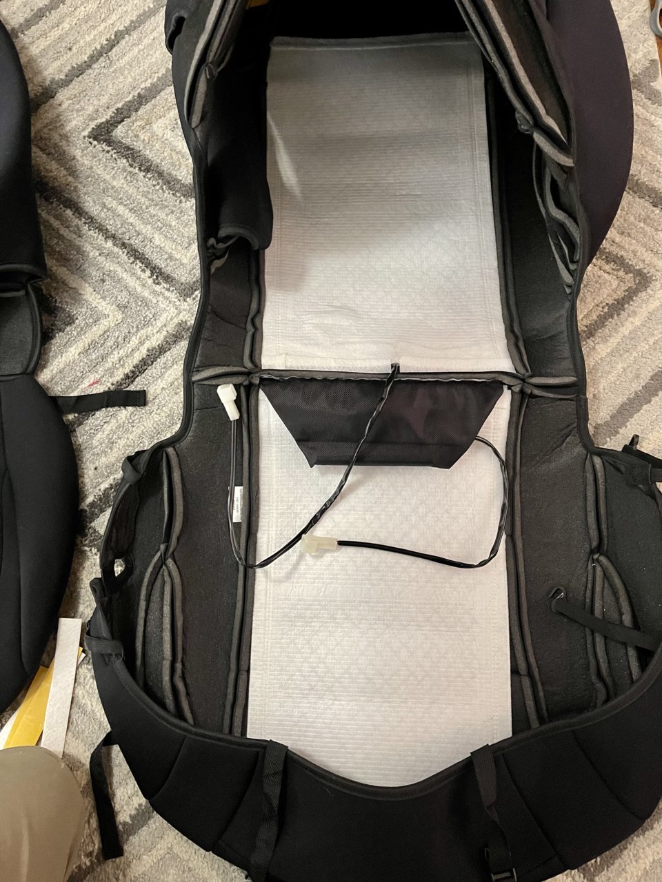

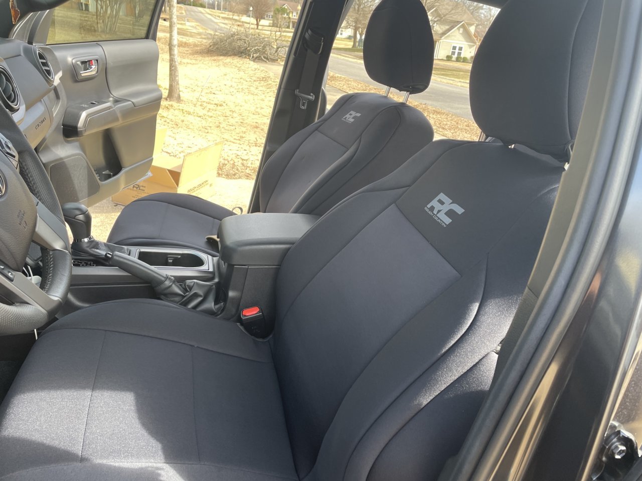

    I installed my seat covers a few days ago, and as most have said, they are kind of a pain to install. Very happy with the quality overall though and well worth the wait. They are definitely worth the price, just be sure and set aside a couple of hours and take your time to do it right. Unbolting the seats take less than a minute and makes everything so much easier.
    I also installed the Besond heated seat kit in the covers before I put them in the truck. The heated elements fit great in the seat covers between the sewn seams. I made sure all the edges are taped down with the included fabric tape so nothing can move around. There is a little space between the seat cover and the factory seat material, but I think over time as they get used they’ll form to the seats a little better. On high they work great and give a decent amount of heat through the thick neoprene. On low you can just feel the radiant heat and it's great for longer drives in the cold. Overall I am very happy with the install.

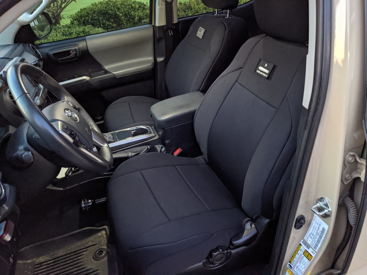

    Easy fix. I had Velcro sewn over the logo and just put patches on.

    Great idea. That looks cool!
