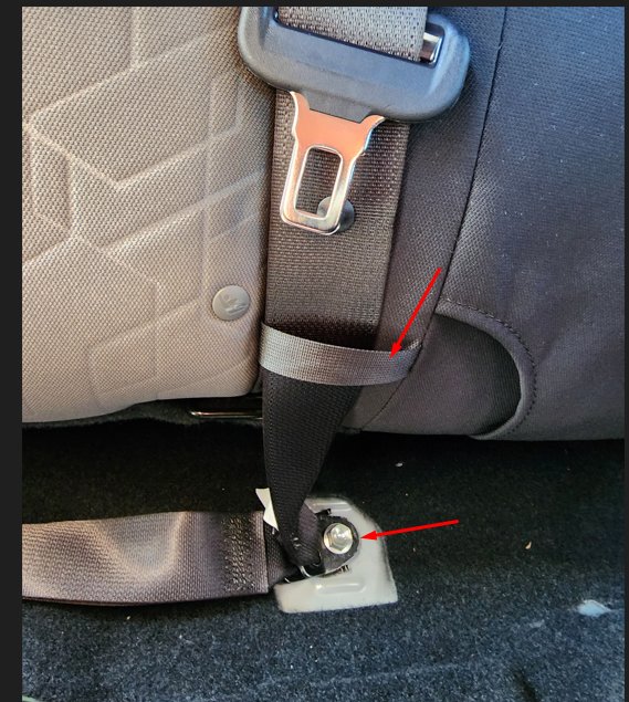

    The install video on extreme terrain never shows that step and he gets the covers on somehow.

    Yea...I watched it and it doesn't look like his truck had the loop.

    The video also didn't show him pushing the headrest hole openings down around the headrest plastic molding. I assume you are supposed to do that?
    I just undid the seatbelt bolt and fed it through the loop. Took a 14mm socket and about 2 minutes extra during the install. Torque spec is 31 ft-lb.
    Hardest part of the install was tucking extra fabric into the side of the power driver seat. As far as I can tell it all went perfectly. I just wish there was a way to remove the white RC logo on the front seats.

    Yea...that's what I did.

    And, yes, the rear belt needs to be removed for install of the rear covers. I avoided attaching the drawstraps to each other in the front and back to prevent undue stress on them.
