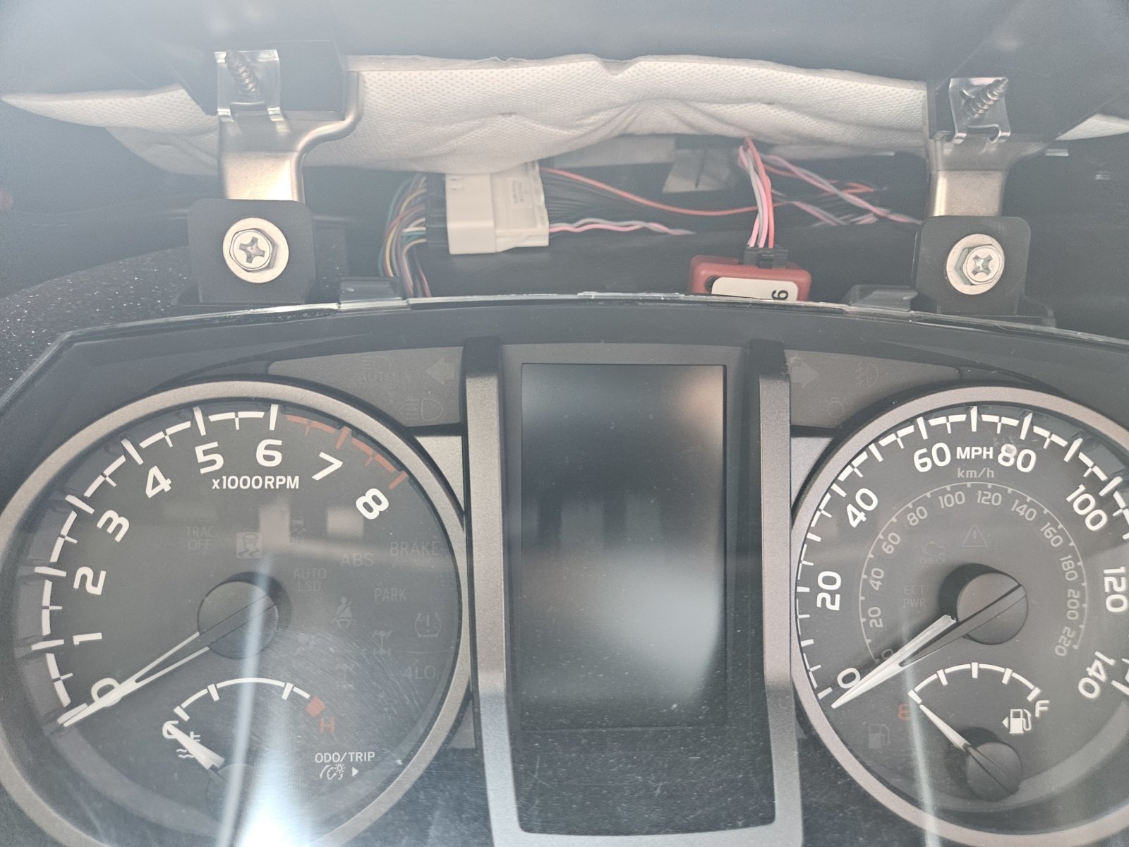

    Here's a pic, you'll notice the red module on the top right corner. I just pop the module out, disconnect it and reprogram.
