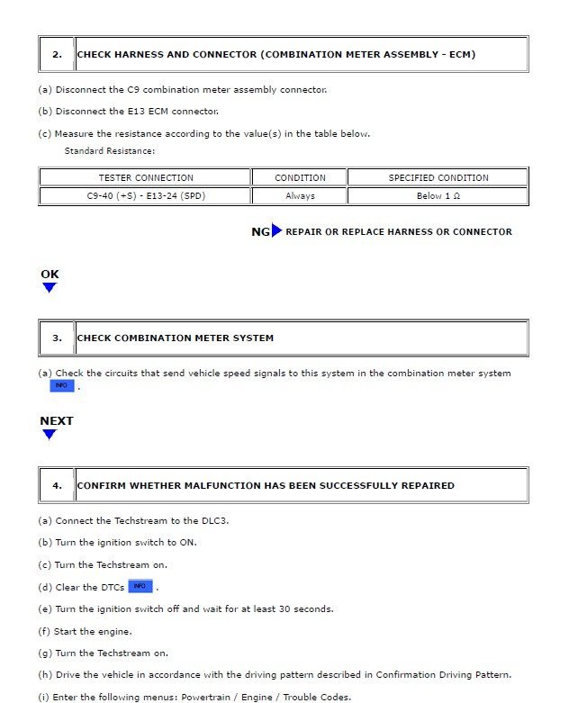

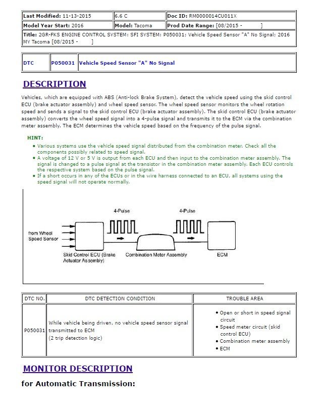

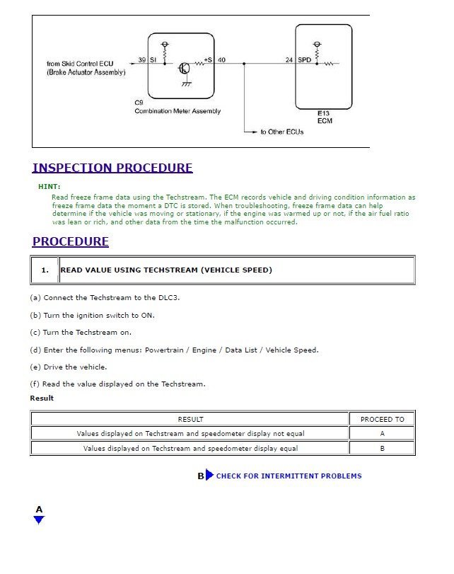

    Well guys, I can officially say that the ECU sees absolutely nothing from the cluster.
    This goes for the MPG meters also. Using the fuel consumption screen on techstream, the speed that it’s sensing is the same that the ecu is using. I need to verify the distance traveled though.

    I really don’t understand how the hypertech doesn’t fix it.
    I even looked at the individual wheel speeds.
    Each wheel was reading 38.7
    Vehicle speed 38.7
    Indicated (calibrated) & GPS speed 40
    Something isn’t right.
