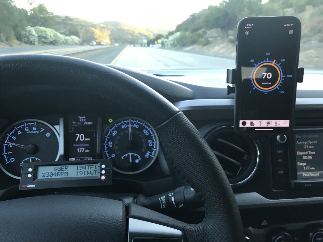

    So I just installed the rough country speedometer calibrator on my 2019 Tacoma and can confirm it does indeed work. In fact, those of you with 2019’s or even 2018’s with adaptive CC should update your modules. It’s displaying the correct Set MPH where it displays the ACC Mph tiny up above the actual mph. When setting your tire size there is also now an option to select 2019/2020 Tacoma.
    I left my usb cable attached after I mounted it so I could reprogram and was glad I did. First program I set stock tire size to my stock size that came with the truck 245/75/16 (sr5) and 32.9 for my new tires. Mph was slightly higher than gps mph. I re calibrated and entered 265/70/17 as stock size and 32.9 for new size and it’s now dead on! Super happy now!
