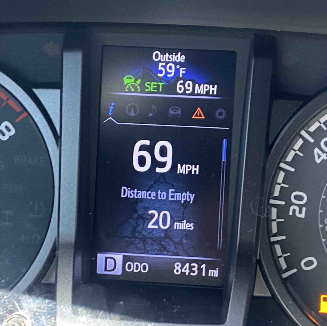

    Just installed this on my 2021 OR. The software does have 2022 as an option in case you were wondering. There is also a "GPS" option, but I just plugged in my current tire size (285/70/17 KO2) and took the truck for a test drive.
    Before the install, truck was indicating 3-4MPH slower than GPS. It's almost completely accurate now. I'm getting matching numbers on GPS and dash 99.5% of the time. There were a few times where the truck read faster by 1mph for a brief moment, but GPS data does fluctuate and tire wear has to be considered. Tweaking the tire size numbers by a few points will probably make it even more accurate. I'll report back with what I find.
    Extras: It actually fixed my cruise control numbers (see pic). And I'm pretty sure my shift points have been affected. I'll have to do a longer drive, but initial impression is that this is no placebo. The truck wasn't holding on to gears and shifting when it was supposed to. Very happy with the purchase so far.
