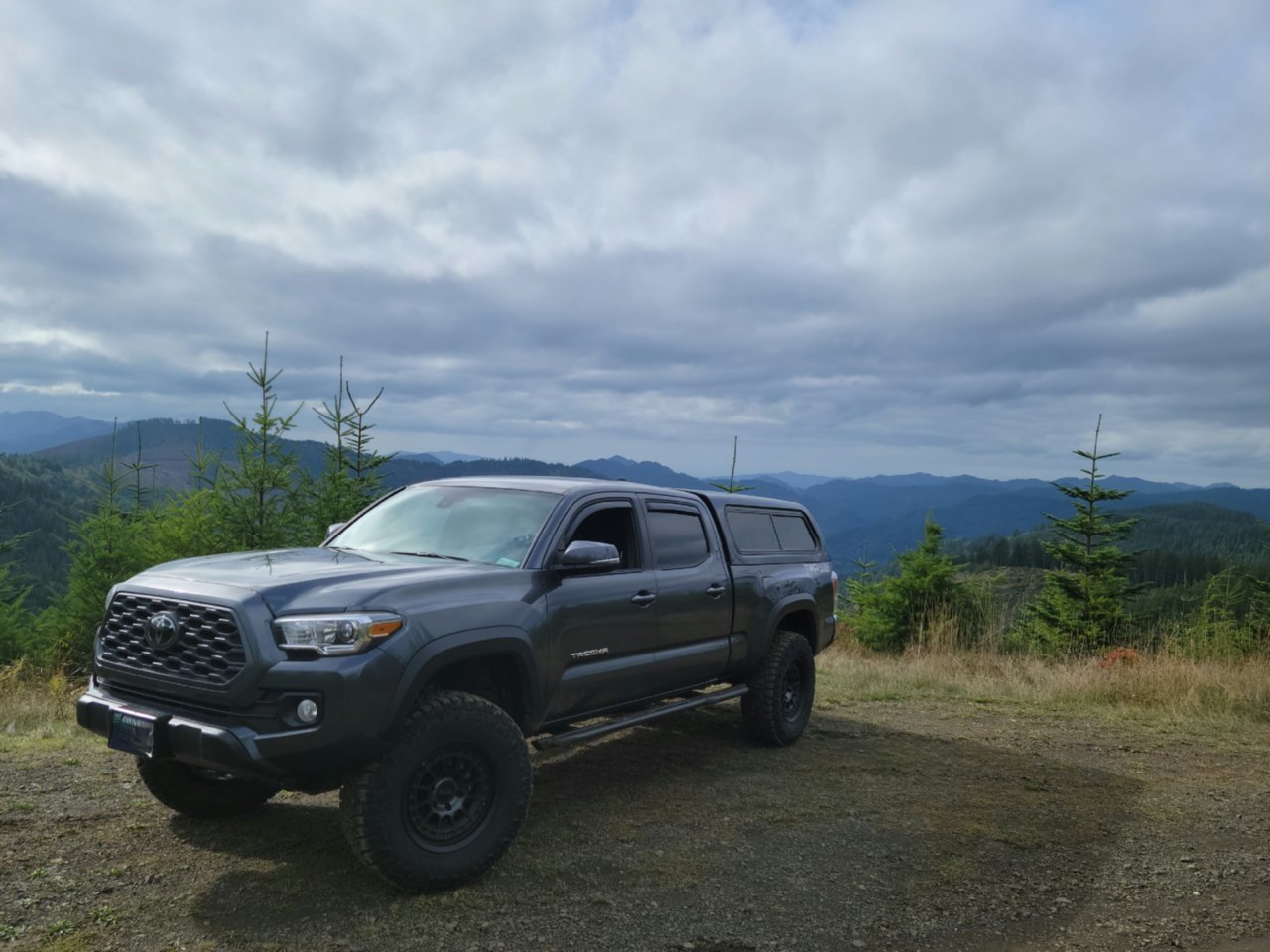

    Been gone awhile as summer picked up with adventures after I installed my 3.5" setup. Here's a brief rundown of how I put it together.
    3.5" Vertex Front/Rear
    SPC UCAs
    Icon AAL
    17" KMC Canyons
    285/70r17 Cooper Rugged Trek (True 33s & they did rub)
    Been running this kit HARD since install. Trails 2 weekends a month, 3 trips to the dunes, a few 500+ mile trips, and a road trip to Montana to run Blacktail Wild Bill's. This kit has performed light years better than I expected it to. The only thing that gets in the way of my fun is the wheelbase of the long bed.
    I have 2 issues I have encountered.
    I need full leafs because the Icon AAL just isn't enough to support the Leer cap and the load, I'm already seeing sag. I've ordered a set from Oregon Spring that's comparable to the Deavers. Hindsight I should've gone full leafs from the beginning.
    The other issue I encountered was busting the sway bar link on the passenger side. During my run of Blacktail Wild Bill I snapped my sway bar end link on the first obstacle, which shredded my CV boot. (And yes, I did install the swaybar spacer.) I disconnected the sway bar and put it out of the way to finish the rest of the trail. Luckily CV axles are a dime a dozen so I scored a replacement from Oreillys with my account for like $68.
    If you plan on offroading, I highly recommend removing the sway bar entirely. I ripped mine out when I replaced the CV. With how well the coilovers handle i don't notice much of a difference with it gone.

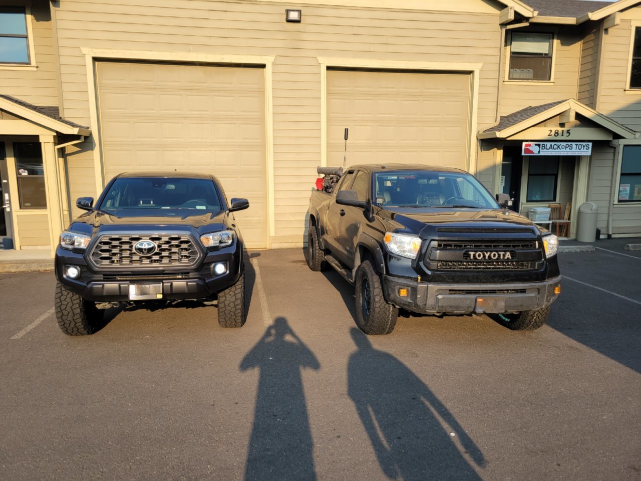

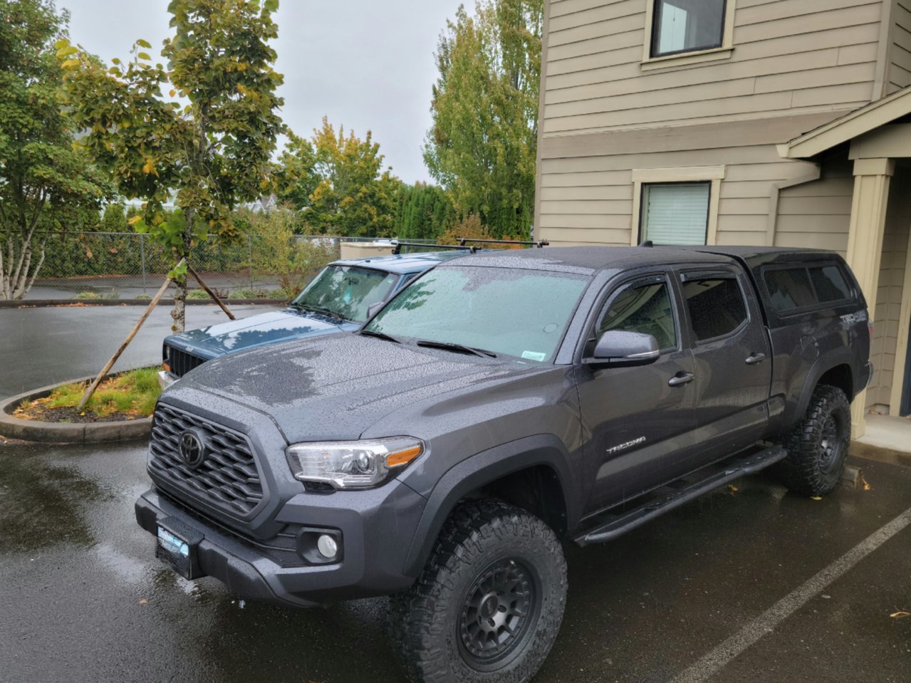

    I'm horrible when it comes to taking photos but here's a couple.
    Still waiting on getting my Road Armor bumper installed. It takes two sets of pods, a 20" lightbar AND I'll need a switch controller.
    Next to my buddy's Tundra with a 3" lift on 35s and one from a recent outing20210805_184200.jpg 20211016_140911.jpg
